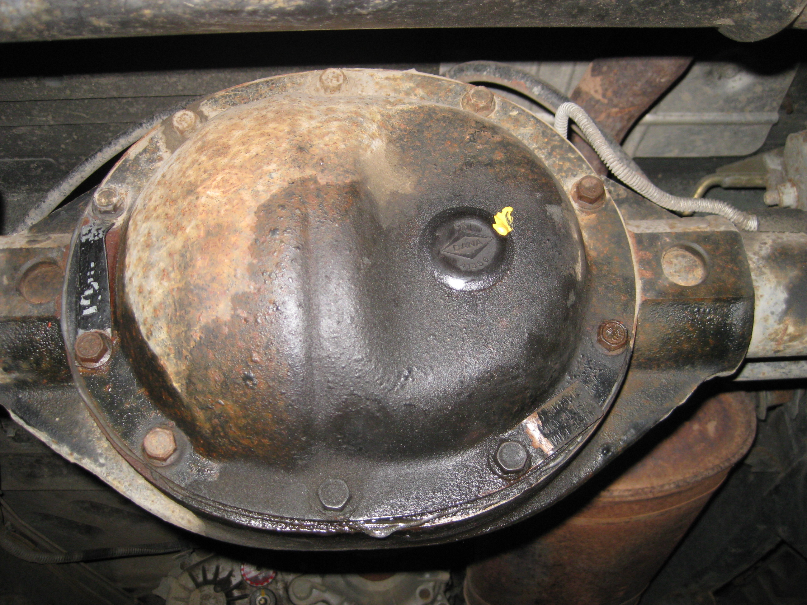

Look at your differential cover. There should be a metal tag attached to one of the differential cover bolts. The possible ratios are 3.07, 3.55, 4.10 .

3.73 maybe? There was one tag that talked about the fluid i should use, the other had a list of numbers that looked like this:
111929AB
3 735993
didn't see anything between the 3 & the 7 on the second line.
Here is a picture of my rear diff. Just took it, just for you!

You have a 3.73...
Is 3.73 rare? Is that why it wasn't in the original possibilities? or did you just not think of it? I promise I'm not trying to point out faults, or cause problems. :redface:
To sum up what I have: 3.73 ratio. Inline 6. Manual transmission. 31" tires. No lift that I know of.
