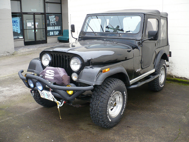

I mounted up a Smittybilt SRC and a Superwinch 9.0 EPi on 'BB', my '78 and save for a couple of extra holes to drill in the bumper to match up it was a breeze.
