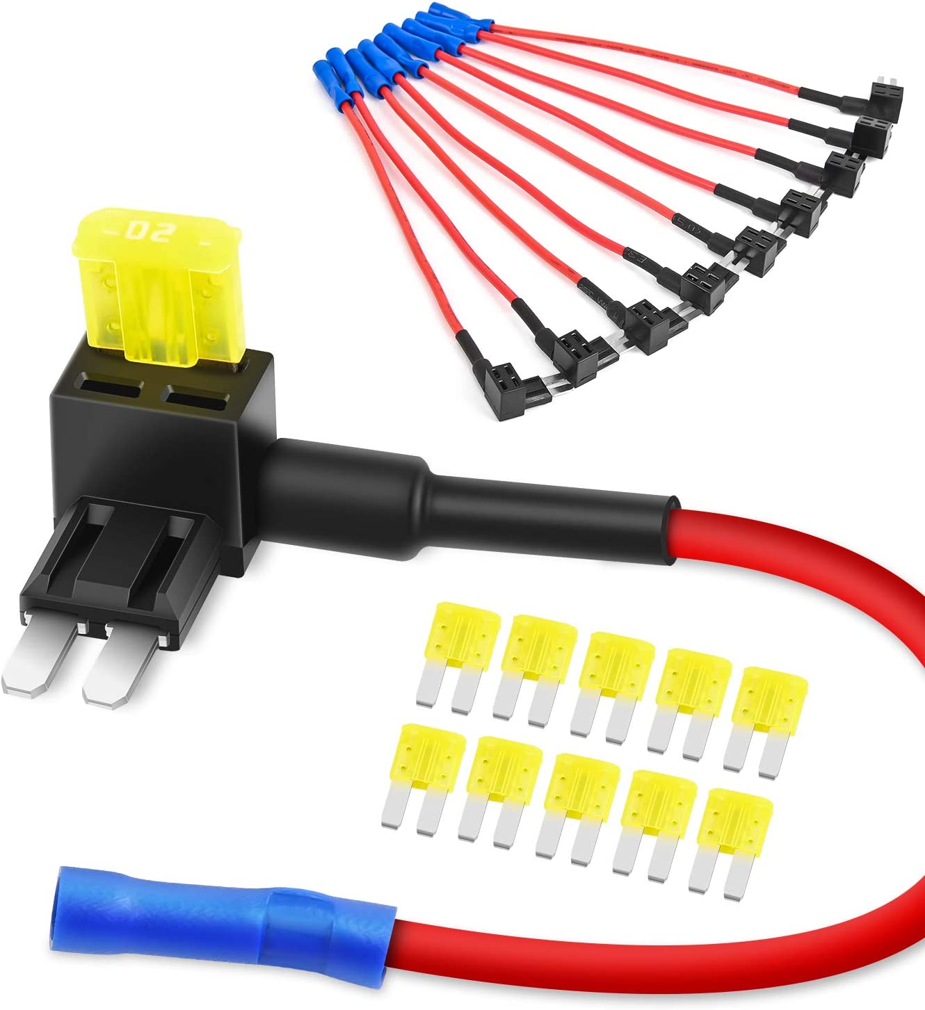

I like these fuse block taps:
Fuse block taps on Amazon
From there you can plug into the headlights in your fuse block, or whatever circuit you want.

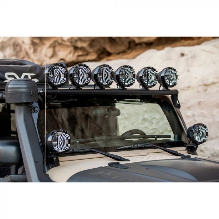

How many Watts are all the lights?
Light bar can be setup a few different ways.
First use a relay to control the voltage to them. The signal to the relay should be on a ignition power. So key off lights off.
I recommend an inline fuse from the power-bus on the fusebox under the hood for the lights. The signal to the relay through a switch taped using what Terry shows off a ign power.
Be sure proper gauge wire for power and ground to the lights.
PS KC hilites sells a nice wiring set for lights.

By light bar I was thinking this:

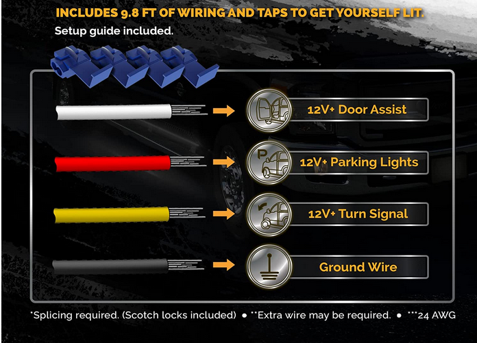

... so now you understand my dilemma. I'm sure I could poke around and test each wire but was hoping someone had a wiring diagram showing color codes.

This is a sidestep light strip that acts as a courtesy/turn/running light... so needs to be tapped into the lighting for all of that stuff. :)

No relay should be needed as it gets power from each circuit, hence why I have to dive into the wires. I found a schematic and will tinker with it more on a warm day.

Is this from the packaging of what you have?
