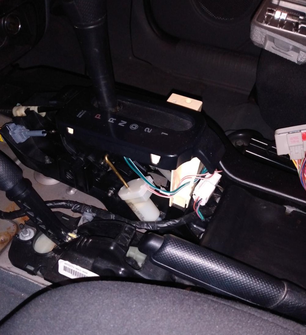

Thought I'd give an update on my Liberty that was locked in park. After driving around town for about 5 weeks using a "L" shaped piece of round bar stock to shift the transmission by pulling & pushing on the cable that goes to the transmission (after popping the cable off the shifter console pin), I finally got tired of it and ended up removing the entire console to reveal the plastic solenoid on the left side of the shifter to see if that was the culprit. Turns out that the solenoid was stuck in the fully extended position & wouldn't release to allow the shifter to unlock out of park. At 1st I thought it was mechanically stuck in the extended position but realized later that it was most likely electrically locked that way. I noticed that when locked in the extended position, it is electrically locked that way & when released, it becomes de-energized, so something in the electrical system that feeds that item was not getting the signal to release it.
Didn't do anything to it except put a small amount of WD40 in the shaft hole and it's been working fine since, but really don't think that was the fix. Still haven't been able to figure out why it ended up that way & it only happened after lifting the front end of the vehicle to do a front wheel brake job. It was either a coincidence or something was triggered during the brake job to cause it to happen.

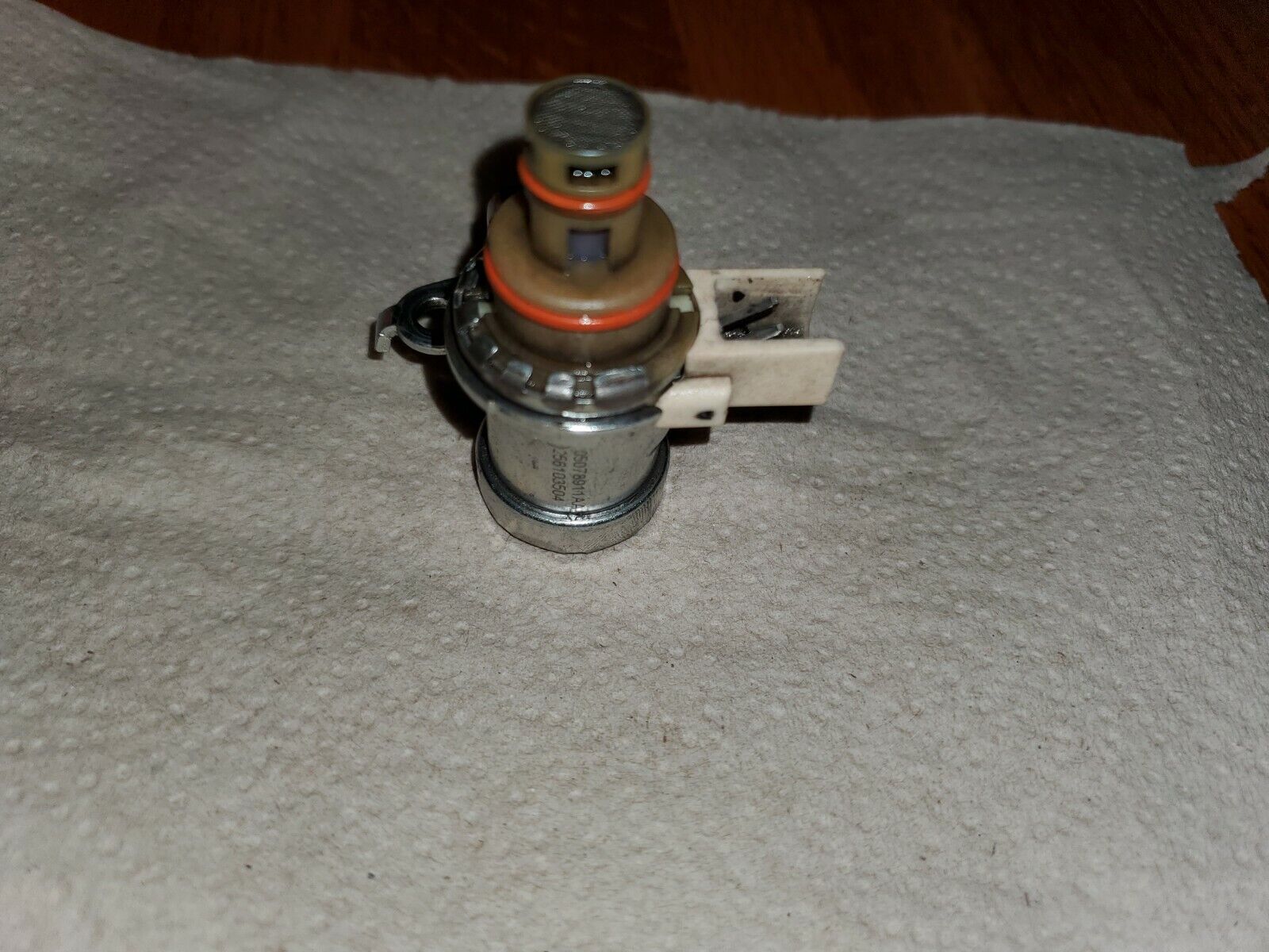

Is this what you are referring to:
Mopar Transmission Variable Force Solenoid Sensor For42RLE Automatic Transmissio | eBay
This is off a 2012 Liberty with a 42RLE transmission, so it may not be the same part that you're referring to
What your pic shows is probably the shift solenoid that goes on the transmission (from what I understand). The item I'm referring to is a cheap looking white plastic solenoid (they call a motor) that is mounted on the left side of the shifter module inside the console in the vehicle. From the posted pic you can clearly see it just to the left of the shifter module.
