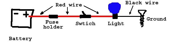

Start at the battery, run a wire to a fuse...
From the fuse to the switch...
From the switch to the lights...
From the lights to ground...
Enjoy

Step by step...
go to autozone (or similar) and buy:
-14 gauge red wire (20 feet is way more than enough)
-14 gauge black wire (3 feet should easily do it)
-fuse holder with fuse (whatever size the device suggests)
-assorted connecters (ring terminals, spade connectors, etc.)
-wire ties/tape
-switch
-any tools you might not yet have
Disconnect the negative battery terminal
Connect red wire to the positive battery terminal
One to two feet from the battery, cut the red wire and hook it to one side of the fuse holder. This should be place where you can secure it to something so it doesn't flop around
Connect loose red wire to the other side of the fuse holder
Run loose red wire from the fuse holder into the cab
Decide where you want to put a switch
Mount it
Cut red wire off when it reaches the switch and hook it to the "12v" terminal
Hook loose red wire to the other terminal of the switch
Run loose red wire to LED lights
Hook red wire to "12v" on LED lights
Run black wire from "ground" on LED lights to any chassis ground (usually any screw that goes into the body)
Connect the negative battery terminal
Make sure the fuse is in the holder
Turn on the switch
If the lights do not come on, go through the directions again.

Click to get the picture below...
