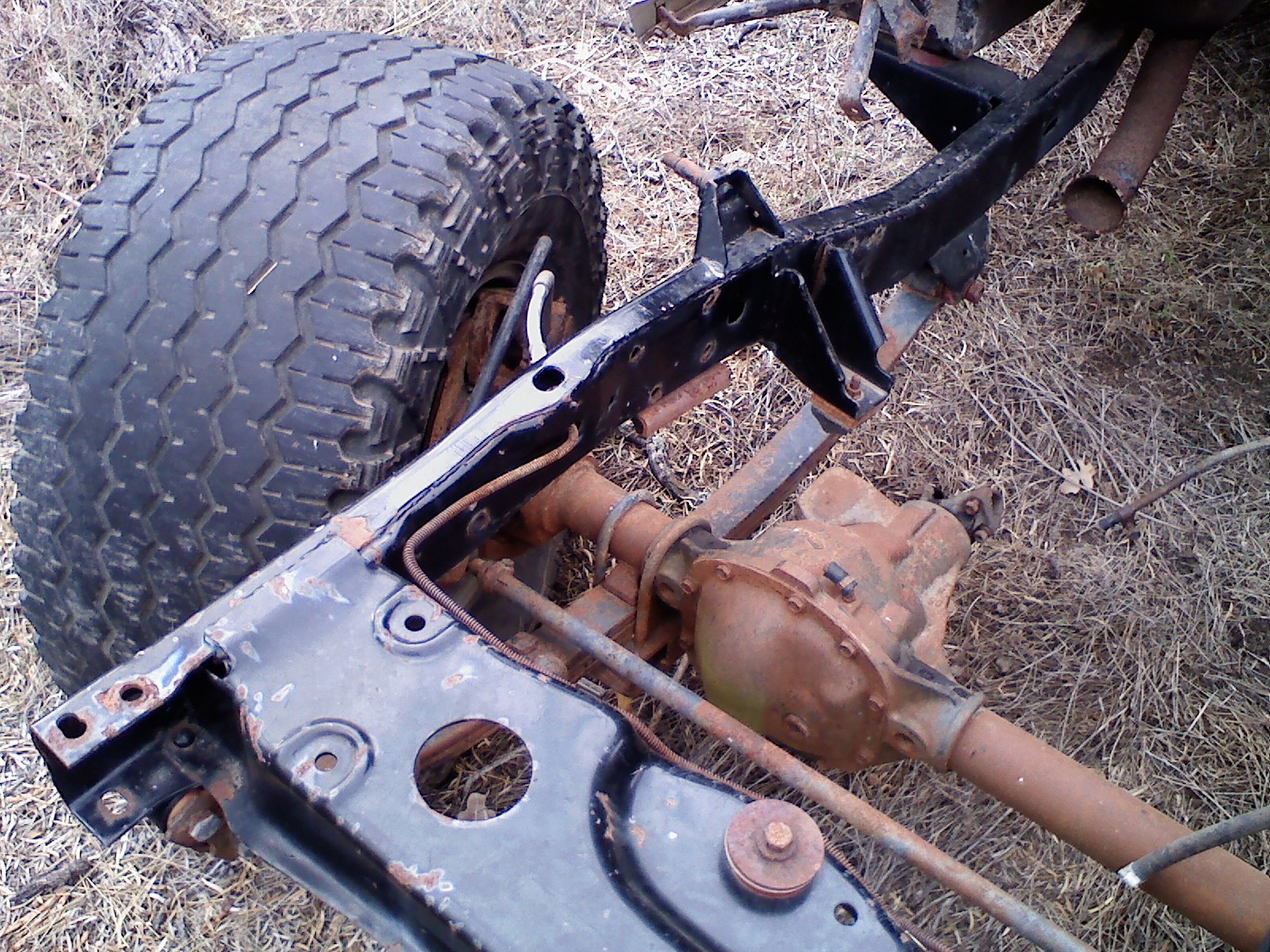

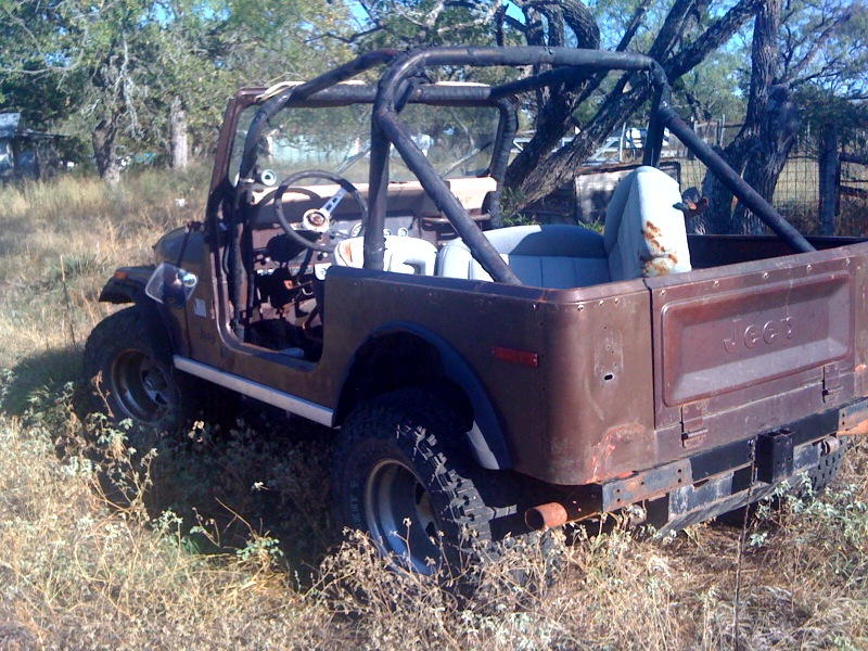

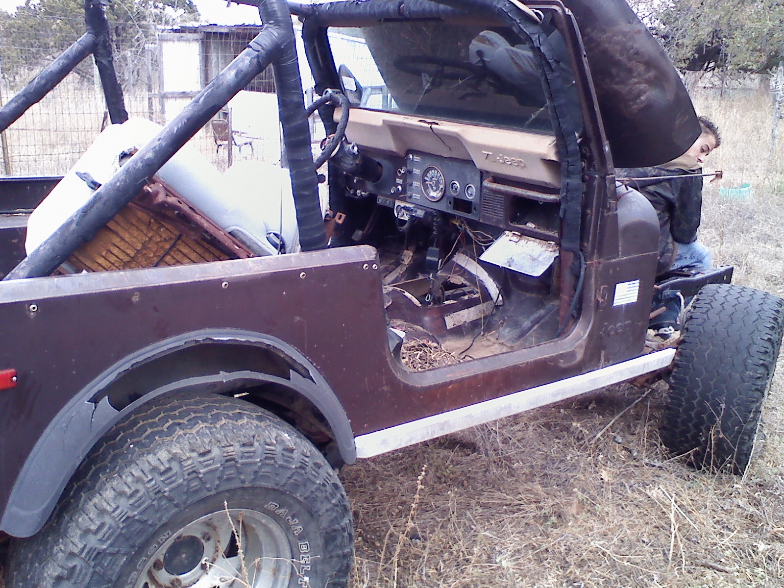

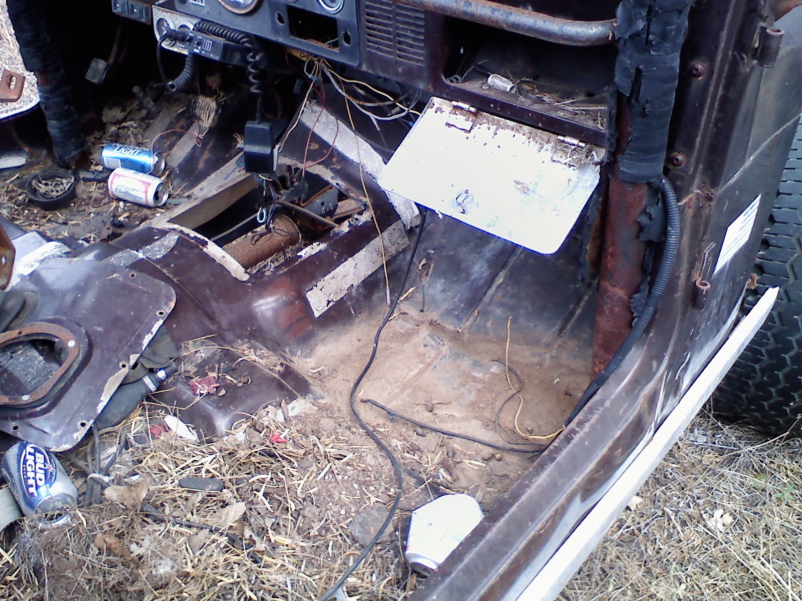

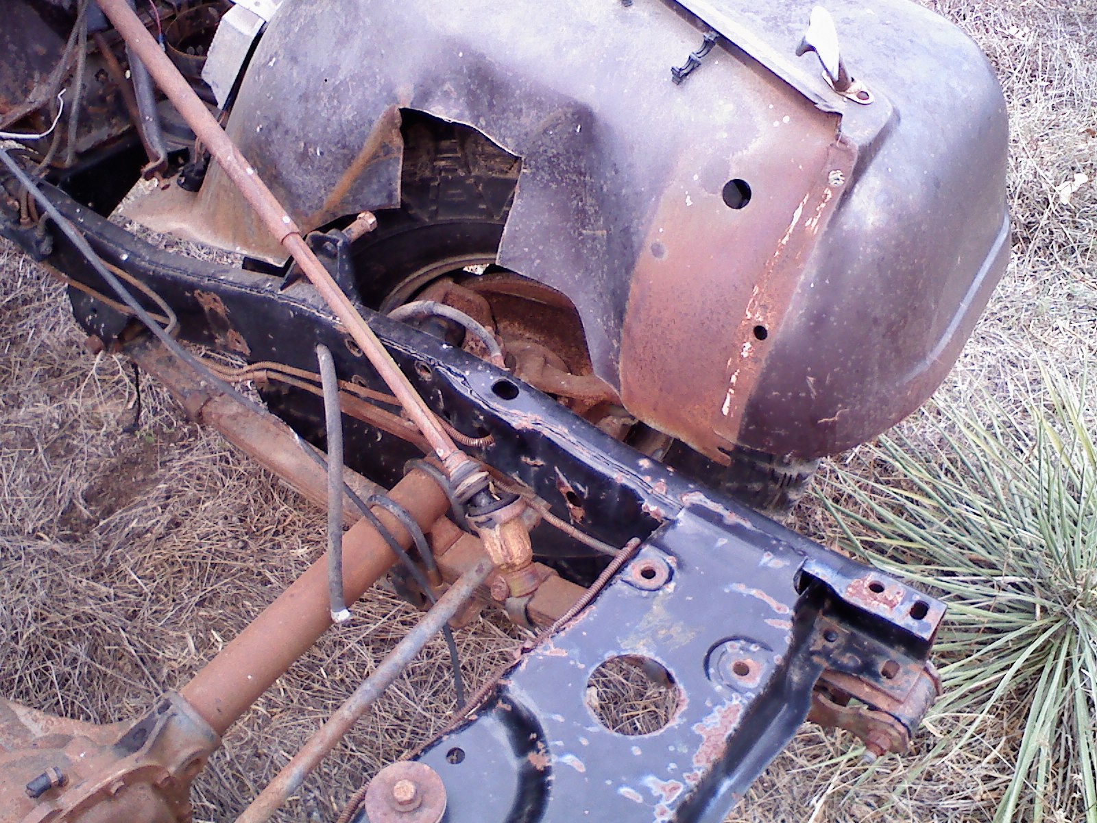

Ok so I went to look at it today and here are some pics I took.
The frame is actually in really good shape. The tub isn't all that bad except the normal areas of the floor boards that usually show issues. The winshield would need to be replaced along with both front fendors. The front clip is gone also.
He doesn't have a title either.... anyone have any luck getting a new one in a situation like this. The guy said something like a "builders" title would only be $100.
Basically I would be buying the frame and hoping to re-use the tub and the axles, hood, ect and buying the rest new. He said it used to have a 350 in it but I'm not familiar enough with the engine mounting to know what was altered, ect. I plan to put a 350 in it if I buy it.

I think it looks like a good, big project. If you look at it again, try tapping the frame with something metallic. I may look fine, but the paint may be hiding something. My CJ7 frame was undercoated at some point and there were still weak spots. To give you and idea, I got two of my body mounts off with a sledge. I'm guessing that shouldn't have happened.
Also, getting to know that Jeep would help a TON. Like finding popular engine, transmission, and t-case swaps, axle ratios, axle hubs, brake sizes... I didn't regard this stuff when I bought mine and now I feel the pain. Of course that pain turns into knowledge. Good luck!
