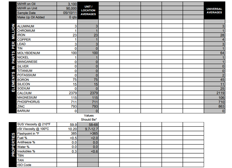

Good post also Terry, I've seen 'em send samples out at work but never thought of sending 'em some Jeep oil. Just curious what brand filter do you use? I ask because it could have affected the results. Also they would be a good test bed to compair filters. Did they send you PPM graph or anything showing how much dirt was in your oil?
I use Mobil1 filters as well. They do include more information, but most of it's over my head:
Good to see that oil has moly in it and zinc but I wouldn't know if it was a large portion or not. It'd be nice to have samples from other oils so you could compair 'em. I thought they took zinc out of the SM rated oils due to it being hard on cat converters as the engine got older and started to burn oil?
