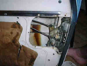

Step 3
Having removed the door fabric you will need to remove the metal plate with several screws to get access to the door lock components

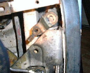

Step 4
Once you have everything off, you need to find the bar that connects the lock to the latch assembly

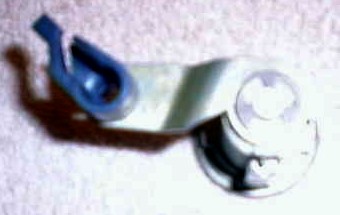

Step 7
Once you have the lock out you need to remove the C-clamp on the top that holds on the door hardware

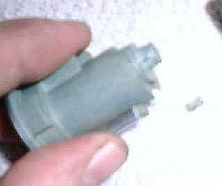

Step 8
You will need to use pliers and break off the little piece of metal on the new lock (remember, this is a Ford lock). This should allow you to put the small door clip back on the lock, with the C-clip, then place it back in the door.
