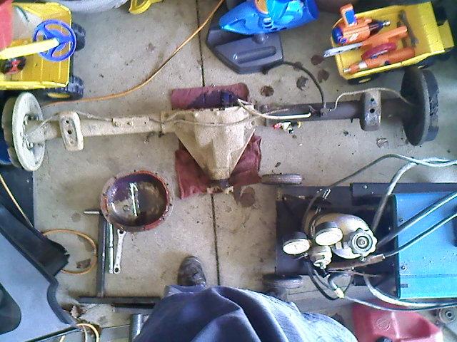

ok i found this on craigslist and i was wondering if anyone could give me some info click this link and it will bring up his post Locked Dana 35
It is a dana 35 with locker and 4:10 gears i talked to the guy and he said It will need brake shoes, and maybe new axle seals is all and he has one extra shaft for it also i was just wondering if anyone could give me some input on the brand of locker and if i can talk him down to $300 if it is a good deal i have some pics that he sent me too let me know what ya think

Looks to me like a lock-right or some other drop-in locker that uses the stock carrier.
You can probably find a cheaper axle at a junkyard; 30 is not unheard of, and the 4.10's came stock on the 2.5L, so they are not terribly hard to find (having said that, there were no wranglers to be found in the junkyards in Miami). Also, the D35 in stock form does not like lockers very much... You may as well take the chance and upgrade to a Ford 8.8, which you can find with Limited Slip, 4.10 gears and rear disc brakes for under $300 at a junk yard. Look for the mid 90's explorers.
Heres a little more info on the locker i found out that it is a lunch box locker if anyone knows anything about these please let me know i have never heard of them
Lunchbox locker is more of a slang term used to describe a locker that is easily installed by replacing the spider gears with the locker unit. Some brands are Aussie, Lockright, EZlocker, etc.
I think it's worth about $300, not much more. That axle is only slightly stronger than its c-clip variant found in later model jeeps.
