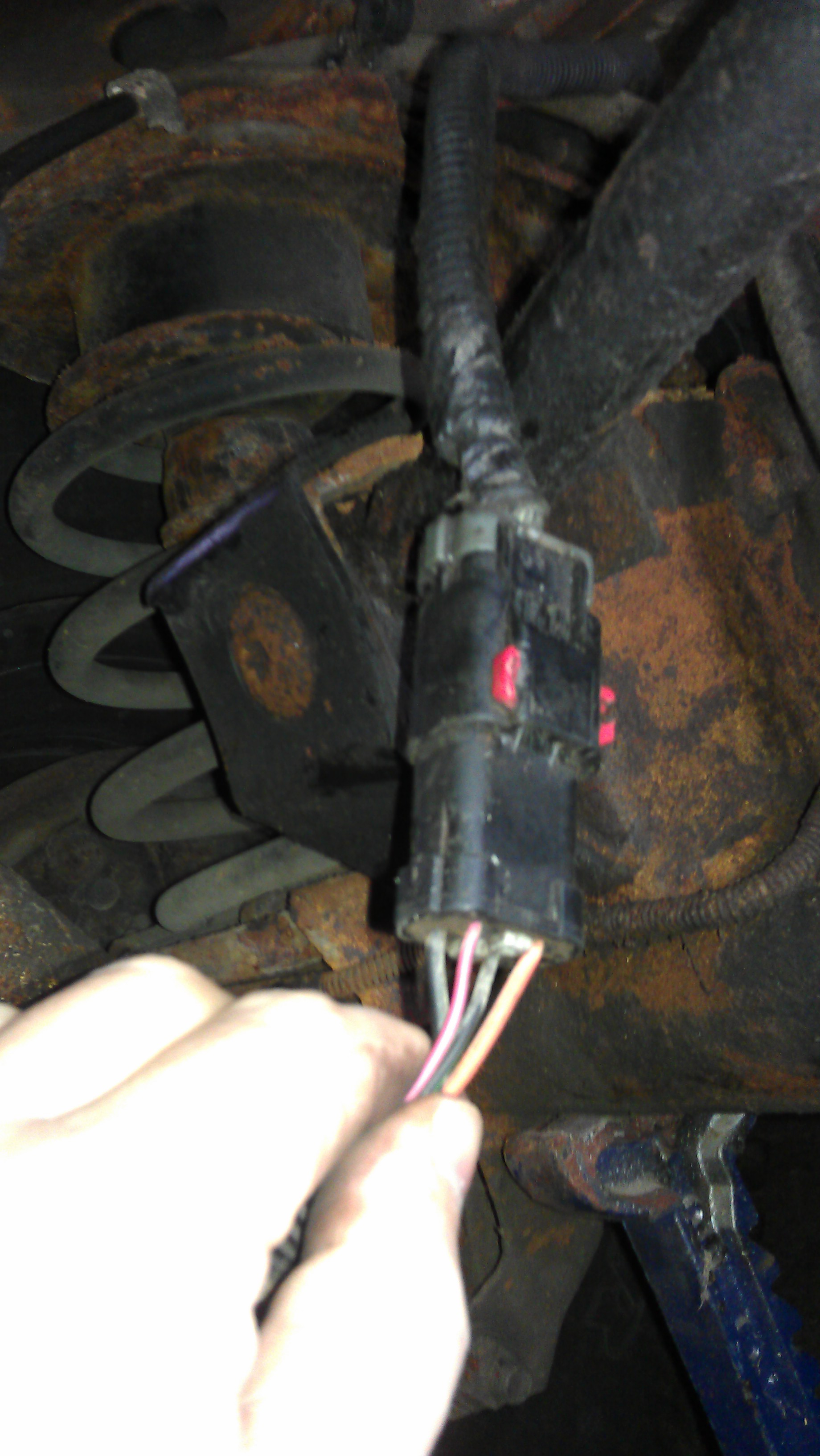

1) I cannot figure out how to disconnect the fuel pump wiring clip. Please tell me the secret. I hate electrical connectors. I can never figure them out. (first picture)

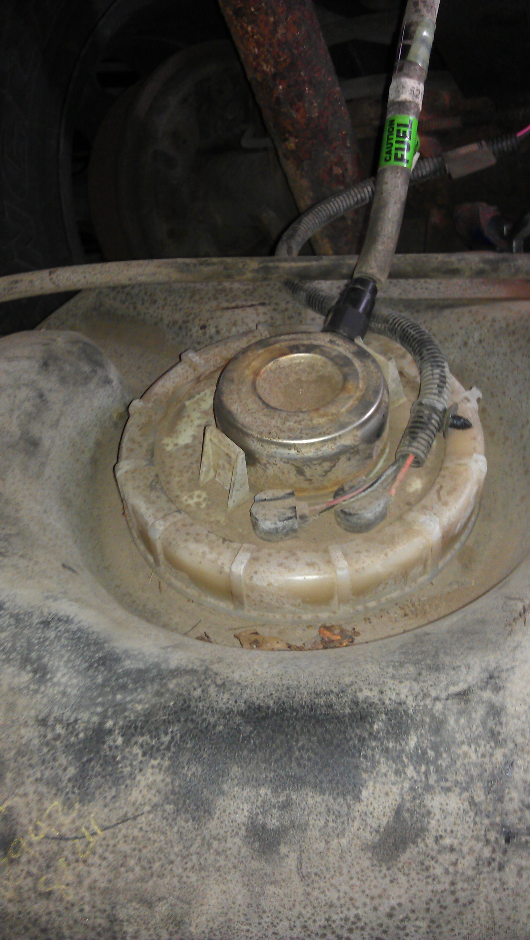

2) I cannot get the large flange to loosen up to remove the fuel pump. I read somewhere to hit it with a drift but I have been beating the snot out of it and it wont budge! (Second picture)

For the clip use a flathead and gently pry the clip lock out. And for the fuel pump top use a flat head and a hammer to gently tap it loose that's what I did. Now be careful cuz u may get unwanted debri into the tank
Now look at that clip "real closely" and you will see what he is talking about. That one threw me also when I fist ran into it. On the flange deal,I would get PB blaster and let it work for at least 12 hours, and then go at it. Keep spraying that thing down periodically dureing that 12 hours. Get PB Blaster at the parts store autozone is where I think I picked some up at.
okay im replacing my pump right now, so to pull it from the tank do i just rotate that big ring on the pump to loosen it?
Yes, unscrew the white plastic ring.
And for the connector, use a flat-head screwdriver to move the red locking clip to the side, then depress a lock tab to pull the two halves apart.
Mine wouldn't budge either, BFH and air hammer chisel and nothing, I finaly used a med sized flat screwdriver and drove it in to the plastic on the top outside edge knowing I may have to replace it but at least it will be off, finaly it loosened and without punching all the way through, all the pry-bars, chisels, and filter wrench did was break off tabs and slip. Eventually I got it.
