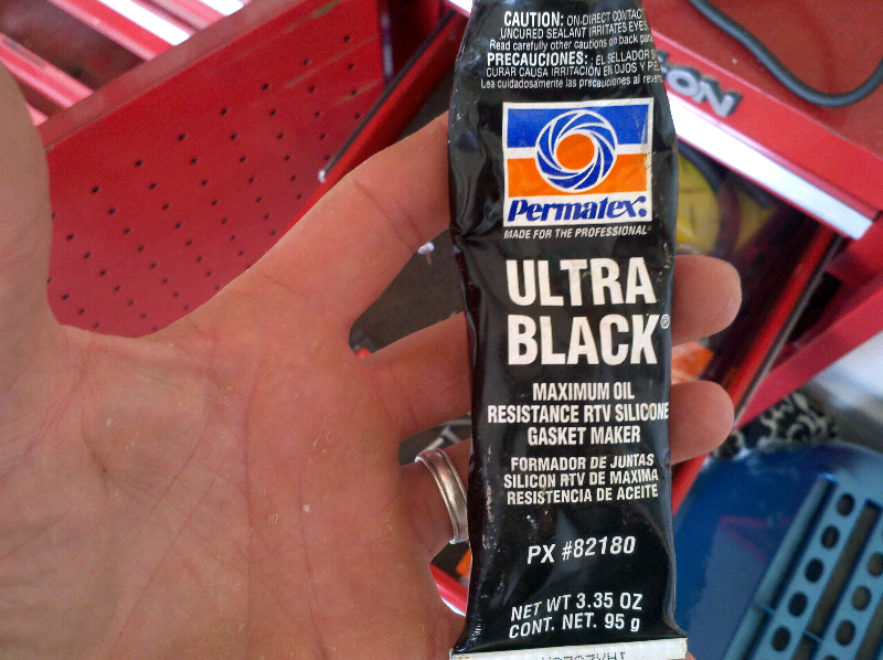

wwch99tj New member Sep 20, 2012 #3 This is the RTV silicone I used Sent from my DROID 2 Global Attachments ForumRunner_20120920_140732.png 643.4 KB · Views: 328
