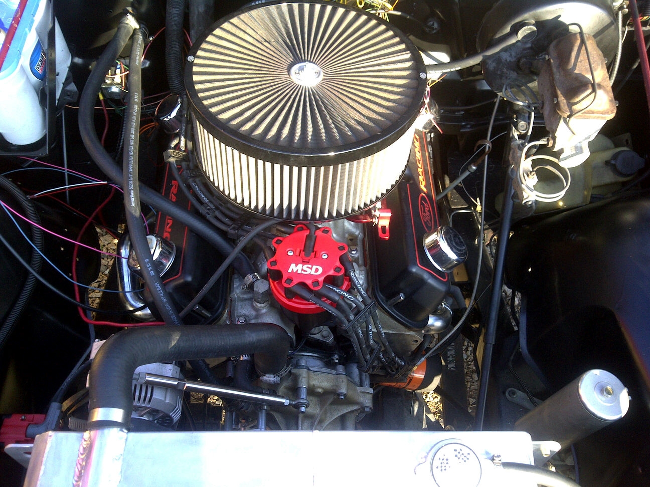

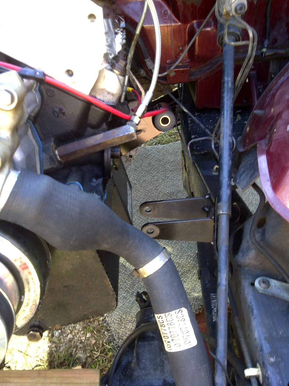

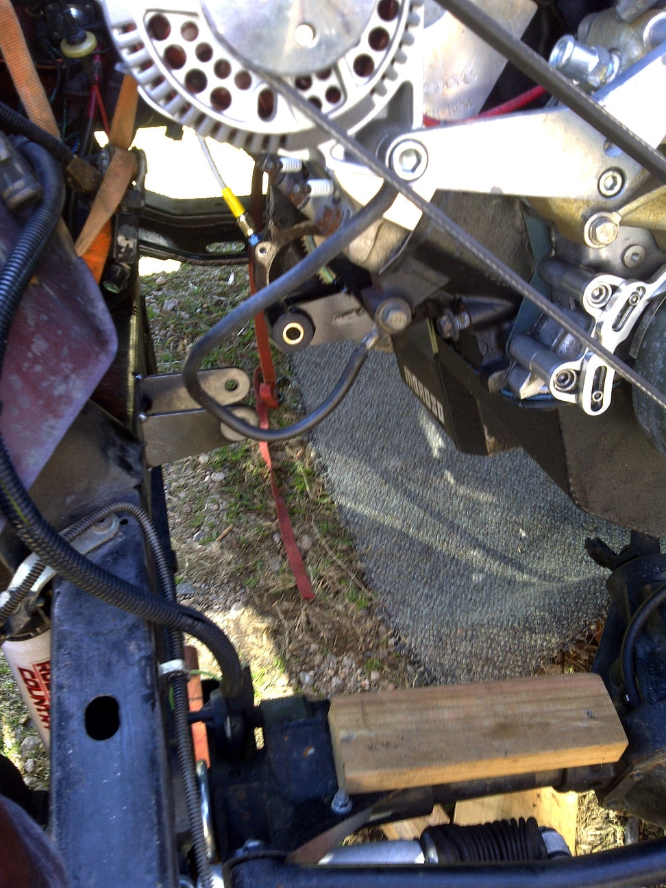

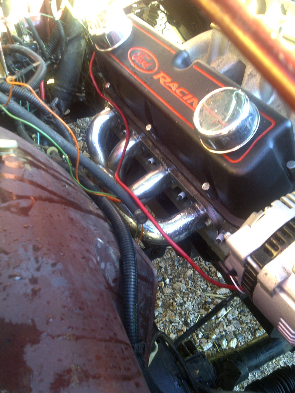

Here are some pics of the install, more coming later

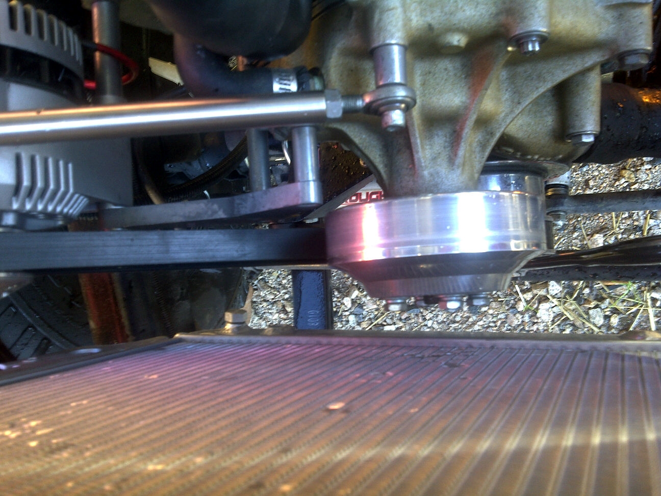

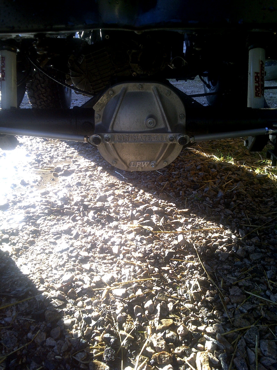

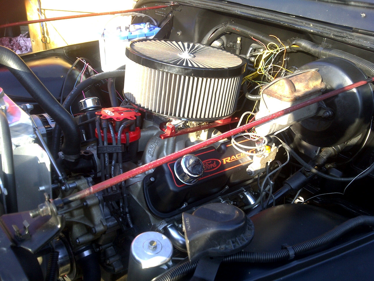

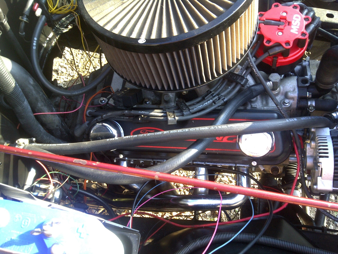

I got the rear end in the jeep this weekend, here are some of the newest pics of the progress.

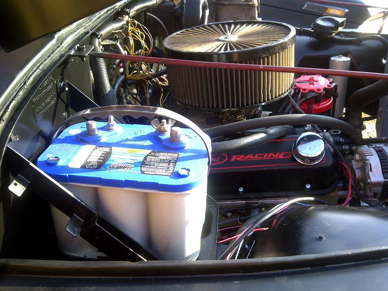

Update: I have been playing around with my jeep the last couple of weeks and here are a few of the things that i have accomplished.
I pulled the wiring harness out of the firewall sleeve and started cutting on some of the wiring that is not relavent to my conversion. A lot of the wiring looked as if it went to a hook up to do diagnostic related things. Well, it's not there anymore now. I also cliped all of the wires going to the electric gauges since i am going mechanical on the gauges.
I also lined up the body and tightened all of the body bushings
i hooked up the radiator hoses, installed the starter, headers, some ground wires to the engine, and the wires to the starter. My plan over the next couple of days is to take the dash out and to delete some more wires to make things a lot more simple. I also will replace the heater core so that it will not be an issue later on. When i accomplish those couple of things i will plumb everything and hook up all of the ignition parts.
I do have a little bit of painting around the windshield and under the hood as well as some body work to do on one rear corner of the jeep but will do that at a later date. Until then take care all......

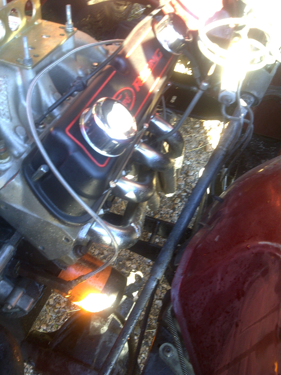

This is what a new years weekend of working on the bignasty1987yj looks like
dude, that looks so badass!!
