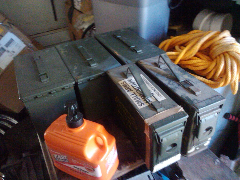

i have a number of ammo cans i bought from a guy locally that i had planned on using in the ol' jeep. today was a nice day so i got off black ops and went out and finally put the cans in.

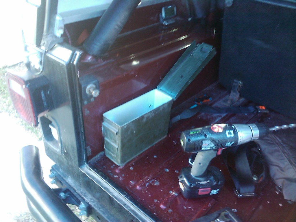

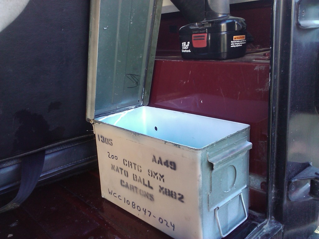

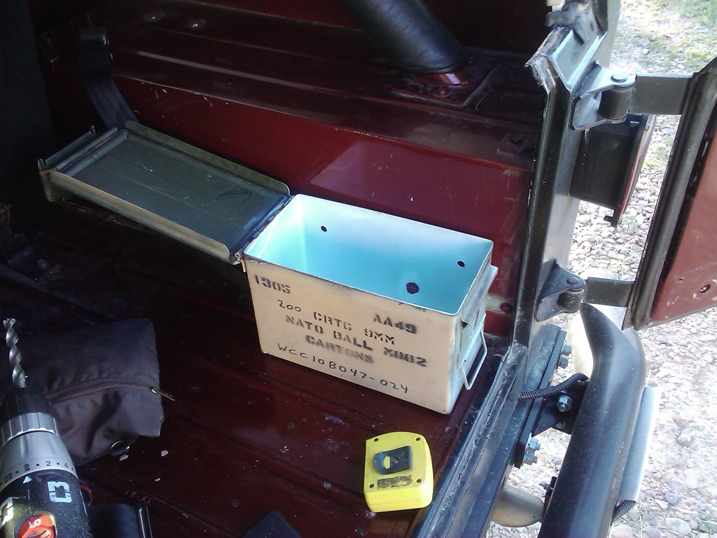

i always wanted to get rid of the center console because it, well, sucks. it holds two cans of soda and the bottom is broken out so everything slides out onto the floor behind the seats and it is just a crappy design. anyways, i wanted to put some ammo cans in the back to put my tools in and still have everything look normal so i drilled the cans and used some previous bolts on one can and two bolts on the other and ended up with this.
the small 3.5 x 10" can
the larger normal 6 x 11 can

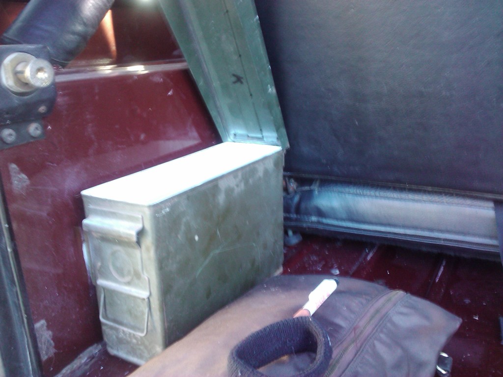

here they are with the seat down to make sure they can still be accessed.
now, it looks like i just have some ammo cans sitting in the back and i can still put junk in the back behind the seat. all the tool i carry fit into the cans as well as my mag light and bug spray and multi meter.

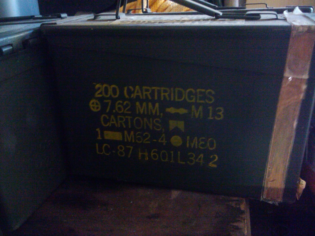

here is what is written on the little can, in case anyone wants to try to find some that size. it actually fits in that odd spot between the seat riser and the door and i am thinking of putting the last two i have on each side, since there are already bolts in the floor. just a matter of drilling hte ammo cans and putting a spacer so they sit level

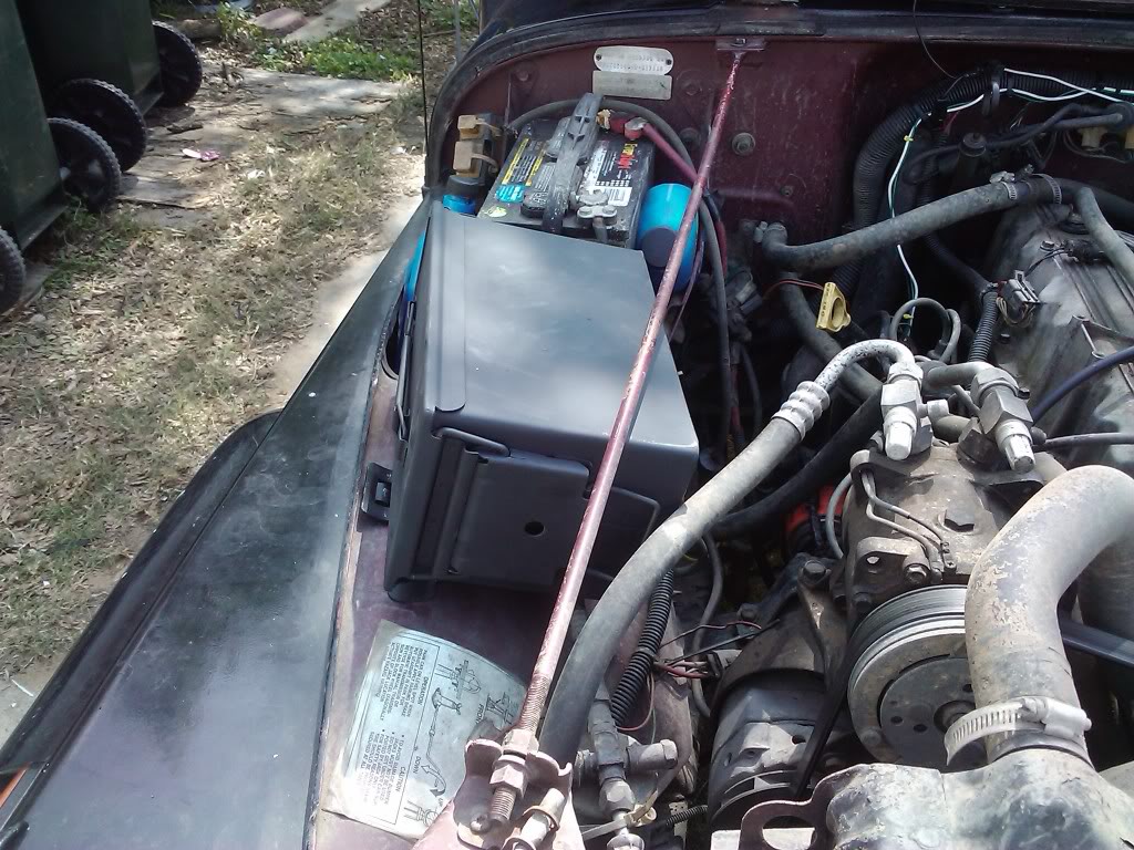

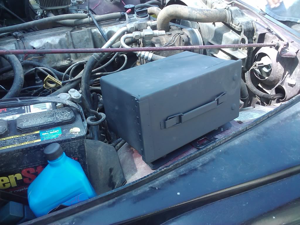

Ok, got one mounted in the engine bay finally. I used a regular old 6x11x8 ammo can and mounted it using an old jack factory mount. Drilled out some of the welds and welded it to the ammo can and then bolted it to factory mounting points. Lid open s and closes and the hood doesn't hit anywhere. I will post some pics when I get to my phone since I am on the wife's I-phone and I cannot figure out how to open multiple pages to copy and paste
its tilted so everything doesn't just fall out. i moved my tools and some other stuff into that so the ones in the jeep are basically empty. it clears the seam for hte fender and when you close the lid, it doesn't hit anything or rattle around on bumps. its very solid with that 3 point bolting. you can see the jack mount i used. its from the wife's 93 sahara and was a little different then the one in my 87 but the parts i used, the base, is the same
