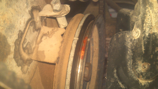

also could check the timing it's possible it's out of time

The timing was off by 3 inches. Moved the straight line were the repair manual says it needs to be. Putting belt and alternater house back together now

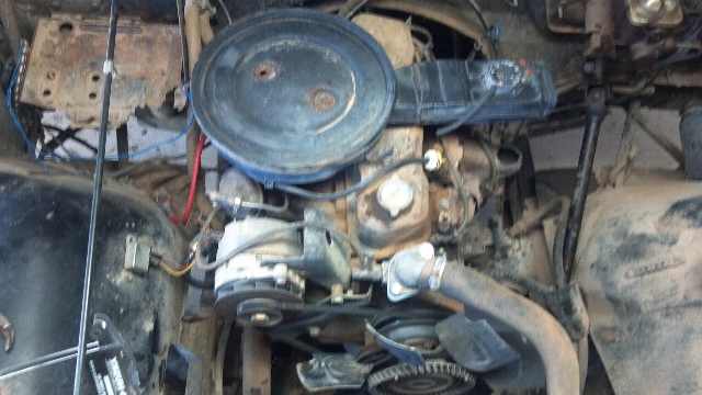

Thats what i did no leak. Have to find a way to reach to the idle screw. I was able to unscrew it a small bit and it to brought to down a to 1700

Maybe it's my eyes playn tricks on me but it looks to me like the little caps that plug off the unused vaccume on the carb are cracked. That's where the vaccume leaks are.
