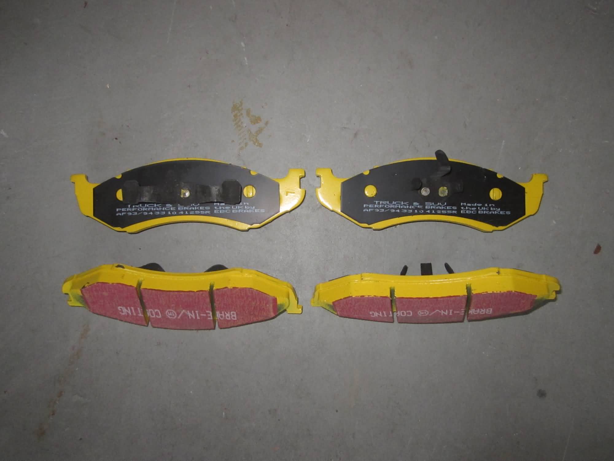

My 2005 Wrangler has never stopped well, and there was no chance of locking up my 33 inch KM2s, so after a few close calls where my brakes couldn't stop the Jeep fast enough, I decided to upgrade.

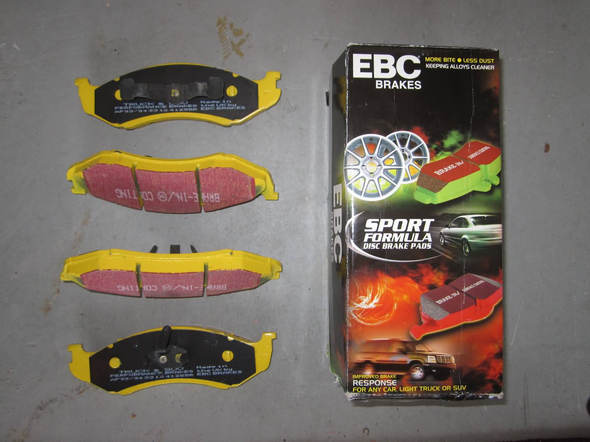

I opted for a simple brake pad / rotor upgrade, and after much research I settled on the EBC Yellow Stuff brake pads (part number DP41255R). It would appear that EBC's Green Stuff is geared toward trucks, but the Yellow Stuff seems to have more of a following.
The best price I found was on Amazon: http://www.amazon.com/EBC-Brakes-DP41255R-Yellowstuff-Street/dp/B001C8WP8Y/

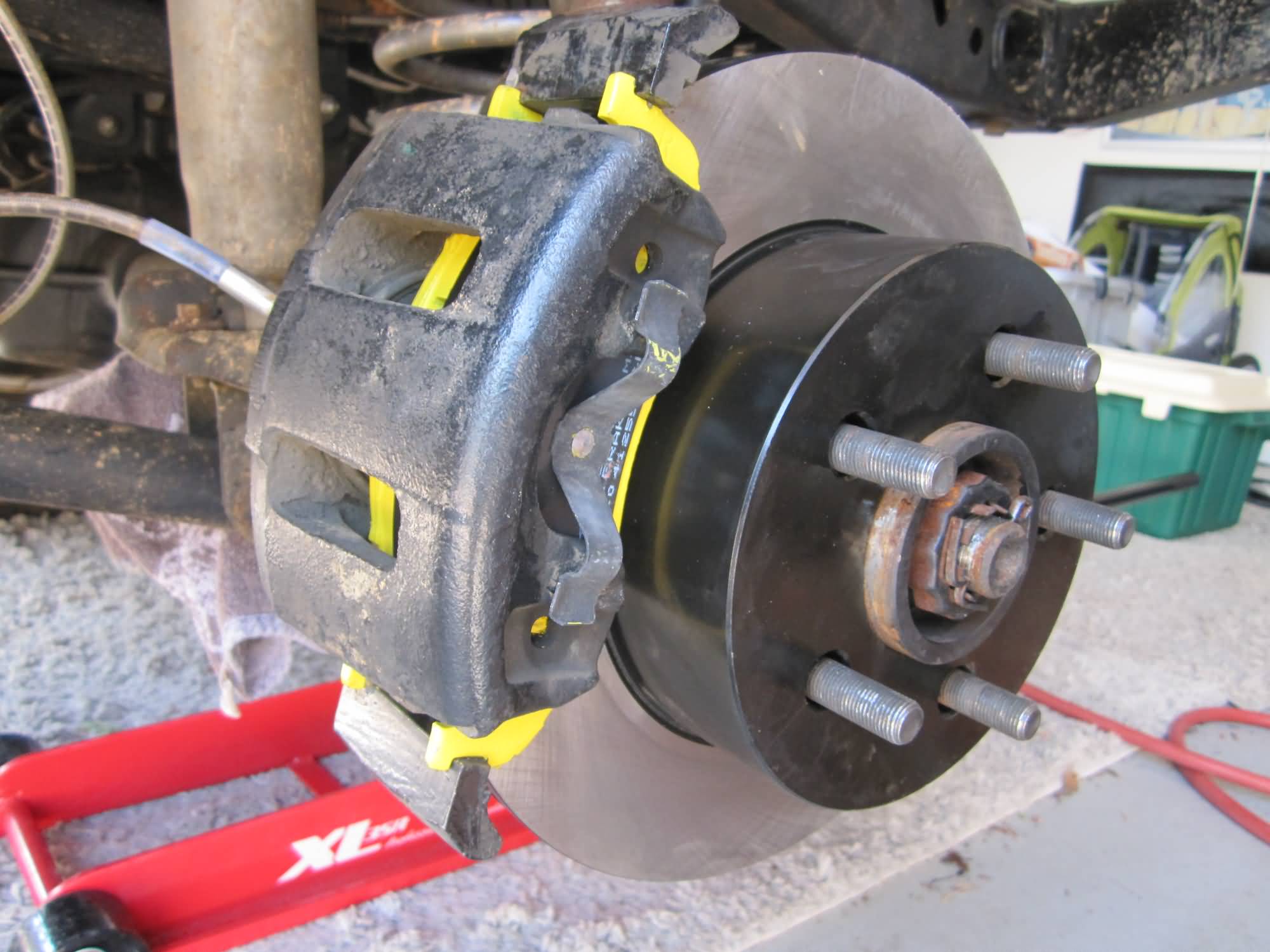

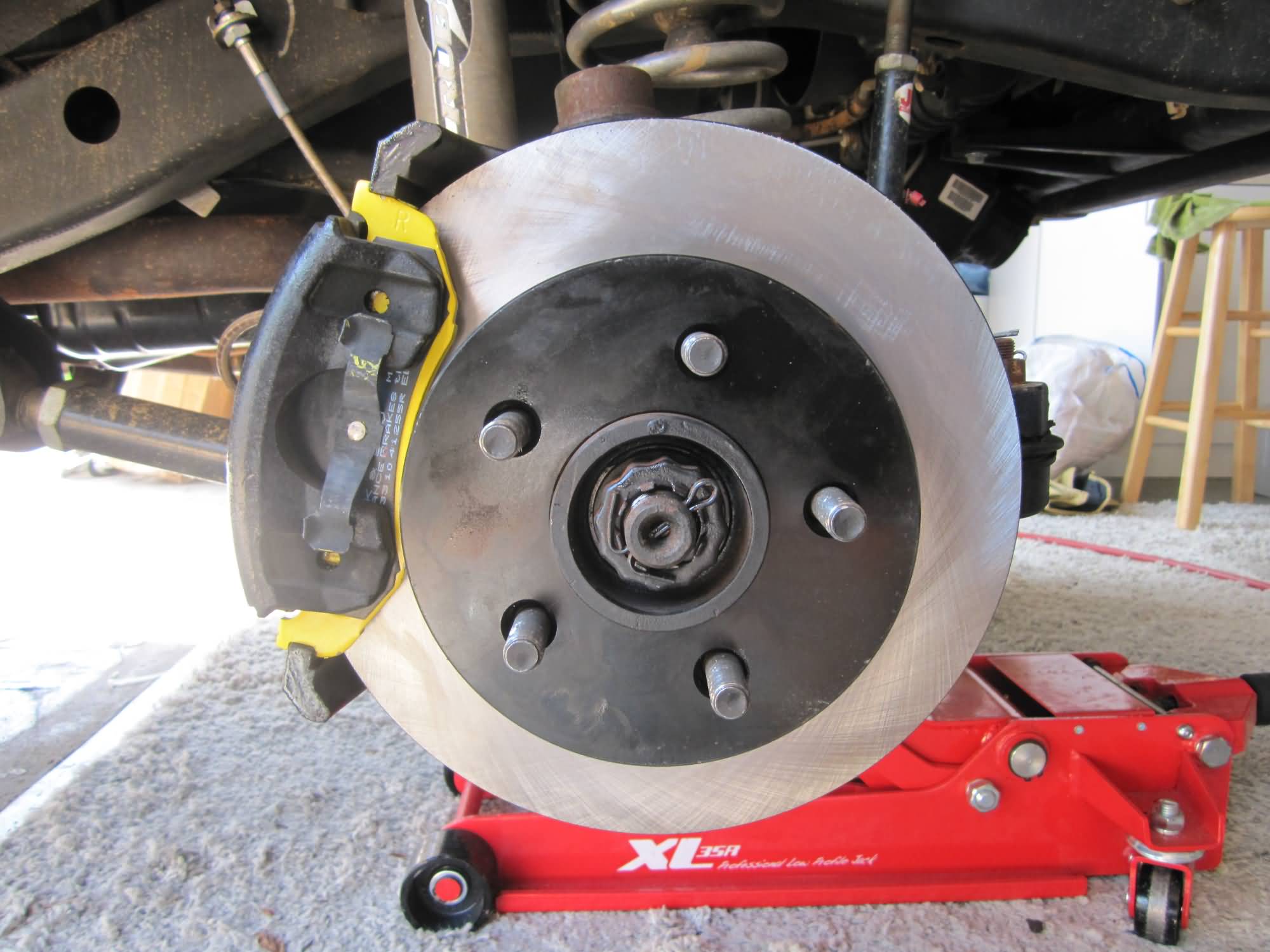

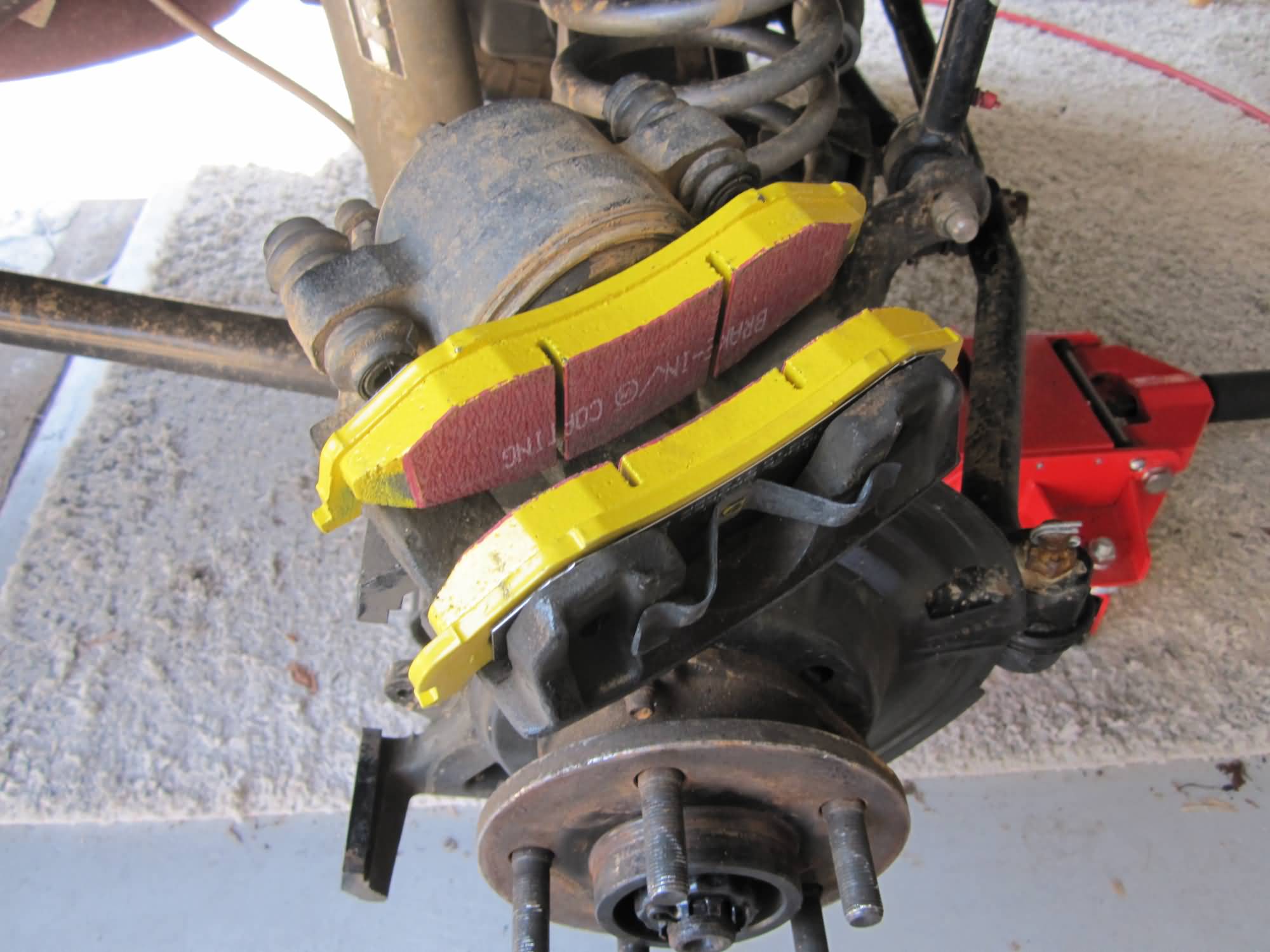

The install was straight forward - like that of any brake pads.
I coupled this upgrade with some Centrex Rotors which are said to pair well with the Yellow Stuff pads.
I couldn't be happier with these brake pads. I'm actually able to squeal the front tires when I slam on the brakes. The Jeep now stops 100% better than with my previous Wagner ceramic brake pads. When these wear out I'll be buying more Yellow Stuff pads for my Jeep.
