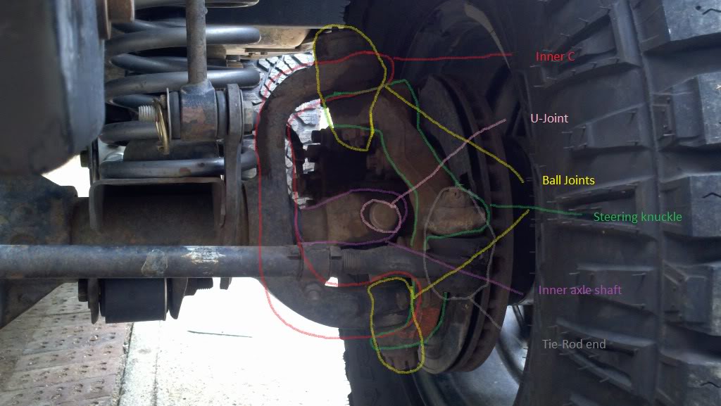

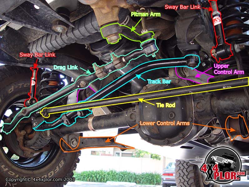

You own a Jeep, you should have some basic tools and a Harbor Freight within a hundred miles or so, so lets get you started down the road to mechanics shop independance, first let me ask, did you install the lift yourself? If so, then you have a fairly good idea whats under your Jeep, if not, time to go have a look, take some cardboard and lay under there and just look around and see how much you can identify and know what its purpose is. then refer to a couple diagrams, one from 4x4xplor -
Now, jack up one side of your front axle, just enough to have the tire a few inches off the ground, make sure the jack is under the axle itself, now using either a prybar or just your hands try to 'wiggle' the tire not rotate, but in and out, there should be a tiny bit of play caused by the steering giving a little, but that will be at the sides, push in and pull out at the top and bottom, or put the prybar under the tire and lift up, if it has and play up and down, then yes, you most likely have a ball-joint or unit bearing that will need replaced, if not, look closely at your ball joints for signs of fresh grease or no grease at all, concider how many miles are on it and how hard your wheeling.
Next lets have a look at your track bar, grab it up by the frame side mount and see if you can wiggle it at all, you shouldnt be able to, and if it moves you will immediatly be able to tell why (make sure you have a rag or two with you, your going to get greasy here), next we'll look at the axle side of the track bar, this side can only move side to side if it has a bad bushing, you wont be able to do it by hand, but you should be able to see small clean areas of metal if its been moving.
Ok, moving along, you can do this same thing at your tie-rod ends, wiggle them and look for movement, you can even gently use the prybar to look for movement, this is the most likely place your going to find problems because you have a 4" lift and 33"s, its time to upgrade that steering if you want to be safe and see lots of life out of your Jeep, including your own, there are a lot of options and a lot of price range in steering, and a ton of wildly differing opinions, you go with ORO U-turn for about $600, Currie for about $450, Crown for about $200 or the ZJ upgrade cheaper than that, we'll talk more about that in a minute.
