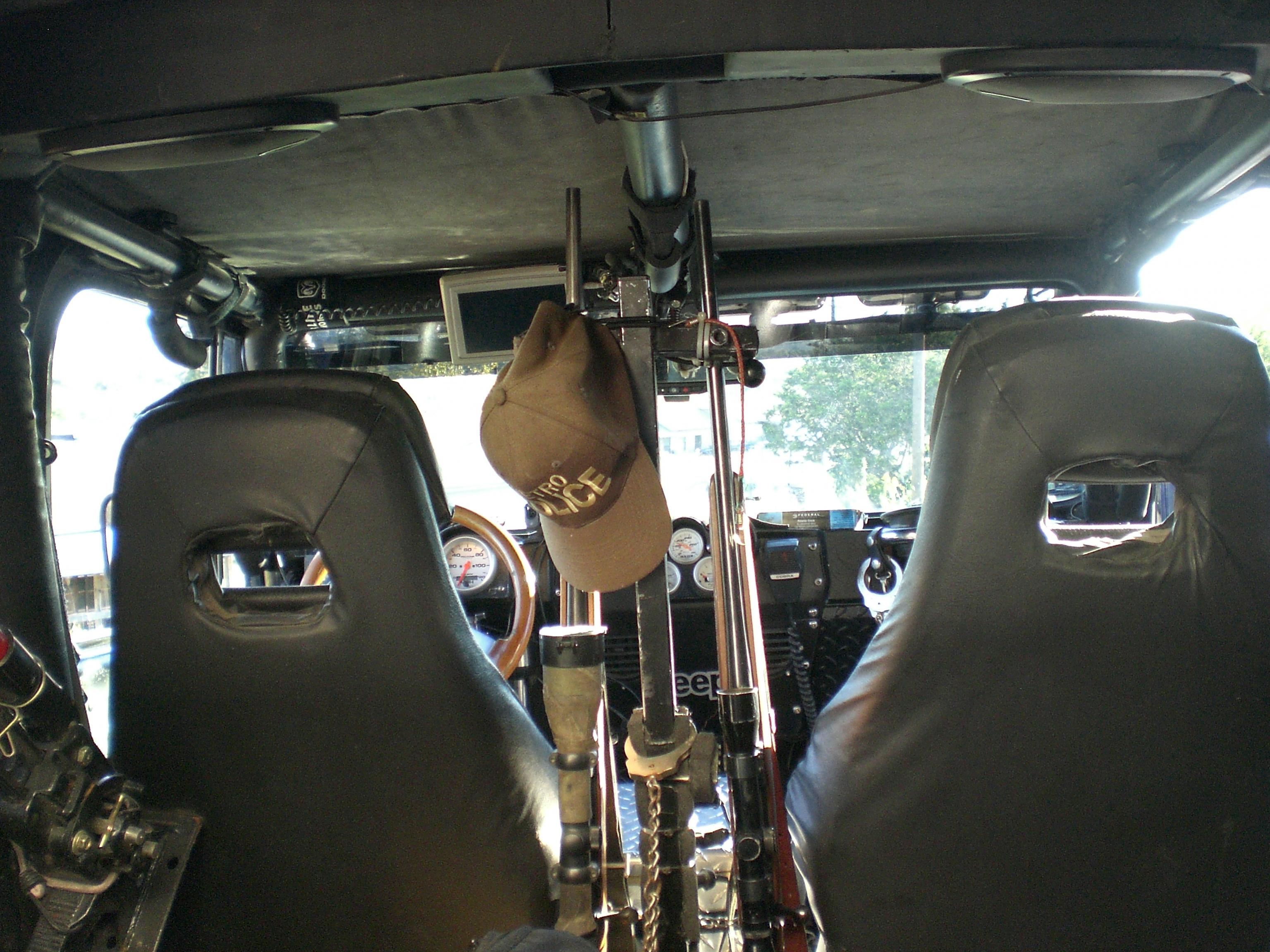

I like the gun rack. It adds a nice touch. Is it home made?
I Built Just about everthing in this jeep. The gun rack is custom built and is held on the floor with 4 stainless steel 1/2 inch security bolts. the rack can hold 2 scoped rifles and a shotgun in the middle.its lockable with a 1 inch solid steel bolt across.just for safety reasons like going to wallmart.

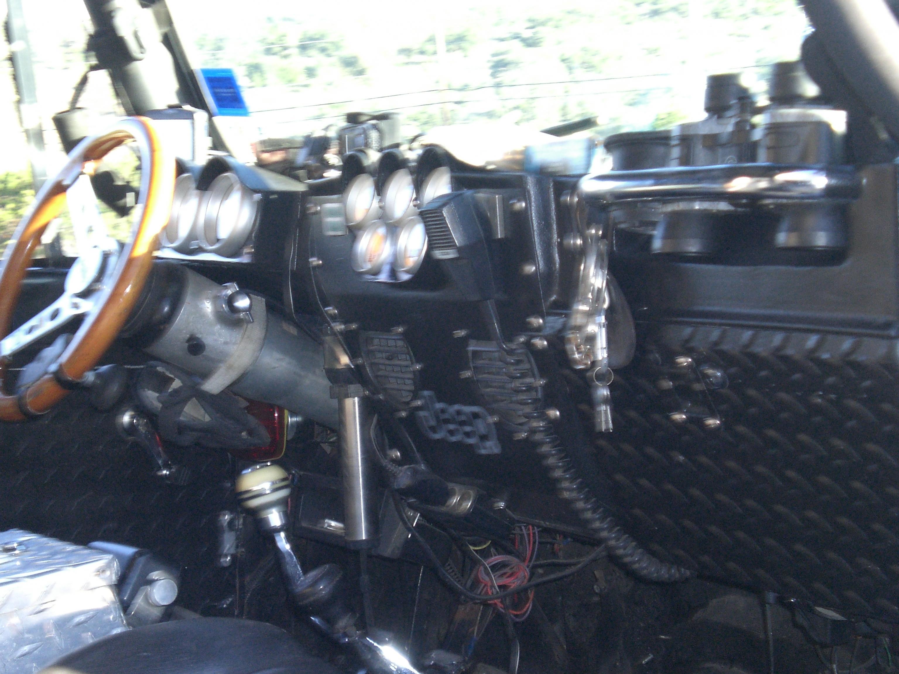

Please tell me that you have plans available for that dash and gun rack. :fingers crossed:
Sorry Mr. Bill Rhodes, i don't have plans when i build. it's all in my head. the idea for the dash was a Weather resistant, functional, and the good o'l Classic look on the Guages. I took out the Original Heater Box and gained quite a bit of room behind the Dash. after converting all the guages to Autometer i was able to eliminate some wires.i installed a 12,000btu compact heater unit and built the dash with it along with the duct works. with the extra space i was able to accomodate the CB, AM/F/M CD Player,Search and Rescue Radio Recessed in the glove box on the passenger with a locking door. i installed an 11 channel Bose Amplifier with a matching Subwoofer next to the glove box where nobody can see it. I can Draw it out and give you the Dimensions if you want.
That would be great. Can you also take more detailed pics of the gun rack? I like that set-up as well.
I already don't have a heater under my dash, it's between my seats. Probably the same kind you bought.

I apologize for Miss-spelling your name. I didn't mean any Dis-respect. I will take more detailed photos of the gun rack with Dimensions and Specs. as far as the Heater box is concerned, i bought it from 4wdhardware. Part# 640. i didn't buy the plenum because i enclosed the front section of it to the Dash i built and Fabricated the duct works from there. :)--

Thanks in advance for the extra pics and specs on the gun rack.
