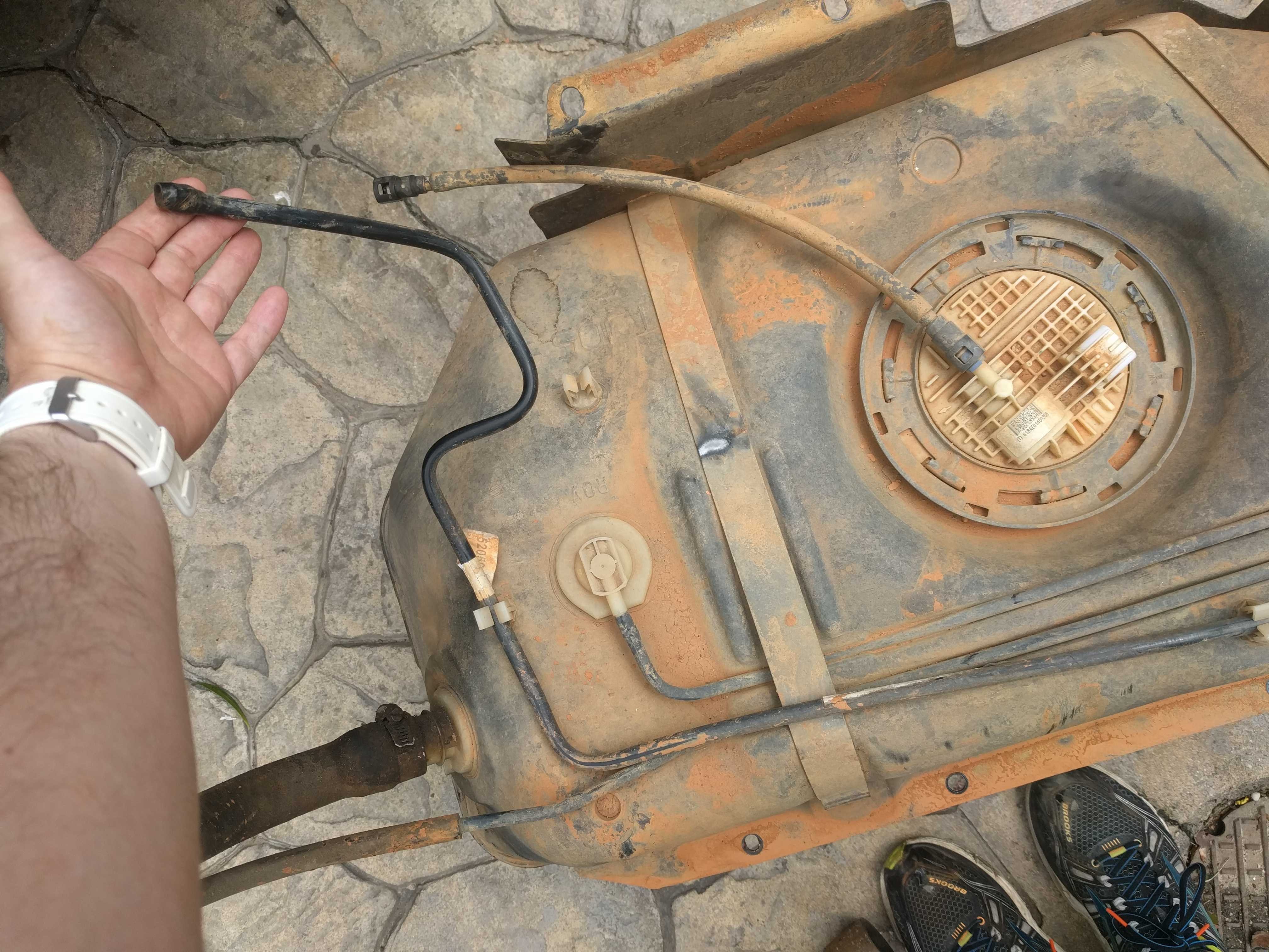

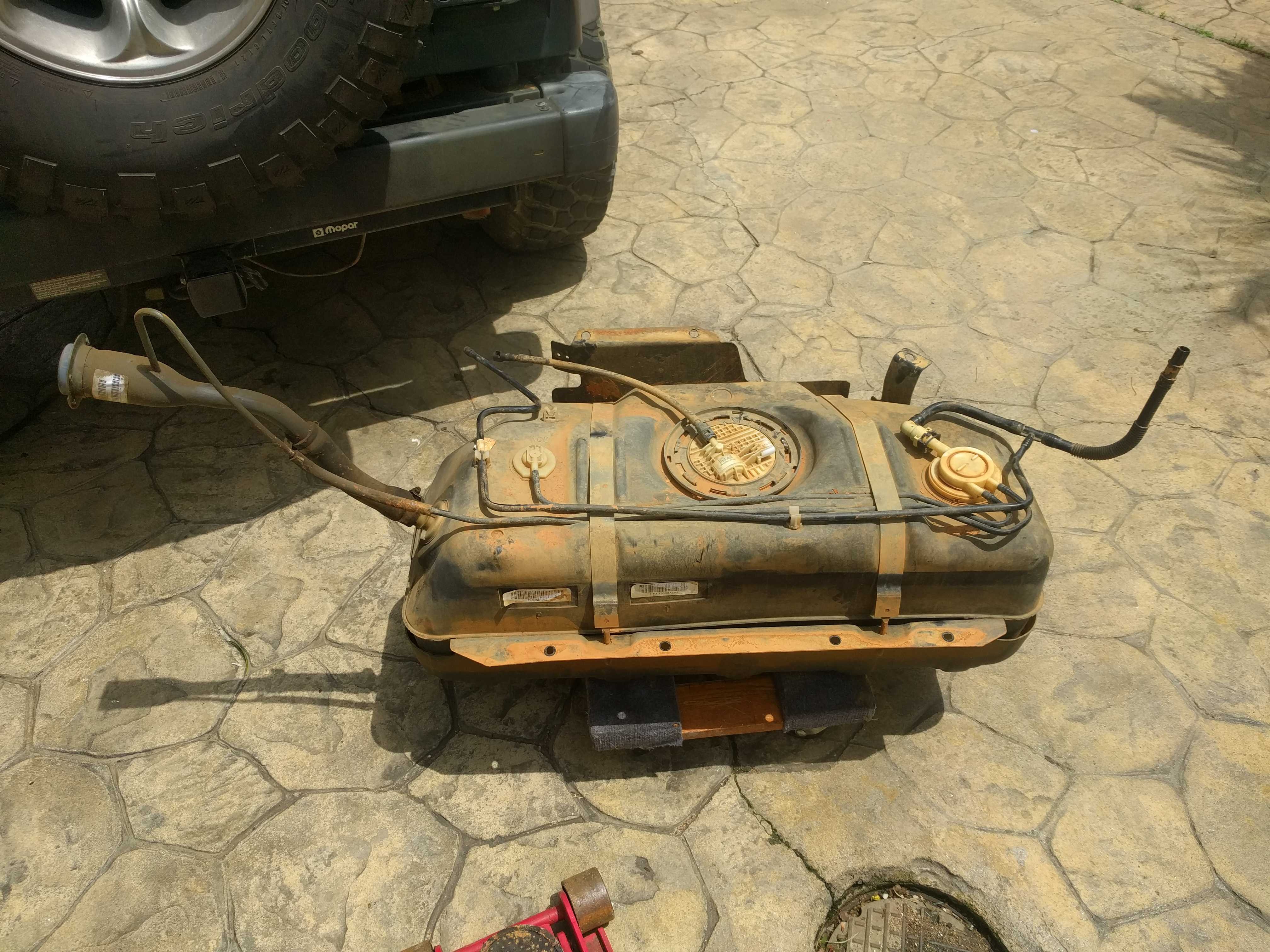

Well, I got the tank out, however I noticed that one of the fuel lines is broken. Anyone know what this plastic line is? It looks like a vent line.

$70 has one on order at the dealer. One end connects to a vent line that leads to the front of the Jeep, the other end (the one that has the T on it) connects to the charcoal canister and the tank itself).
Here's what it looks like
That's where your p045? code is coming from.... It's an EVAP system code... The other code is for an O2 sensor heater
