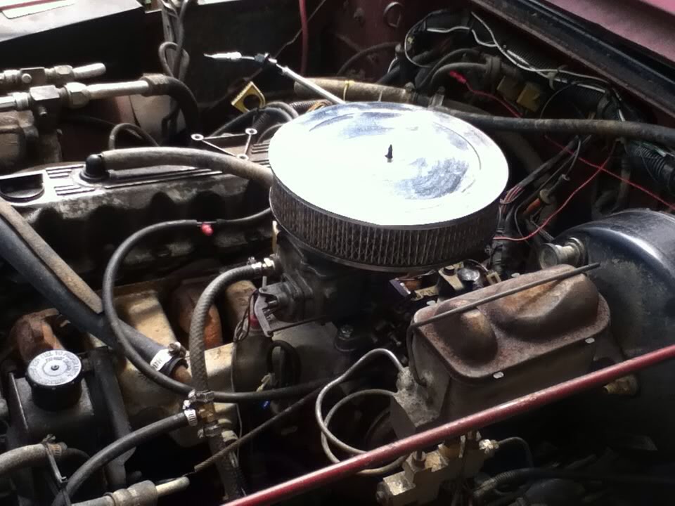

new carb

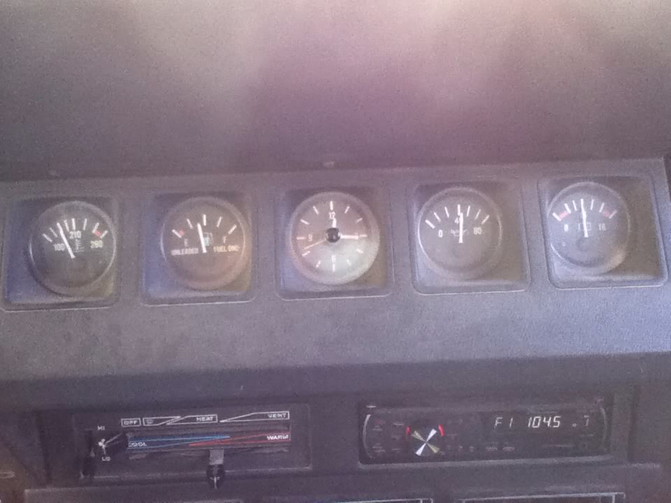

gauges

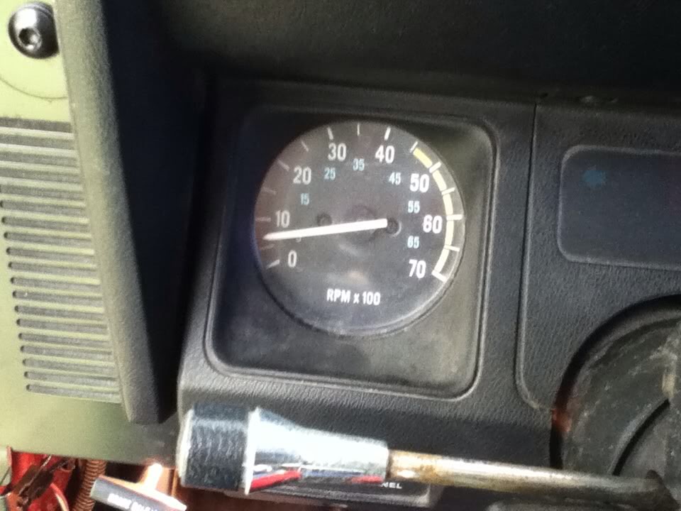

idle in neutral

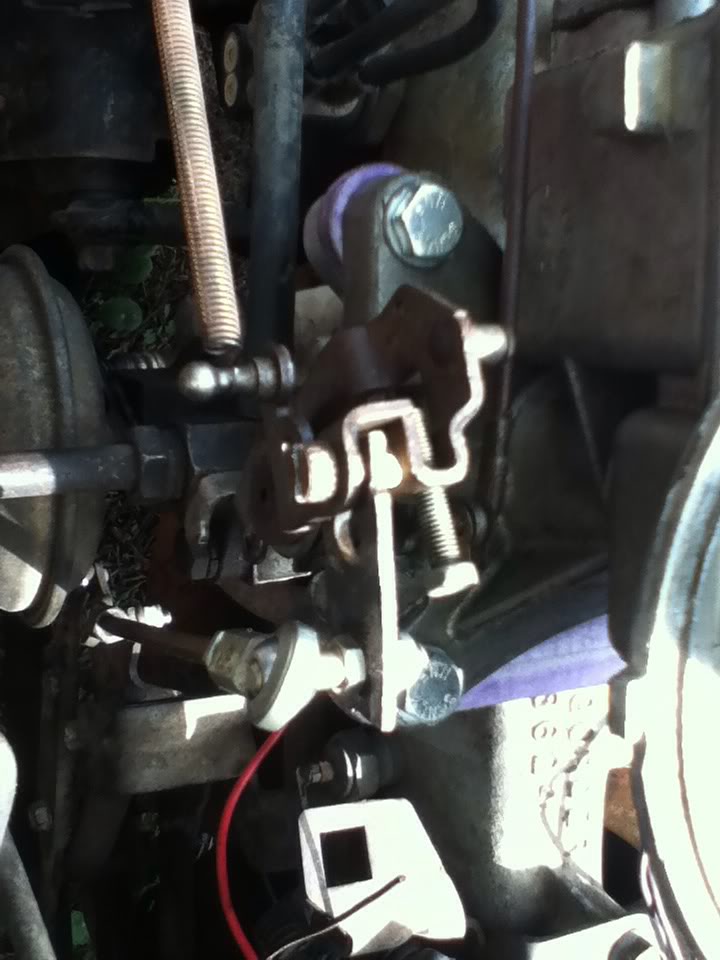

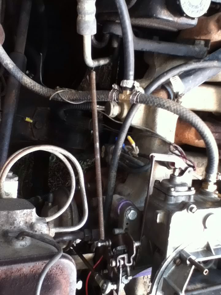

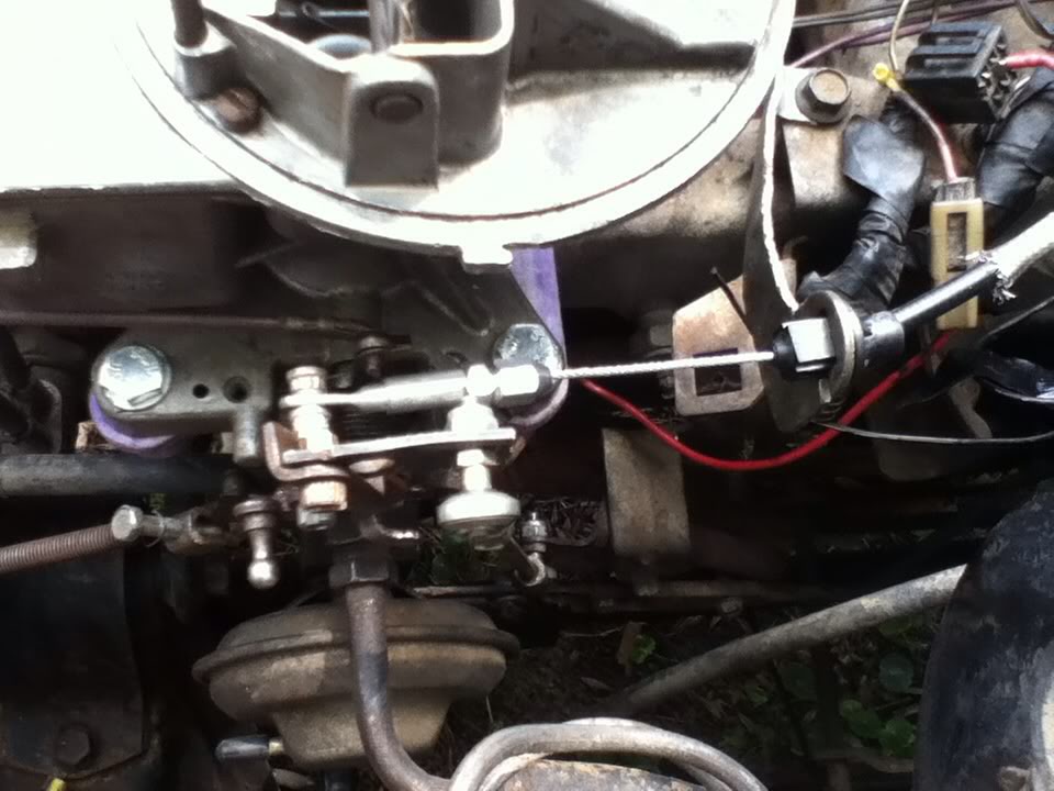

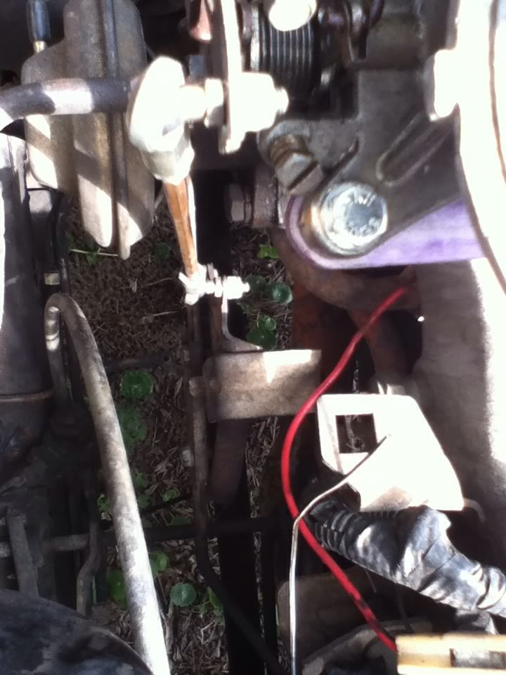

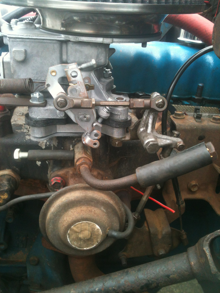

the only trouble i am having is an of idle bog. it acts like an accelerator pump but i am getting fuel so maybe the linkage is set too high.
what hole is ya'lls linkage set into? mine is on the top one.
And the award for best photo documentary goes too.......Superj haha lol. Mines on the top hole also. Don't like how it feels. I also used the pivot bracket from the weber. I see yours is direct to the carb. I'm going to try that. The way it is now, it snaps the throttle back to quickly.
