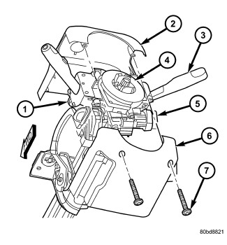

3.From below the steering column, remove the two screws that secure the lower steering column shroud to the upper shroud Fig. 1 .
Fig. 1 - Steering Column Shrouds Remove/Install
1 - LEFT MULTI-FUNCTION SWITCH 2 - UPPER SHROUD 3 - RIGHT MULTI-FUNCTION SWITCH 4 - CLOCKSPRING 5 - IGNITION LOCK CYLINDER HOUSING 6 - LOWER SHROUD 7 - SCREW (2) 4.If the vehicle is equipped with the optional tilt steering column, move the tilt steering column to the fully lowered position and leave the tilt release lever in the released (down) position.5.Remove both the upper and lower shrouds from the steering column.6.Disconnect the body wire harness connector for the left multi-function switch from the connector receptacle on the back of the switch.7.Disconnect the body wire harness connector for the right multi-function switch from the connector receptacle on the back of the switch.

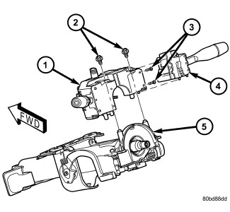

8.Remove the two screws that secure the multi-function switch assembly to the upper steering column housing Fig. 2 .
Fig. 2 - Multi-Function Switch Remove/Install
1 - LEFT MULTI-FUNCTION SWITCH 2 - SCREW (2) 3 - SCREW (2) 4 - RIGHT MULTI-FUNCTION SWITCH 5 - UPPER STEERING COLUMN HOUSING 9.Remove the multi-function switch assembly from the upper steering column housing.10.Remove the two small screws that secure the right multi-function switch to the left multi-function switch mounting housing.11.Grasp the right multi-function switch control stalk firmly and pull the switch toward the right far enough to disengage the alignment pins on the top (1 pin) and bottom (2 pins) of the right switch housing from the alignment ramps on the left switch mounting housing.12.Remove the right multi-function switch from the left multi-function switch mounting housing.
