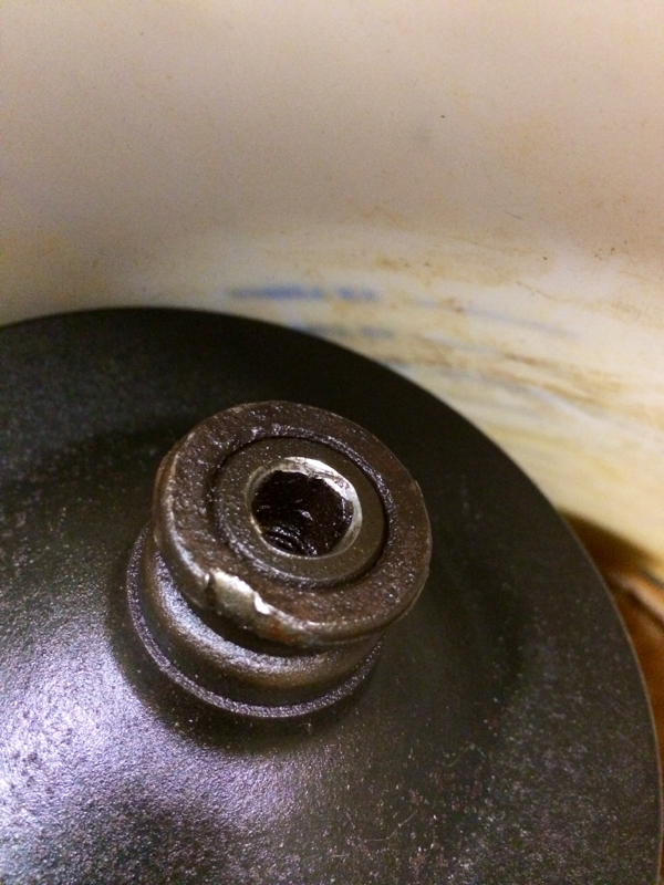

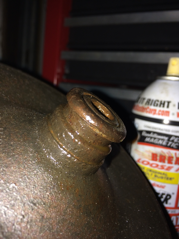

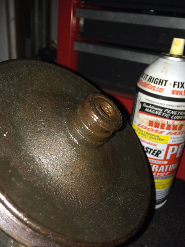

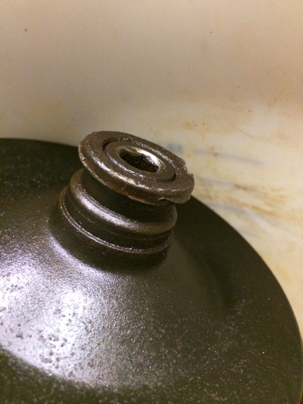

Thanks for the reply... Well tonight was an epic failure. Tried using the tool on the "untouched" pulley. Still no dice. The new removal tool from pep boys didn't damage the pulley as much as the harbor freight one. See attached pictures. The first 2 pics are from tonight. Again. Not too much damage.... But the pulley still won't come off. The other two pics..... Well. I think that one is going to be the test mule. It's already all bent up. Not much to grab onto anymore.
So.... I guess MAP gas is going to be the next go around. My other thought was just to get another pulley.... But I can't seem to find one.....
Well.... This could be a tutorial on what not to do!!!!
Thanks again... And feel free to comment on my he man attempts that left the score : pulley 2 me 0.

Thank you for your reply and photo posting. Well, it seems this otherwise "simple" task IS proving to be a tutorial. After seeing the pictures , I must ask a question about the tool used for this venture. I'm guessing that the forcing screw of the tool has a wide surface which applies pressure to the top of the shaft as the cup grips the pulley. This only serves to spread the shaft creating an outward expansion toward the pulley making it difficult to pull the pulley off of a surface which is now being increased in width due to flex . The shaft is spreading under pressure and your losing what little space tolerance wise there is to extract the pulley off .simply put , the wrong method is being applied. Not at all questioning your ability , but I'm thinking the tool vended may be wrong for the application. The last time I did a ford power steering pump pulley removal for a water pump job on a '97 3.8 liter mercury cougar , the puller had a pin type forcing screw which reached down inside the shaft applying the pressure inside the shaft , not on the end. Applying pressure to the end will result in a mushroom effect to the shafts end making extraction obviously difficult. Your welcome to post the tool but I think it is better served to ask if the tool has a forcing screw with a pin end that will reach inside the shaft to aid extraction. Also , the internal hole of the shaft should have thread which will have to be restored ( remove rust ) to aid in the reinstalation of the pulley. So , to sum up , the correct tool to remove this pulley should have a pin type end on the forcing screw. The pressure should in effect be applied inside deep on the shaft , not to the end. It really should not be necessary to use map gas or even propane if the metal is not severely rusted or corroded. It appears that your pump(s) are not that far advanced in corrosion.
I like Greg's input, great problem skills Sir! The puller I have is more or less just a threaded shaft (more like a sholder bolt) that fits this particular pump style. It has other arbors for different pumps. I believe I go it at Advance Auto? I also found that I had to use an impact gun and just quickly "hammer"it off.
You could very well be correct. Maybe I'm screwing this up by not using the right one.

I've attached 2 photos of the tool. Yes the end is dome shaped so that makes sense why it is tearing up the front of the shaft on the one.
The one that is really torn up is from using the HF tool. The bushing sleeve was very thin and flexed just enough to slip. The one that has just a few marks on it is the tool in the pictures.
