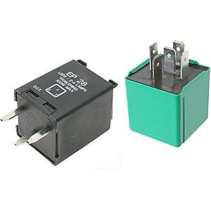

I over looked it is a 52, It may not have one. On my 69 it is about half way between the steering wheel and the floor board. let me see if I can find a pic of it. [TABLE="class: mid"]

has your turn signal switch been replaced or is it an old one ? I believe on those old 52's that the flasher is build in with the turn signal switch to the best of of my knowledge which at my age is fading fast ,,,and make sure you have the right bulbs , have seen people use the wrong bulb and cause some problems
Are you all saying that the relay and the flasher unit are one in the same? If so I do have a flasher unitjust hanging loose under the dash board and it does show in the wiring diagram. I may not have the right bulbs. Maybe I caused my own problem. When I wired the T/S and brakes I had both the T/S bulb and the brake light bulb flashing at the same time. Could this have worked for a while and then caused a short? I guess I will undo that combination and try again. Thanks for your comments!
