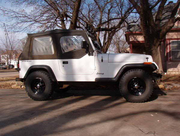

On what? My YJ is on 31's with Cragar 15x7 rims, and I only have a very slight rub on the rear fenders at full stock flex. Stocker rims on Wranglers are 15x7, unless it's a Rubi, then they're 16x8 (or is it 15x8?). The bolt pattern is 4.5 on 5. With 31's on my stock aluminum rims I had some rub on the front springs at full lock, which was remedied by adjusting the steering stops until I got the newer rims with I think 4.25" backspacing. Now I've got my full tight turning radius back and no rub up front. Really don't have any rub in back anymore, either, because the tires have rubbed a 1/4 inch arc out of the flares where they used to rub!
That's a stock YJ with 31's on it, no lift.
