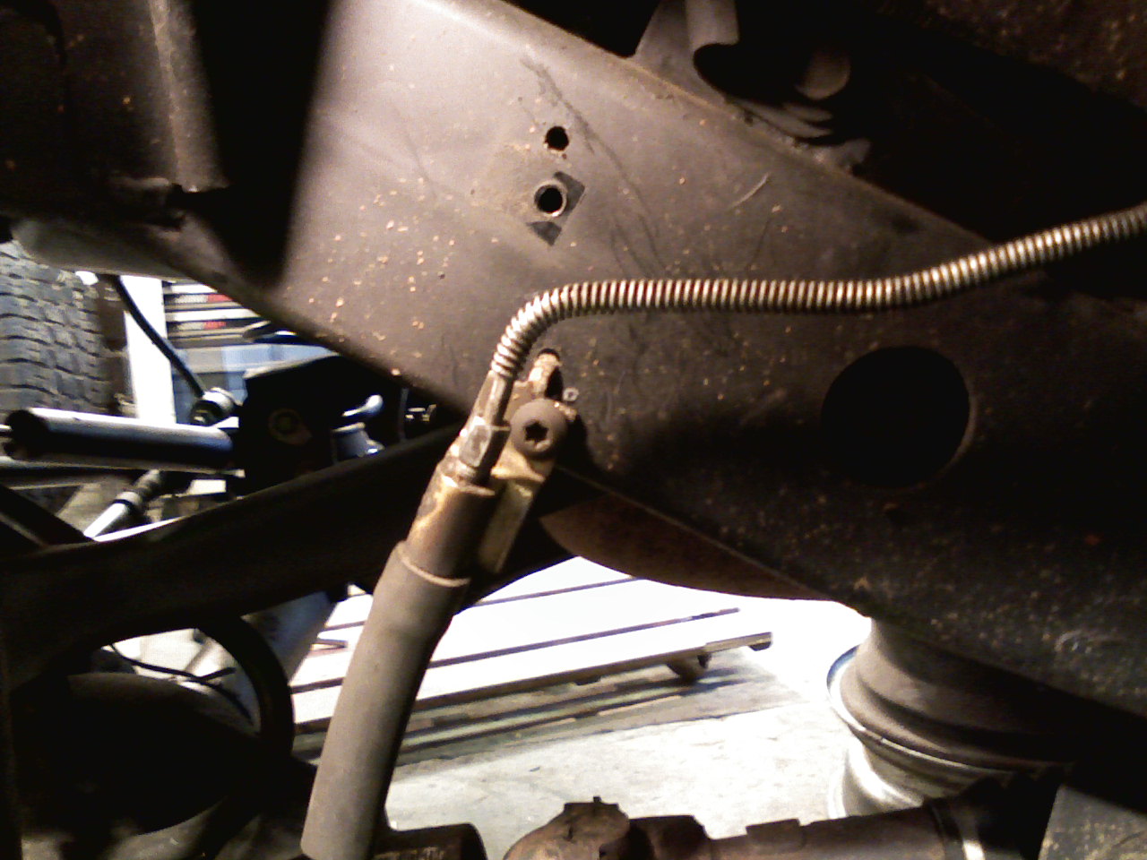

Well i'm 3/4 way of being done with it but hers some pics of how made things work. Made the shocks longer, and dropped the brake line down
BootyFab shock spacer, too much leverage on such a skinny spacer. I would have used square tube or anything to give such a tall spacer a wider base.
You did right on the brake lines.

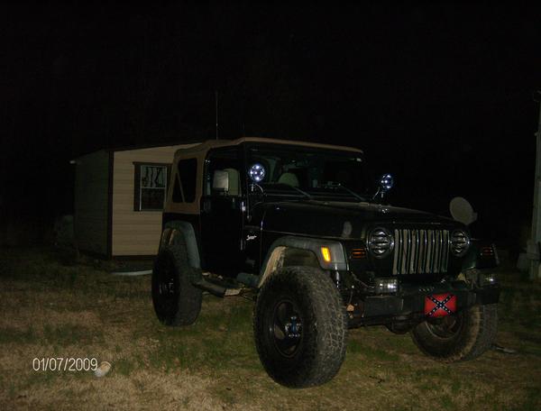

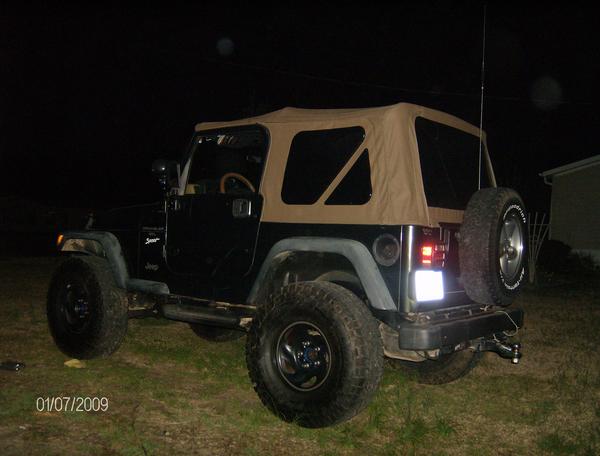

Well here it is after a whole week
