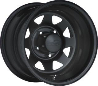

Black steel rock crawlers something on the lines of this
Although steel may be bent or hammered back into shape. Steel rusts, not only from the outside which is what most observe, but the inside caused from condensation and air pumps with poor water collector/separators. Alloy doesn't rust, however, once damaged, it is scrap. The benefits of steel is that most larger tires fit these type of rims. That isn't to say that if you know where you could find a water cnc machine, and have lots of cash, you couldn't have them made. It is of choice and finances.
Sure steel rusts but you can take them off, take the tires off, sand blast them, coat them in etching primer and re-paint them any color you wish as stated above, the only down side to steel rims is that they tend to weigh a little more than alloys, steel rims are for the offroader and daily driver, alloys alot of people are very cautious of when driving offroad, I just bought a set of moabs off an 07 jk, bought them for my yj, and I'm not worried about bashing them due to wanting steelies when I go to bigger tires, but that's just me, if your comfortable with rock crawling on alloys and taking a chance at breaking them go ahead but I recommend steelies.
