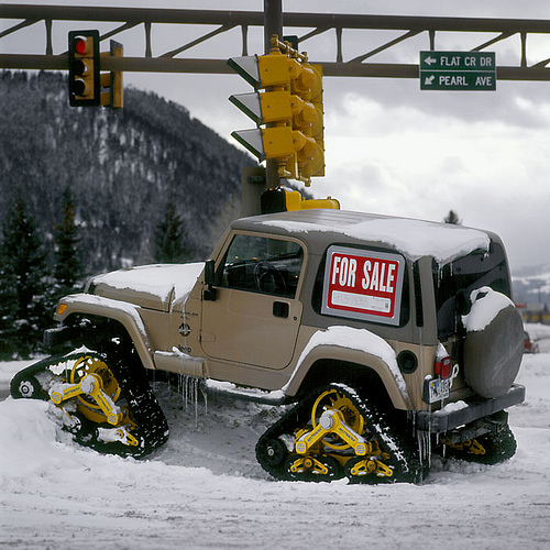

I think the MTs are a wise choice. I have BFG ATs on my rubicon and although I've never been not-able to go somewhere because of them, I think a comparable MT looks cooler. If you're really going for floatation, consider a set a Mattracks! Otherwise, I don't think you can really get enough flotation on a set of tires to "float" across the snow. Some people ding the pizza-cutters, but really, i think a narrow tire, like a 33" x 9.5" (in conjunction with a few sand bags in the back) gives you better snow traction, as it sinks and cuts to the bottom of the snow to give you contact with terra-firma, and offers more pounds per square inch of traction. Also, there's nothing more utilitarian looking than a jeep with tall narrow tires! Do these and you'll be surprised as you blow past others who are running 36" x 14" mudders!
