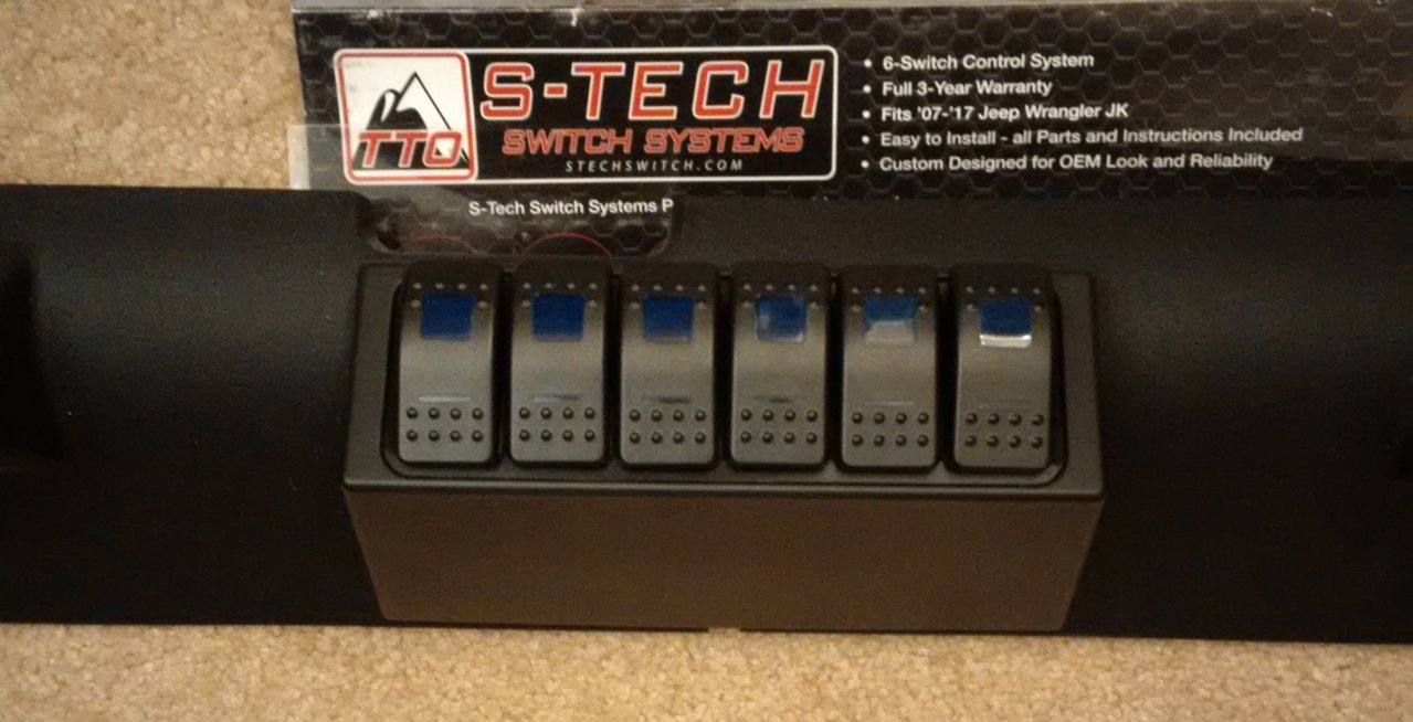

The S-Tech switch system organized and simplified all my 12V accessories that I want in my JK. The S-Tech is affordable and simple to install as only one bundled cable enters the Jeep and all future 12V accessory are connected under the hood. Only one rectangle cut out of the windshield trim is needed and this inexpensive trim is replaceable.
  • S-Tech switch pod mounts directly into the plastic trim above the mirror. Other competitive units mount onto the footman loop with brackets and tape which can reduce access to the hard top latches and most have an open area on top of the unit
  • Made-in-USA
  • 3 yr warranty
  • OEM look and style
  • Custom rockers available
  • Power control module box is smaller than competitive units

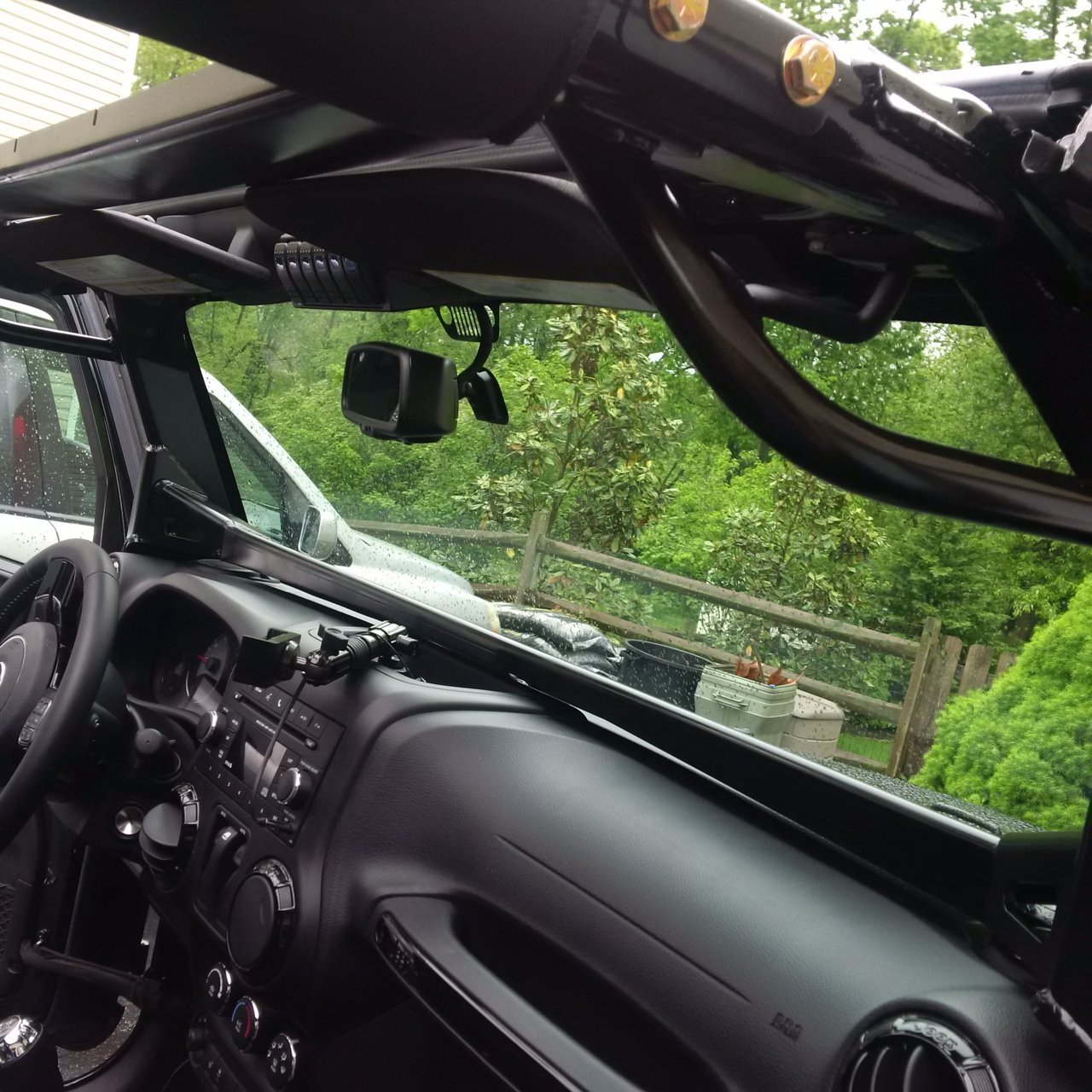

That looks pretty sharp.
Is that a stock rear view mirror? I'm guessing there's something like a backup camera in there right?

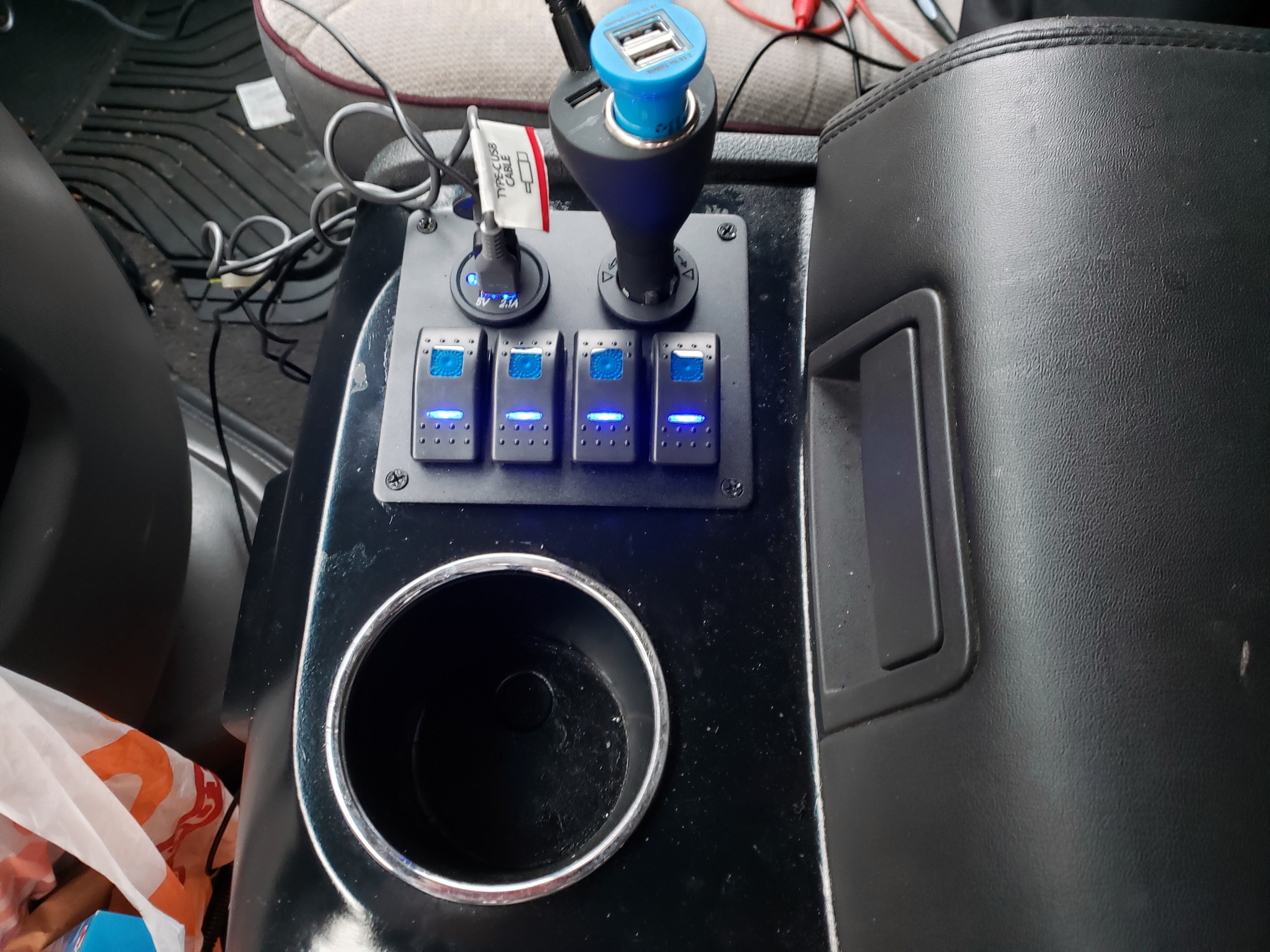

Console zoom 1.jpg This is on my other rig but what I did was get this panel from Wish.com for $10 and sacrificed a cupholder

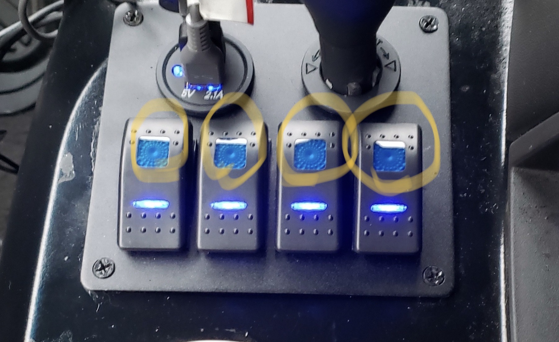

My switches came with labels, but no instructions on installation. Does the central square light lens lift up?
I think he means these
That's quite a load of switches, I have the labels just need to know how to lift up those little squares to put the labels underneath, or are they intended to apply over the lens?
Thanks aggreX, I noticed a Backup Alarm Disable dedicated switch which is just what I'd need if I ran more than a four gang switch panel. I did see those rocker parts with the custom text, pretty slick.
