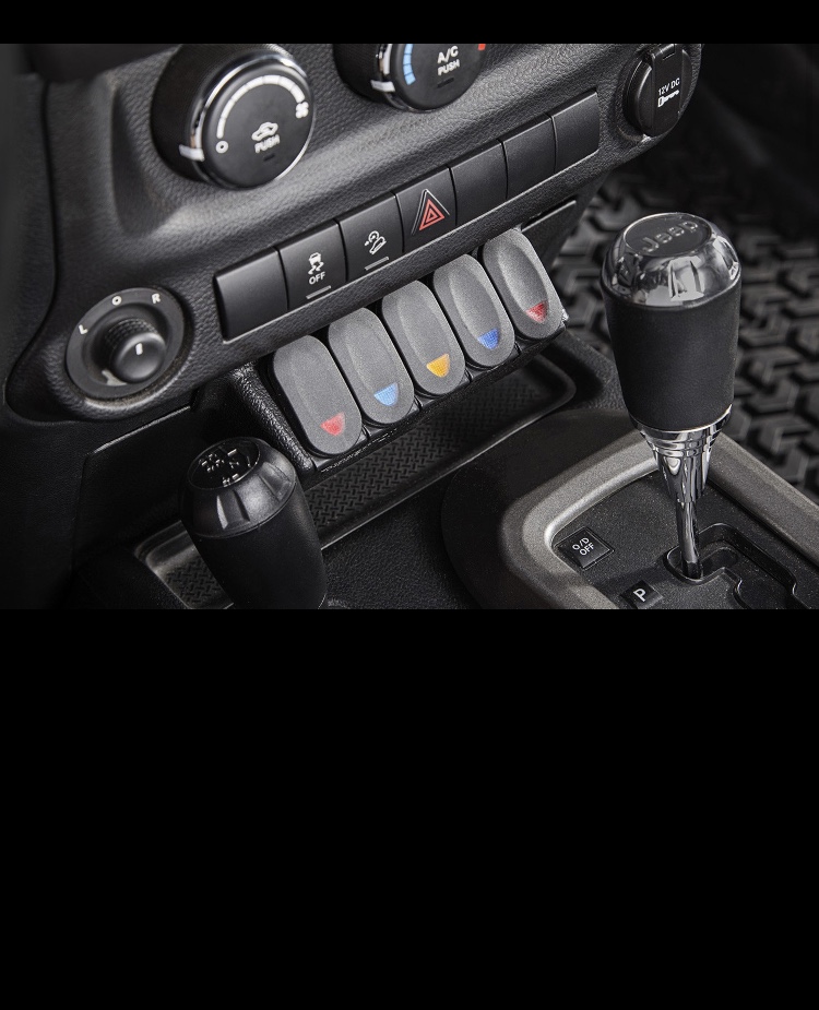

Something like these

So will those after Market switches pictured work?
what is the difference in switches?
Momentary switches are ones that circuit is normally open where no current flows. Then as long as you hold the switch on the circuit is active. If it were on a light the light would only be on while the switch is depressed. What may be needed is double pull double throw momentary switch.
Single pole or double pole switches can be off or on. Like a light switch in your house. So you would only have up or down but not both.
Doubly pull double throw rocker will allow up or down. You have to rock to the center point to stop. If left up or down the motor may burn up.
Windows operate momentarily otherwise they would be only up or down and nothing in between also you would burn the motor if left on in the on position.
Typical auxiliary switched are single pull single throw. For fog lights or on/off circuits. You would have to send the link to the switches to comment on the pic you posted.
