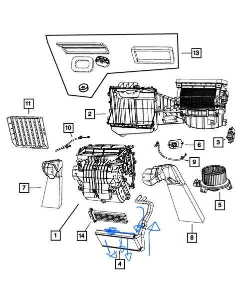

Went to change the actuator that is supposed to be under/near the steering column and there is nothing there. Not even a plug to hook it up too. Am I missing something.
The Jeep blows cold air on the drivers side.
Welcome to Jeepz.com Guiness
What year and model Jeep do you have?
Are you saying that the air never gets warm, or that you can't switch from foot to defrost?
Are all blowing cold air or just driver side?
Did you verify the heater core is not blocked or restricted?
Number 3 in this diagram has the recirculate/outside blend door.
I believe you go in through glove box opening to access. EDIT: this is not for JK. Sry see video below.
Air Conditioner and Heater Units for 2008 Jeep Wrangler | Jeep Warehouse Direct
Just the drivers side is blowing cold air. Heater core isn’t blocked
How do you know the heater core is not blocked?
Did you test it or flush it?

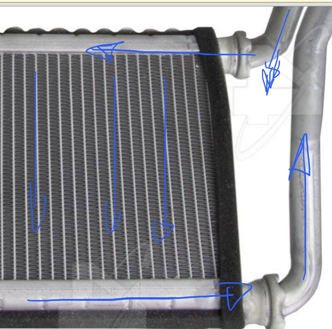

I believe the right is separate from the left in airflow through the heater core. And the core is a top down flow with entry parallel to the exit so if its going to clog sediment is likely to rest on the left(driver) side.
Also there are many threads out about casting sand clogging up the core.
I suggest crimping the rubber hoses to the core with vise grips. Disconnect the lines and back flush the core with a hose. Reconnect. Remove crimps. Burp the system and top off.
The heater core was flushed by a mechanic. Every vent is fine except the drivers side and the actuator is not there. Not even a connection for one
Well I’m out of ideas. If air comes out, just cold its not a blocked duct. Nor an core blocked from air flow. Blend doors usually effect both sides.
Air in the system or blocked core. Maybe blocked enough it needs to be replaced.
Please post back if you figure it out.

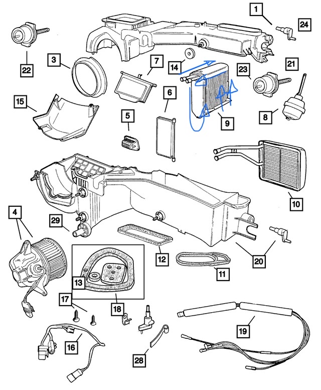

TJ larger tubes, distributed inlet, single plenum. If one tube blocked all the air is h heated by others.
JK
Small fins, longer distribution, not distributed and left right plenum. If the left (farthest from inlet)blocks only right is heated.
