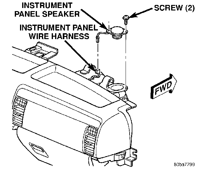

I've got some new tweeters to install, the haynes manual just says to remove the cowl with no other information. I'm not even sure if they mean the part the tweets are mounted to or the metal body part in front of the windshield. I know these blow like bubble gum, anyone removed them or have clearer instructions?
SPEAKER
REMOVAL
INSTRUMENT PANEL SPEAKER
  1. Disconnect and isolate the battery negative cable.
  2. Remove the top cover from the instrument panel. Refer to Instrument Panel Top Cover in the Removal and Installation section of Instrument Panel Systems for the procedures.
  3. Disconnect the instrument panel wire harness connector from the speaker wire harness connector Remove the two screws that secure the speaker to the top of the instrument panel.
  4. Remove the speaker from the top of instrument panel.
