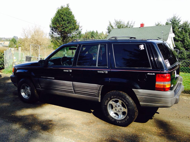

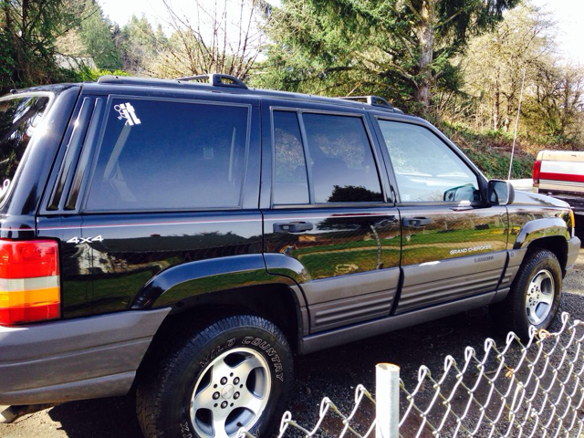

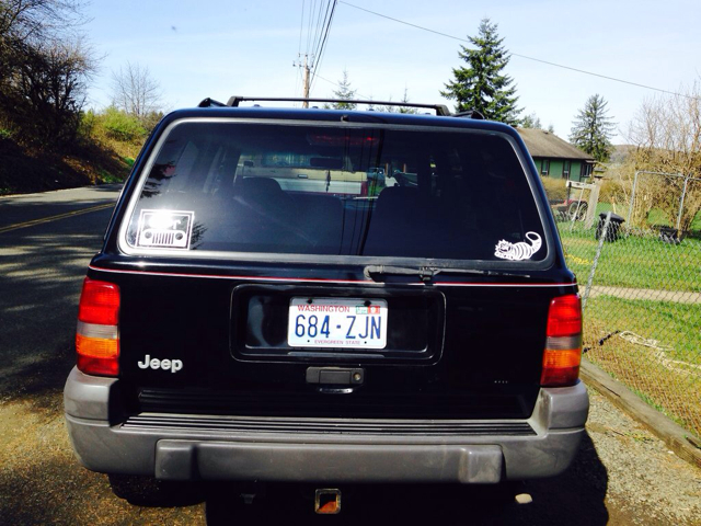

Just a few pics of her before I go to bed. Lol

Oh , she's a beauty ! Live on you beautiful ZJ ! Woman always pick the good one ! Birds of a feather I guess .
