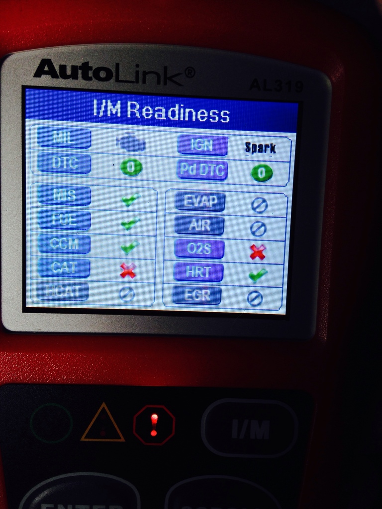

Got my scanner today. Came up with code p1391, which is crank sensor. Also has a feature that shows if things are running right. Red x is bad. Tell me if you think this means the o2 sensor on cat. Thx. ImageUploadedByTapatalk1402698827.551311.jpg

Yes , apparently the downstream O2 is out of spec. Certain to fail an emmissions test . I see you pulled a code and it's the CPS. Very popular and good for causing driveability issues and no starts. Guessing that live stream data has also shown a lazy or dead down stream O2 .
The scan tool is wonderful and eliminates guess work , all is needed are the specs which I'm sure you've obtained whether on line or repair manual. I'm holding new hopes for the reman PCM , just sorry I did not know there were issues such as the CPS and a dead O2. Glad you've got your hands on the scan tool . Proud to say your kickin' tail ! :shades:
I did a live reading with scanner while driving but it's all gibberish to me! The code is only for crank sensor so gonna replace that first. This is the coolest scanner I've ever seen, so glad I bought it! Hopefully my girl will be running properly tomorrow. My set of 12" kenwood subs miss me! Lol. Do you think the bad crank sensor could cause a faulty o2 reading? If not, I have the DS o2 on hand. :)

I do dig your new scan tool to the point I'm jealous. Will have to break down and score one ( maybe the auto x-Ray) and stop grubbing my brothers actron. The crank sensor and o2 are not associated in that fashion although causing nasty driveability issues. The CPS makes for hard/no starts and while not functioning right , cannot correctly time spark and electronic injection. I would do the CPS ans see how she runs since the down stream o2 does not contribute to engine management in the way of fuel trim , it just gives the emmissions reading for the inspection.
That can be dealt with later. As you've stated , live data would be jibberish without the specs table to know what's within range and what isn't. I believe the CPS is read and expressed in voltage but the table within the scan tool will confirm that and a table from a repair manual will have the specifications range. But yeah , I'd go after the CPS first as it is what tells the PCM the position of the number one piston position helping toward spark and injection firing order .

Heck yes! I love this Jeep and am ready to scrub the pollen off and cruise while bumpin my tunes! Great info, will replace cos tomorrow and cross my fingers and toes! My scanner is an autel AL319. I got it on eBay for $30. At walmart, they're $75. Will update tomorrow...hopefully while grinning ear to ear! Thanks for all the support!

I regret neglecting to mention an item also worthy to check as well. So sorry. It is the camshaft position sensor or possibly by another name such as sync signal generator. It feeds back to the PCM similar data as the CPS does . A CPS will help the engine start and a CMP will help the engine after start , basically. For our purposes , we need both to be in working order. A CMP can be simply checked with a volt meter , engine off and harness disconnected and probed while cranking engine . An on - off but steady reading should be suffice . You can also check if live stream data is available on your newly acquired scan tool . If so , that will speed things up nicely!
We used to have a k5 too and loved it! That sync signal is part if the switch plate in the distributor? When I looked it up, it showed that anyway, but was calling the switch plate a CPS. If that's the case, it was already replaced. Still waiting for someone to fix it. Gahhh! Getting anxious! lol. Patience isn't my strong suit!

Ok, looks like we got it! Replaced the CPS and didn't make a difference except it stopped throwing a code. Put a new downstream o2 sensor in and it runs perfectly now!! Let's just hope it stays that way. Will be replacing upstream o2 sensor soon. Thanks for all the help. So happy to have my girl purring again!
