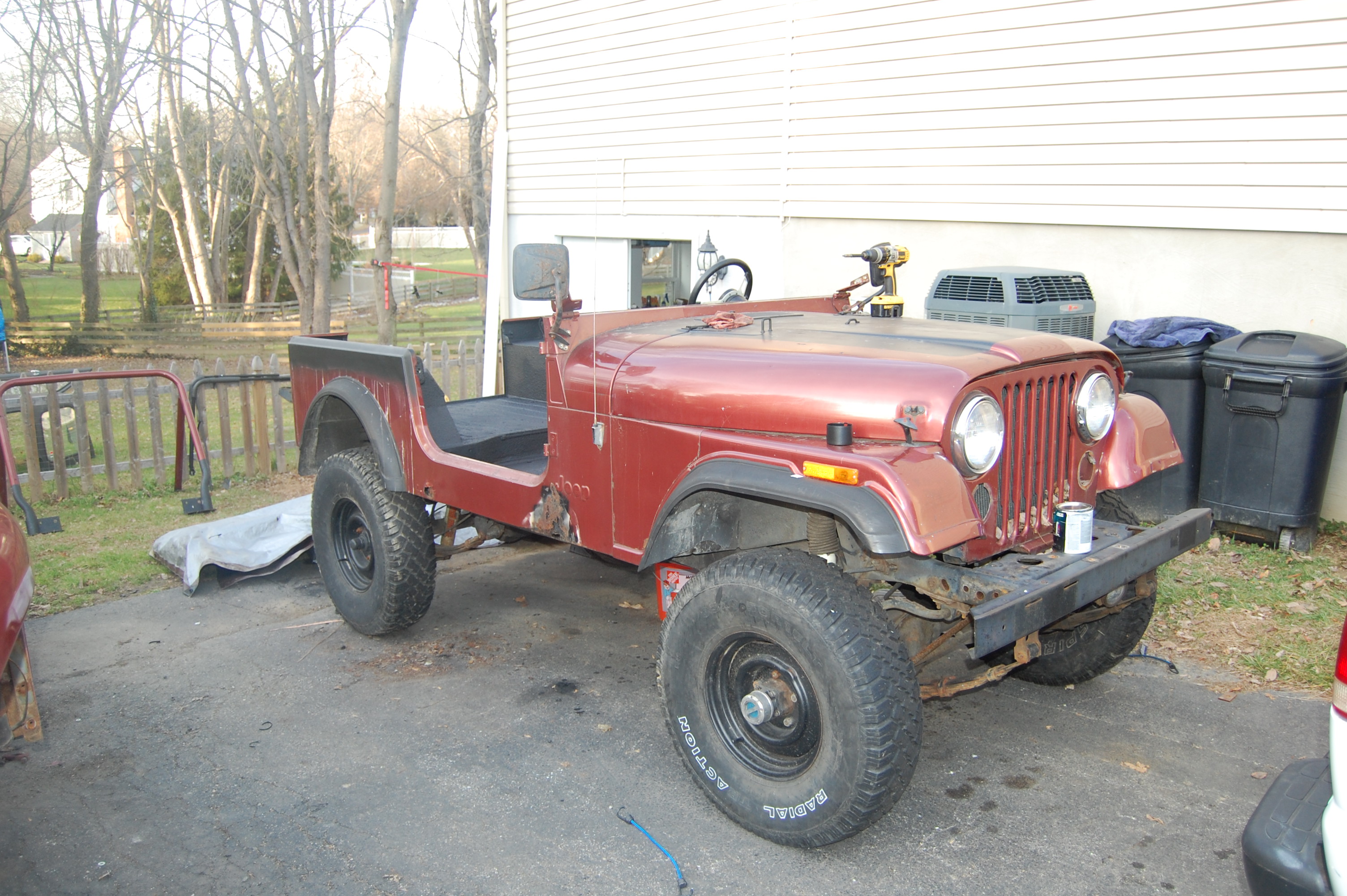

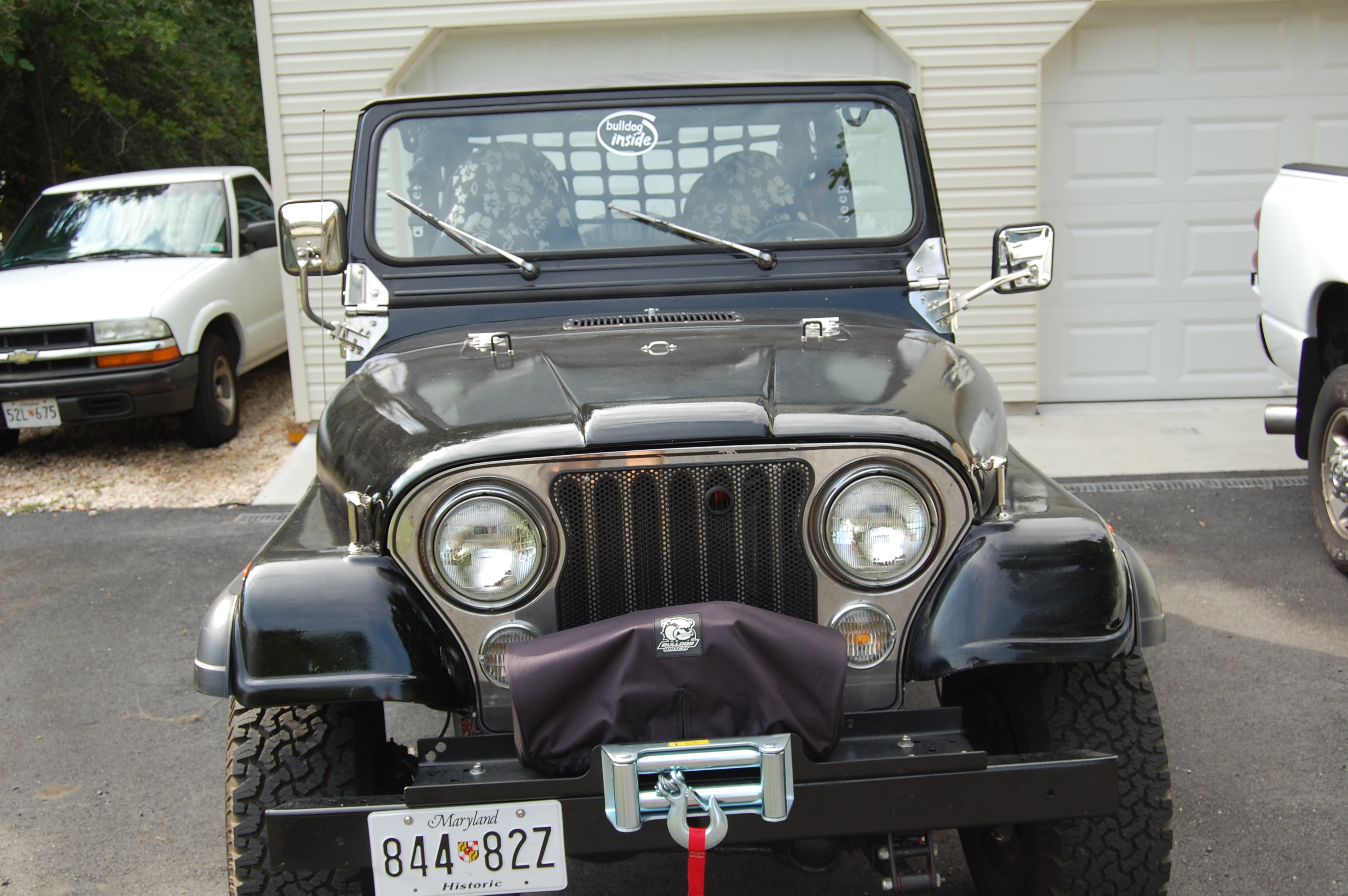

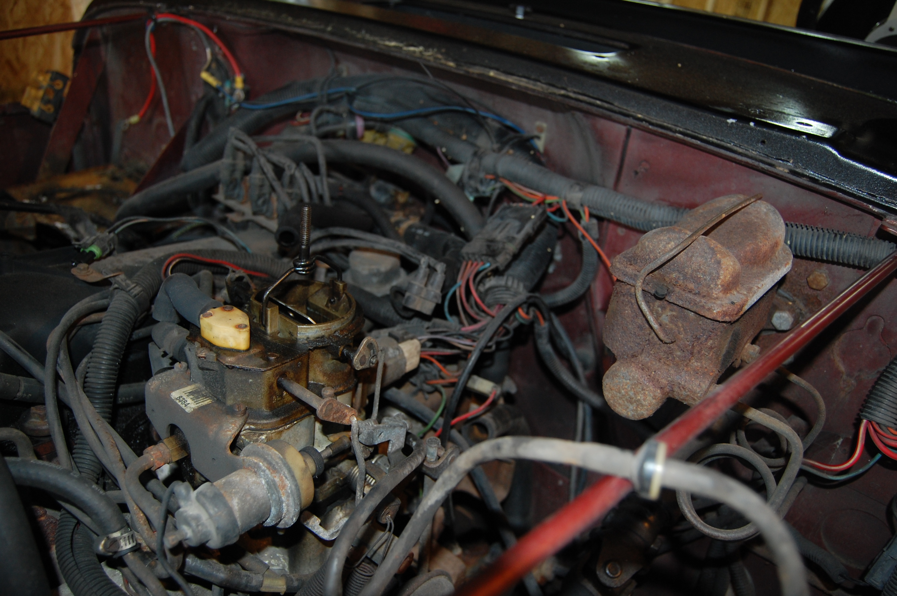

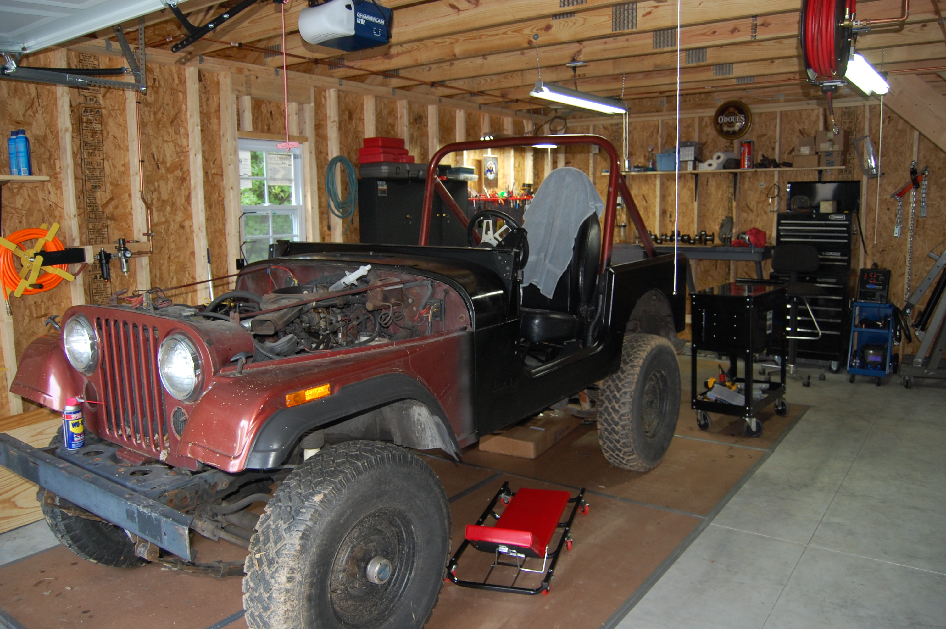

I've been busy with my restoration project of what started life as a 1986 CJ7 Laredo. I figured I'd take a few minutes and upload some photos. It's hard to tell by the starting photos but the two owners before me loved this Jeep. 27 years of use, storage and for the past few years use as a farm truck just started to catch up with it. Once I started tearing it down, it was obvious that the other guys did what they could to preserve the Jeep. This was originally going to be a graduation gift for my 18 year old, but he prefers my old Chevy pickup.....Go figure? So I was going to just do some repairs,re-paint, etc so he could use it, but after finding that a CJ7 is not his style, I decided to do a frame off resto/mod to it. Most of the original Laredo equipment had been replaced or upgraded (not sure if that the right term?) by the PO's. I will restore it to something between a base CJ and a Laredo. Would you believe that this Jeep had the OEM hardtop still on it and it had never been removed?It's true!

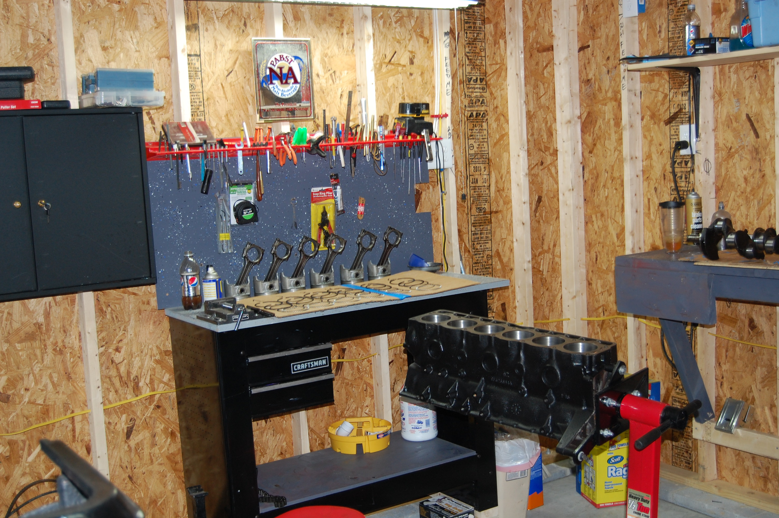

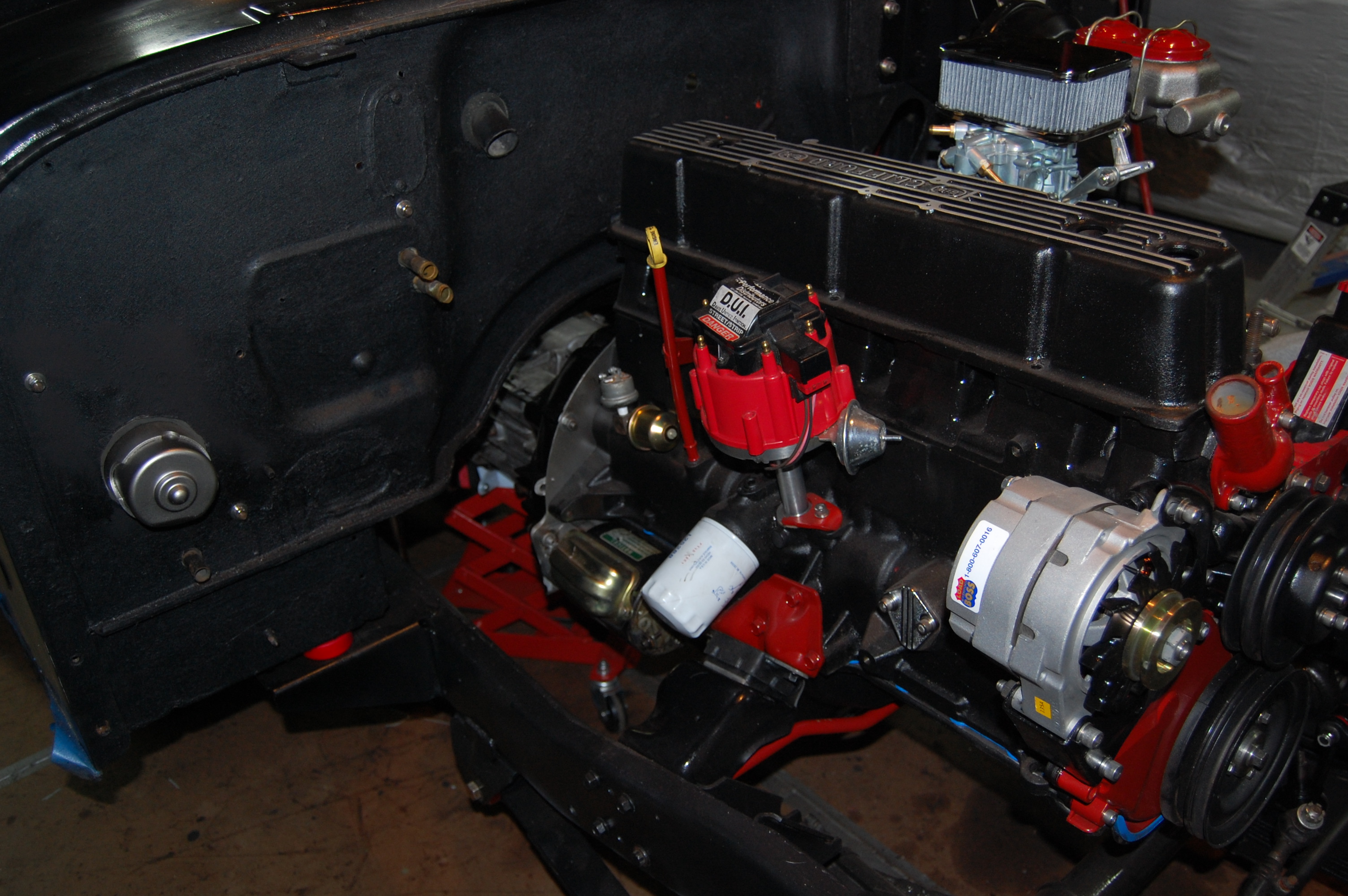

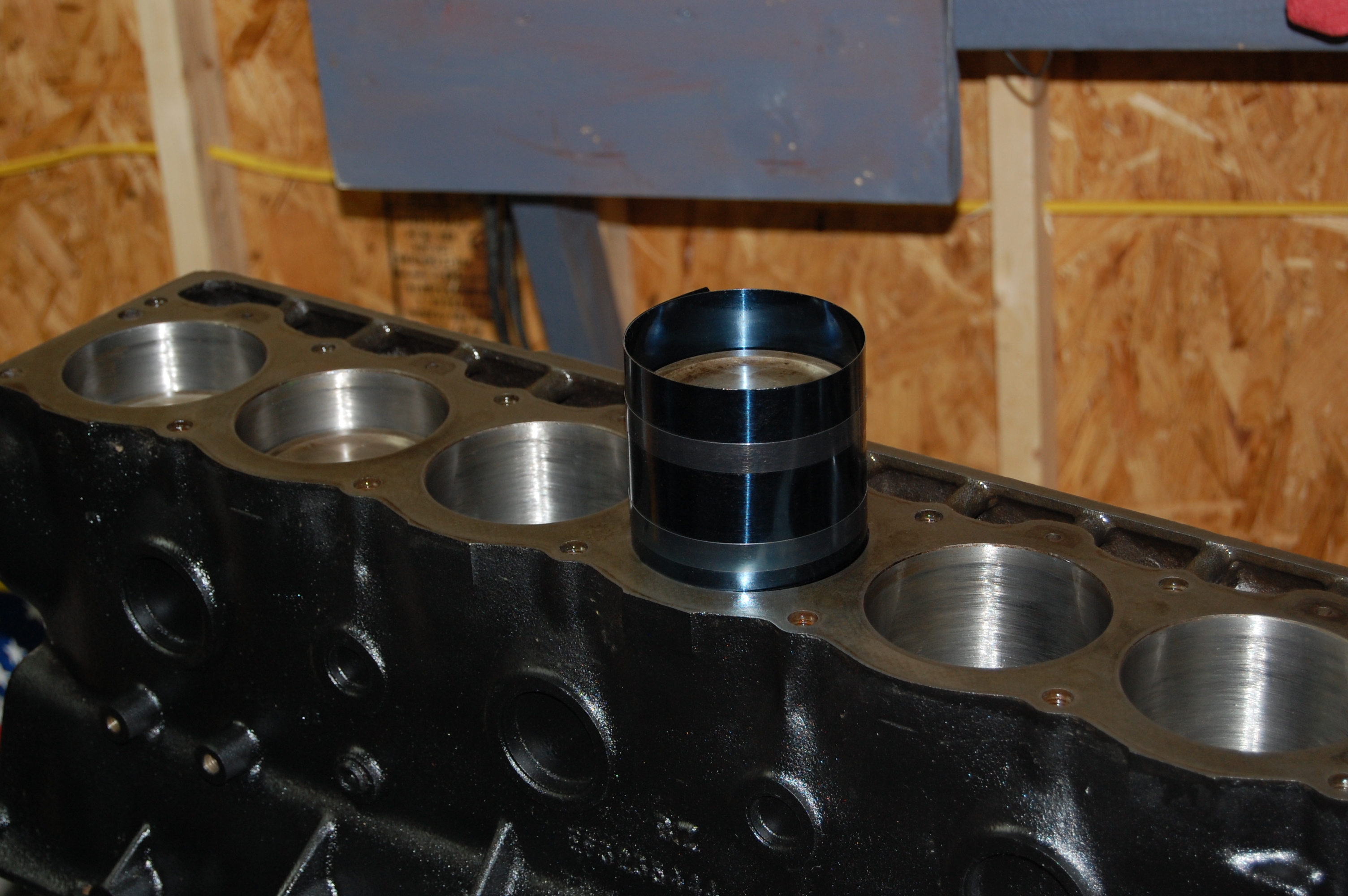

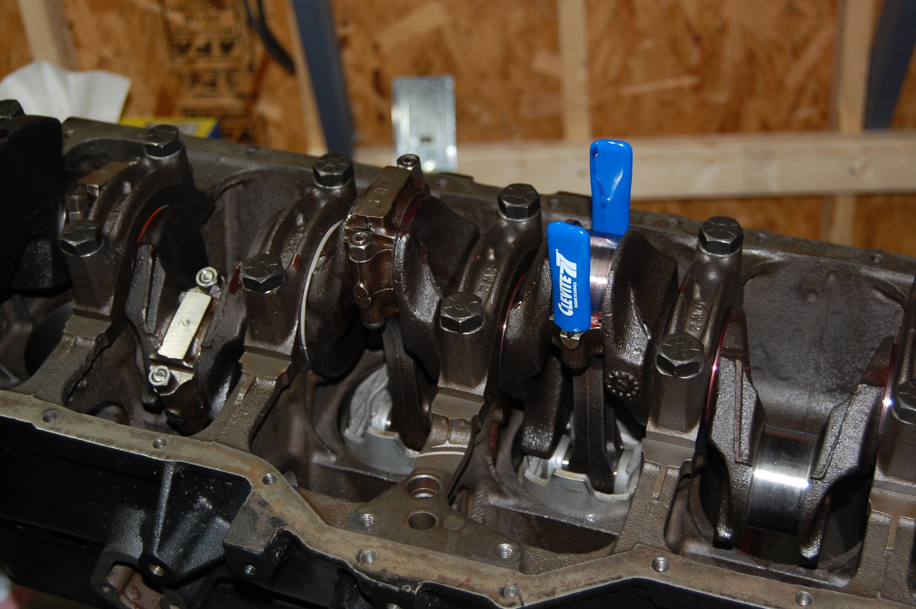

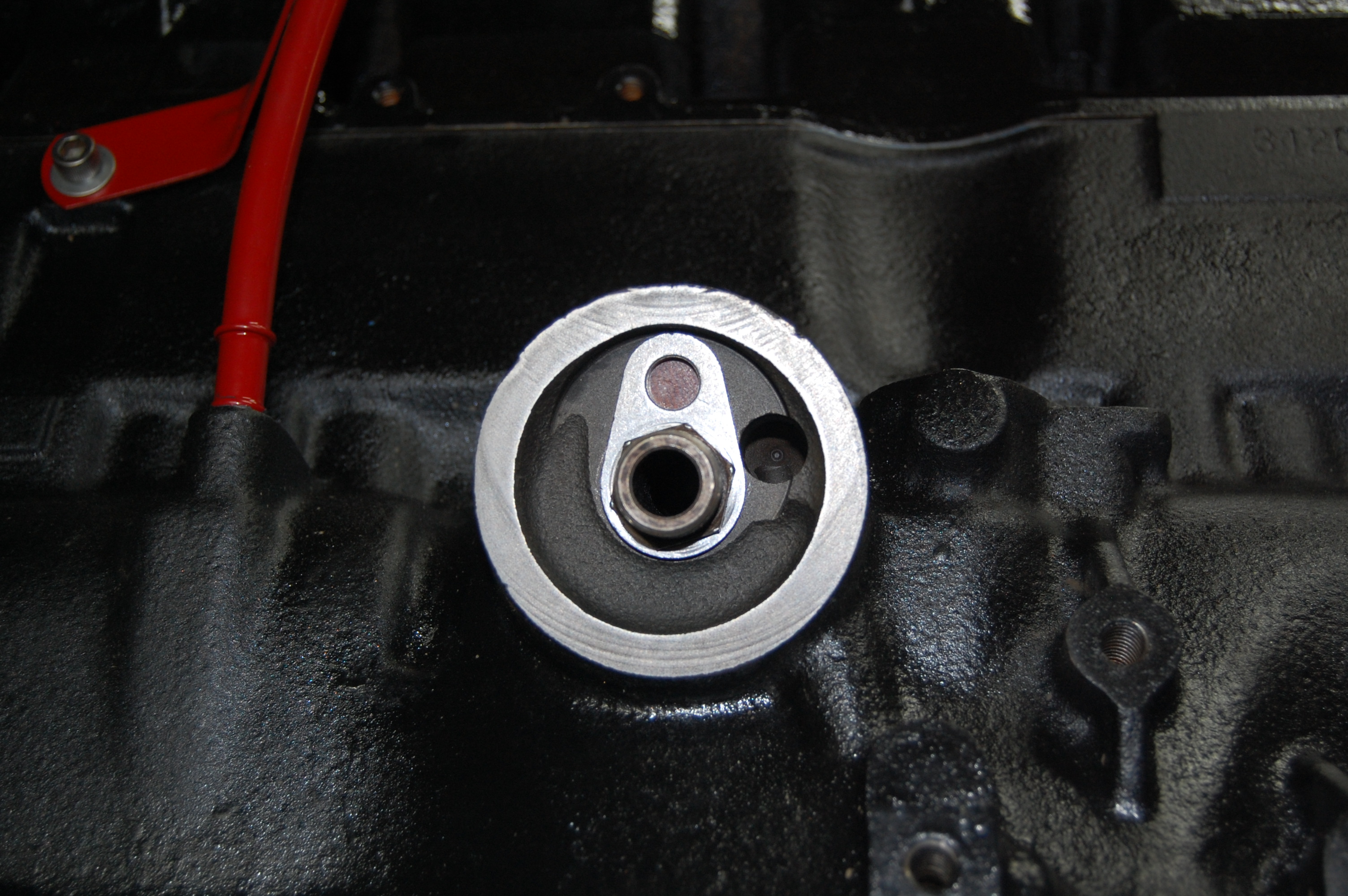

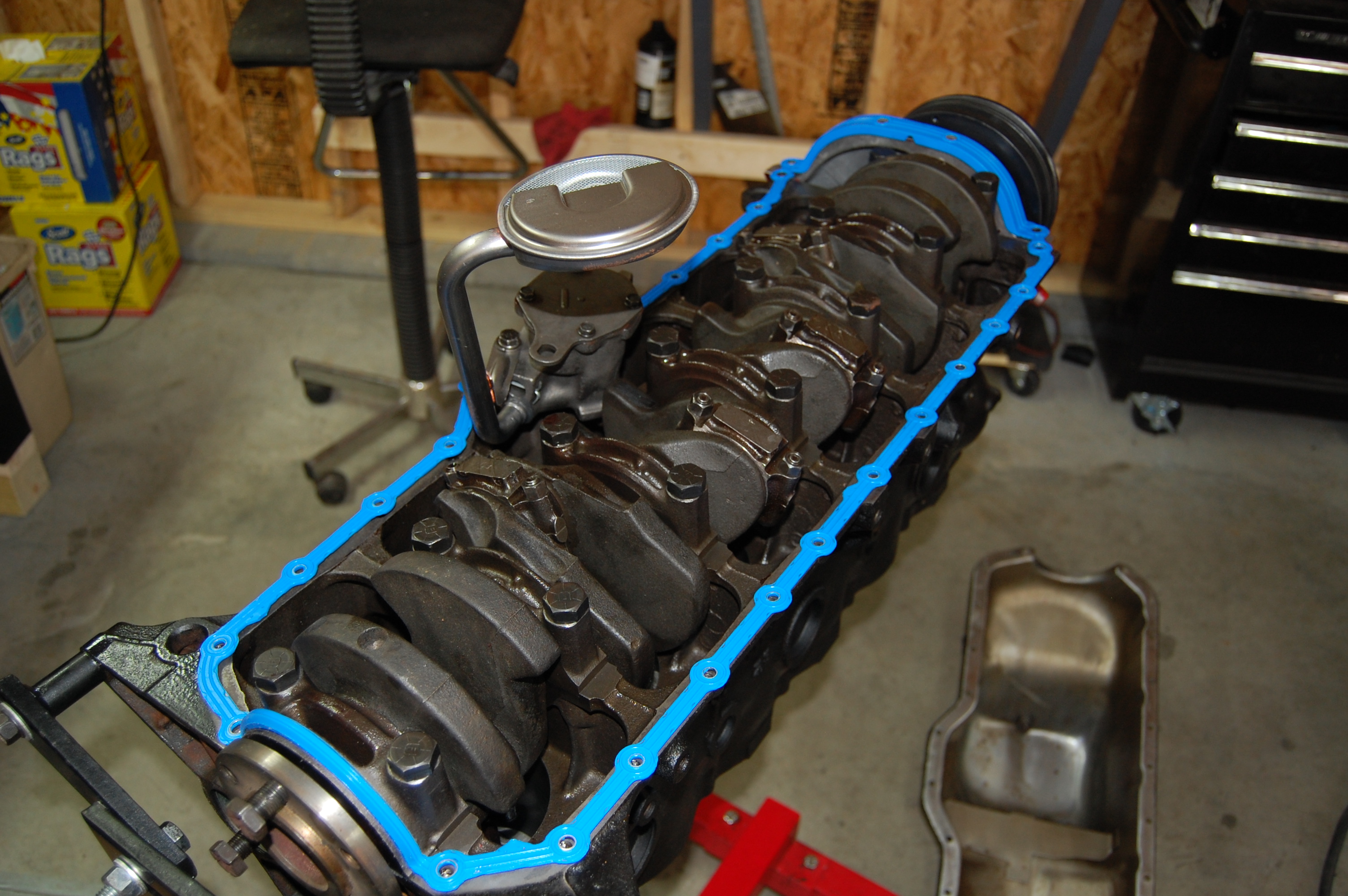

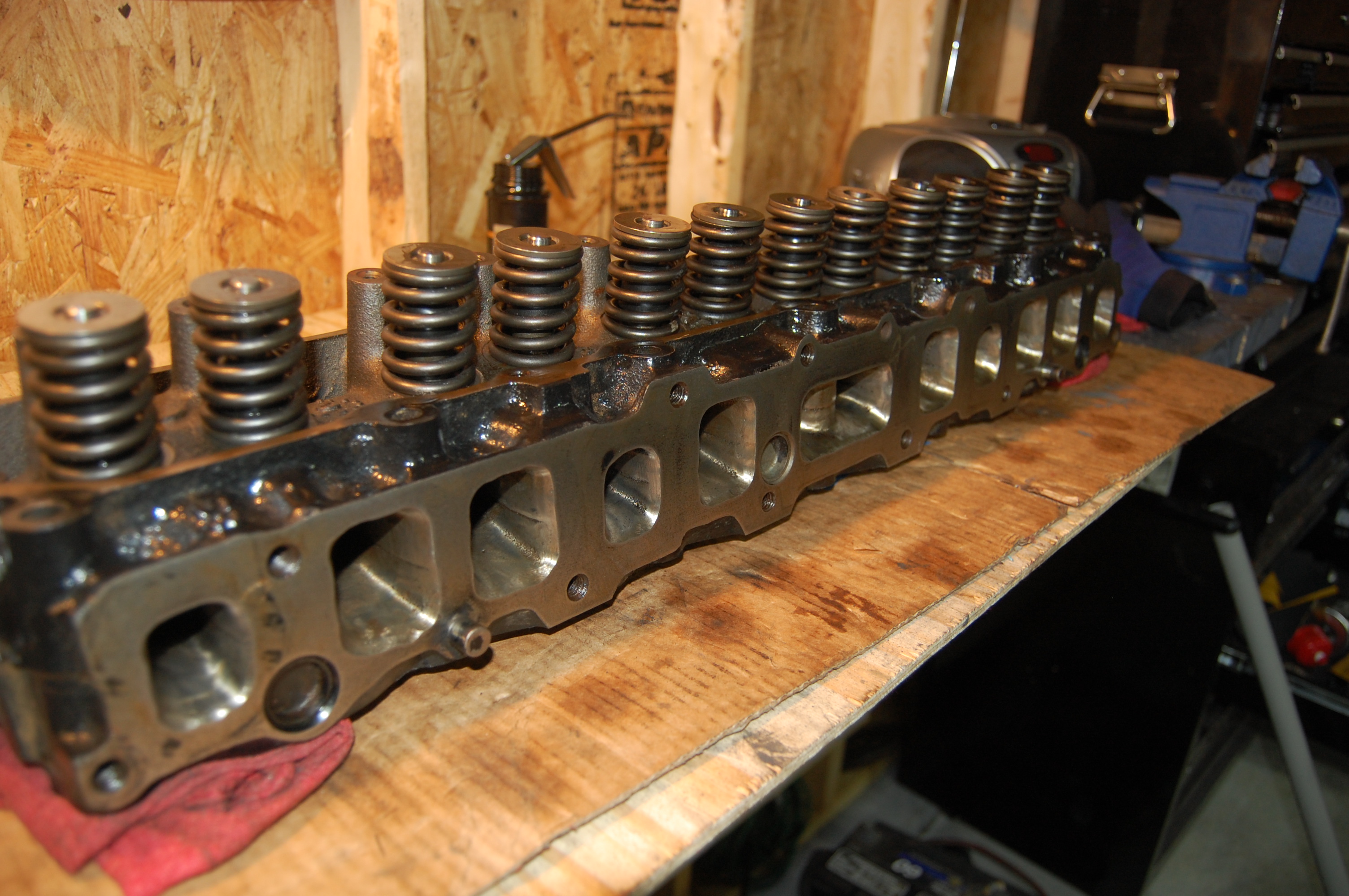

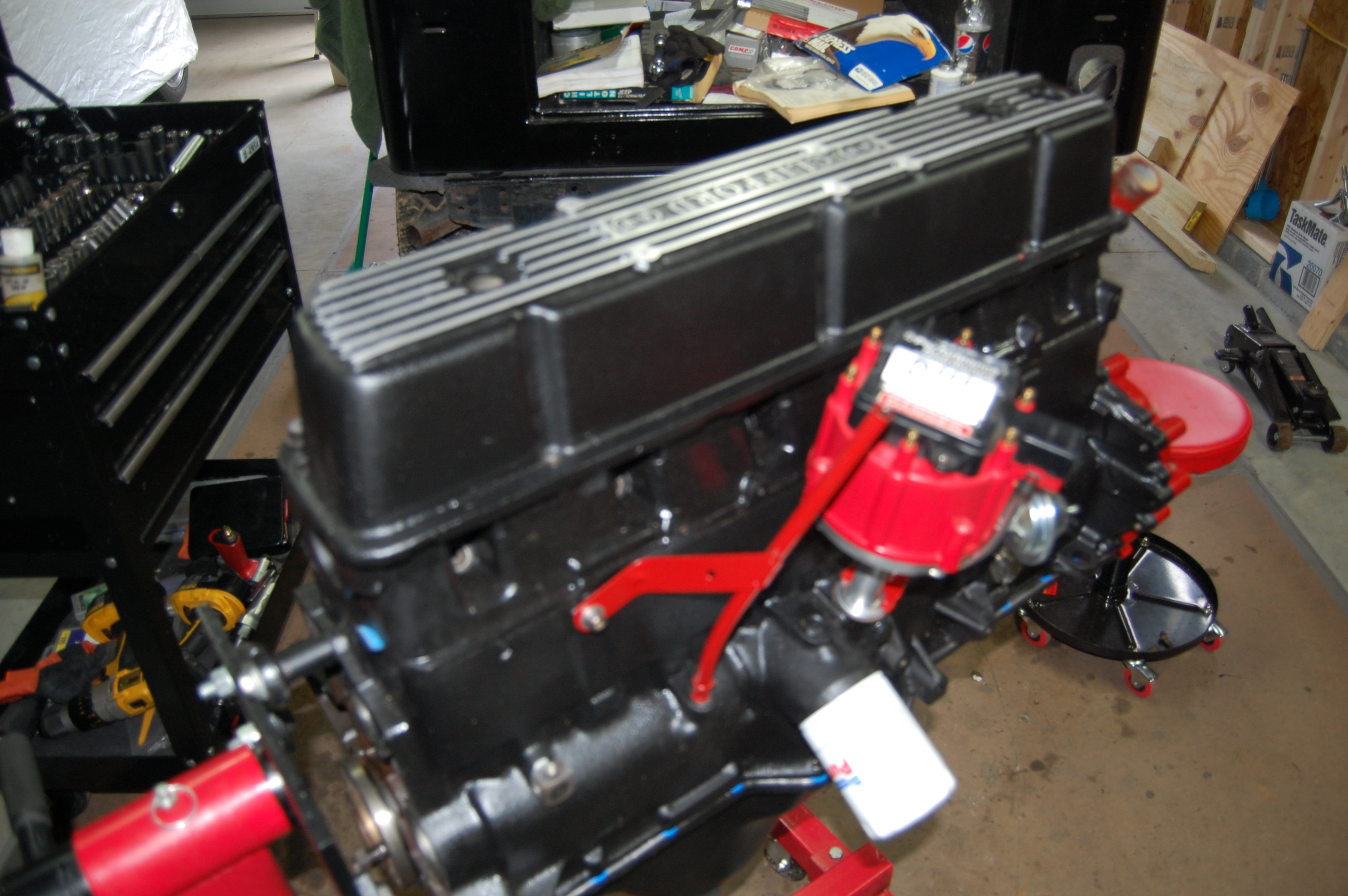

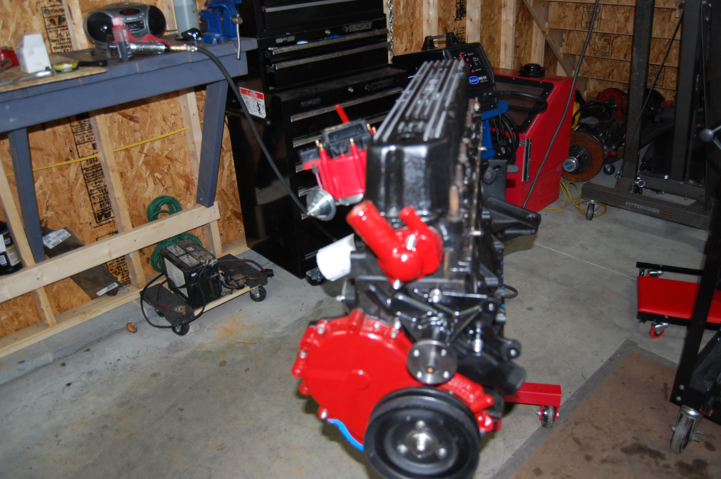

I started with rebuilding a 258 for it, the original ran fine but had ~ 120,000 miles on it. I did not go with a crate engine, I choose to rebuild this one the way I wanted. It's .040 over with a Crane cam, HEI and I fully ported the heads. The remaining long block parts are stock equivalents.It will eventually have a Clifford intake, Borla headers and a Weber 38/38.
In the last photo you can see the AMC designed oil bypass inside the oil filter galley. It was a real challenge tracking those parts down! When Chrysler bought out AMC, the 87 (87-90?) Wrangler had a 258 but they did away with the built in bypass and used an integrated filter. The person I bought this block from must have figured it was optional???? He did not re-install it during the previous rebuild. The crank was galled and torn up from the oil circulating without going through the filter. My hats off to Moses Ludel, in his book (Jeep Rebuilds Manual, I think?) he outlined the important of this bypass.

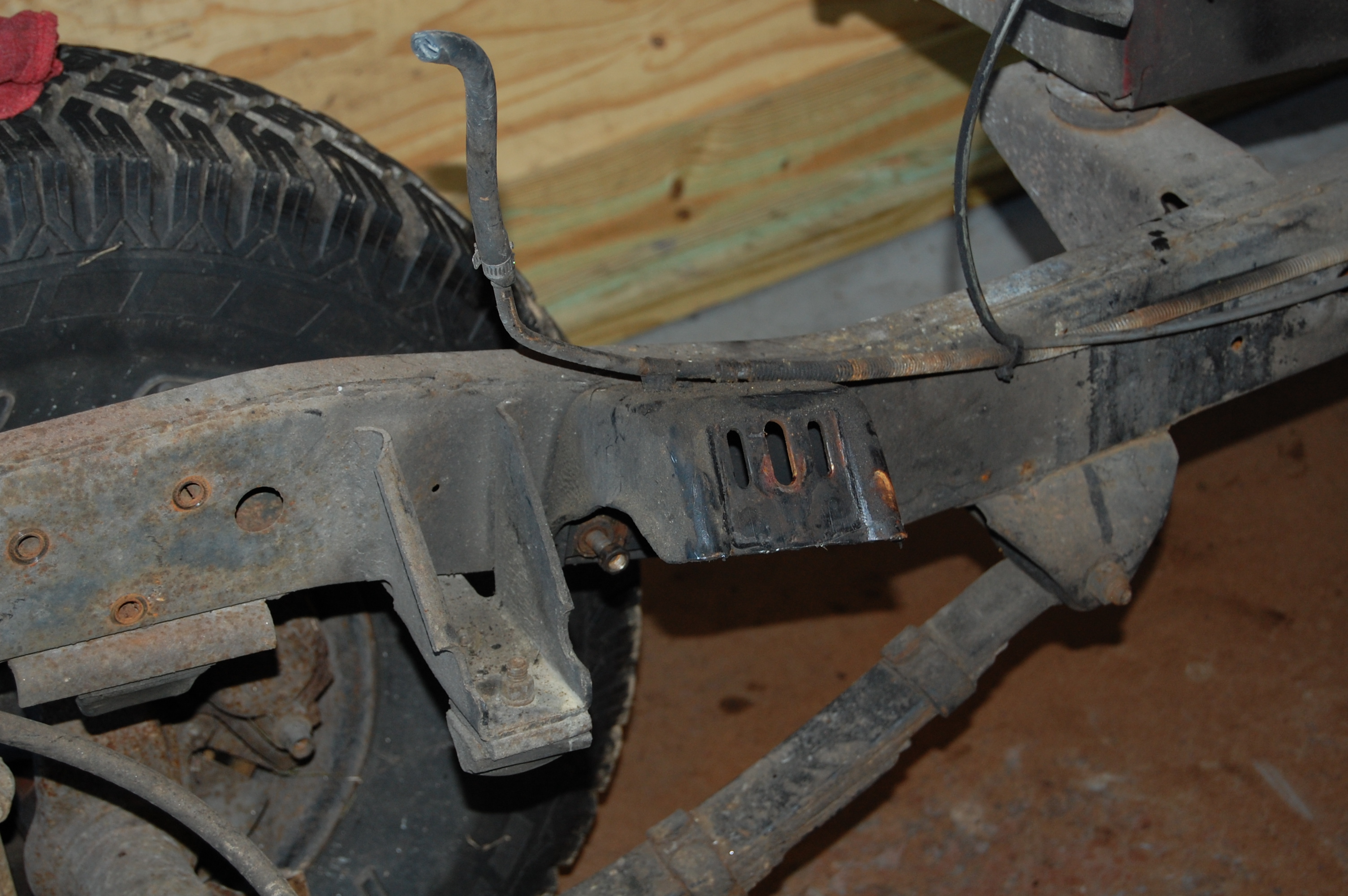

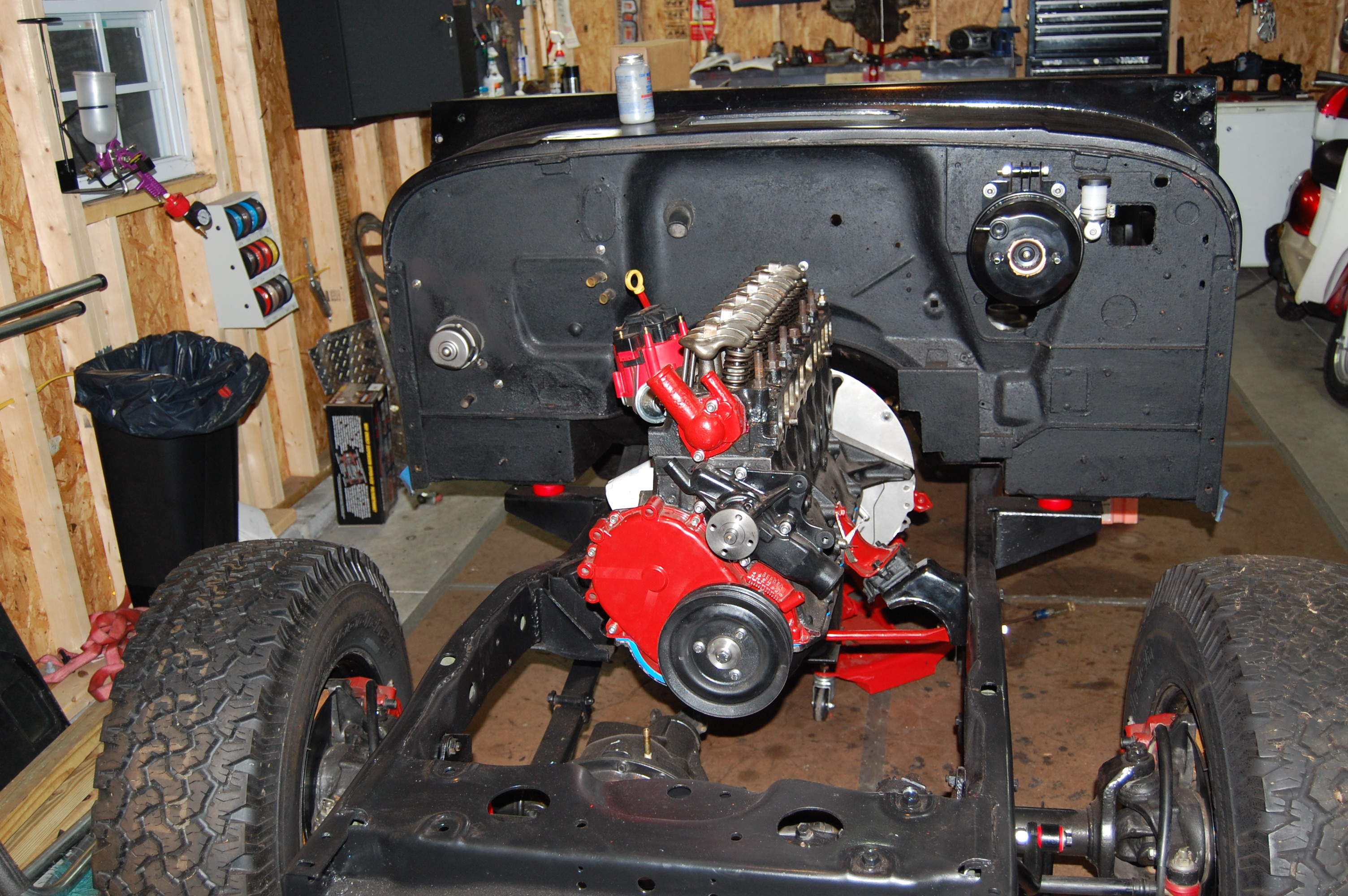

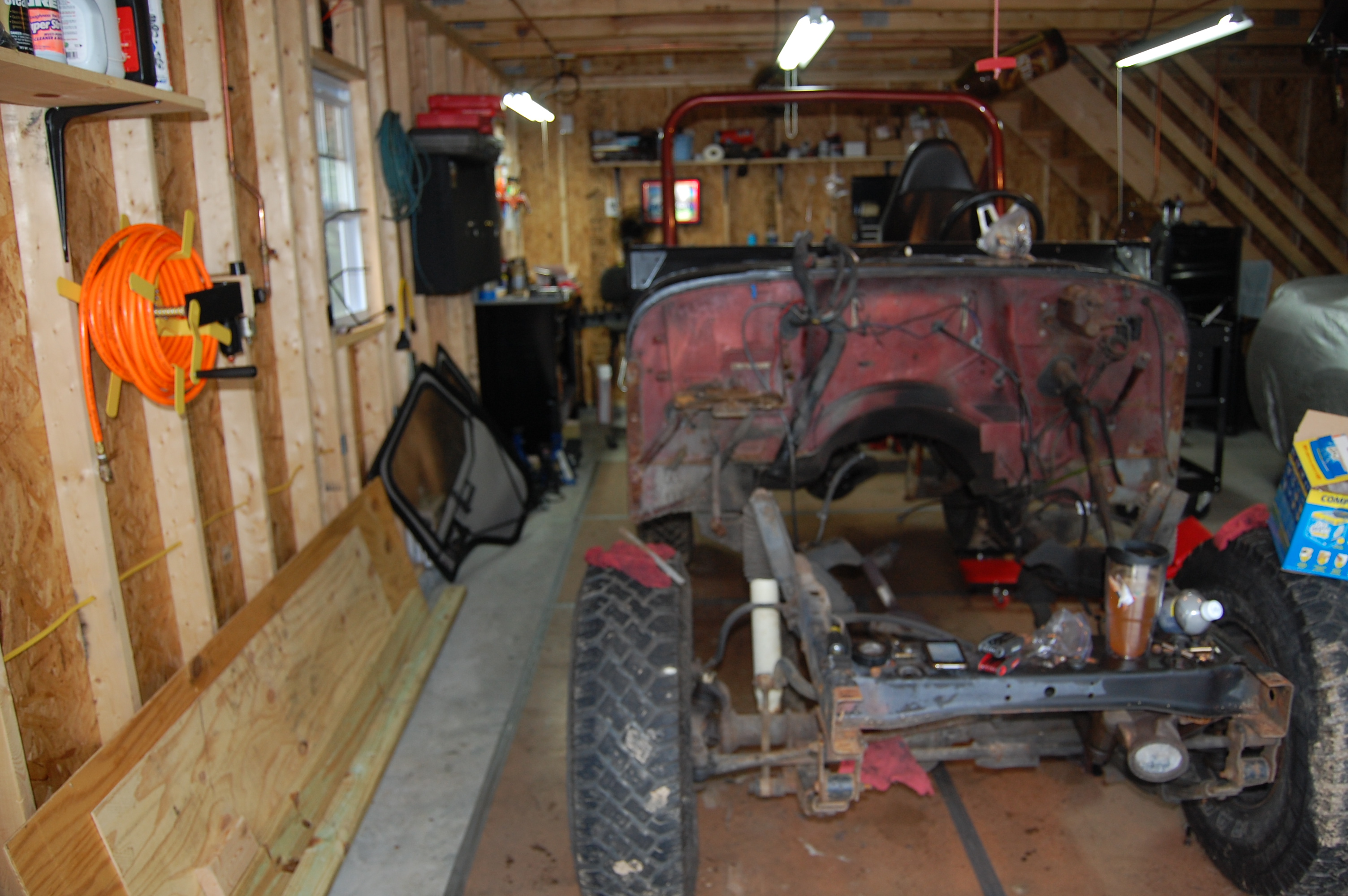

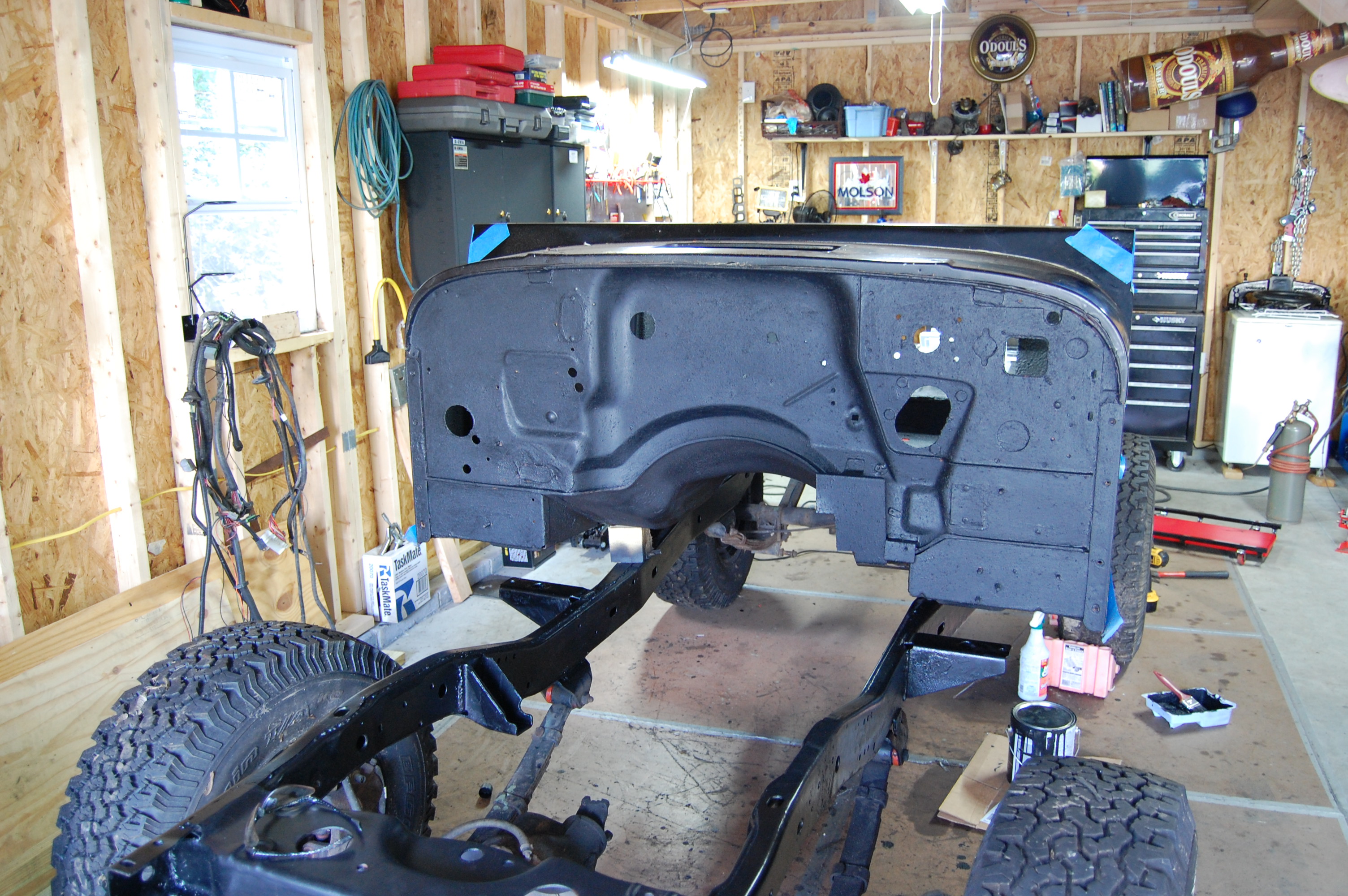

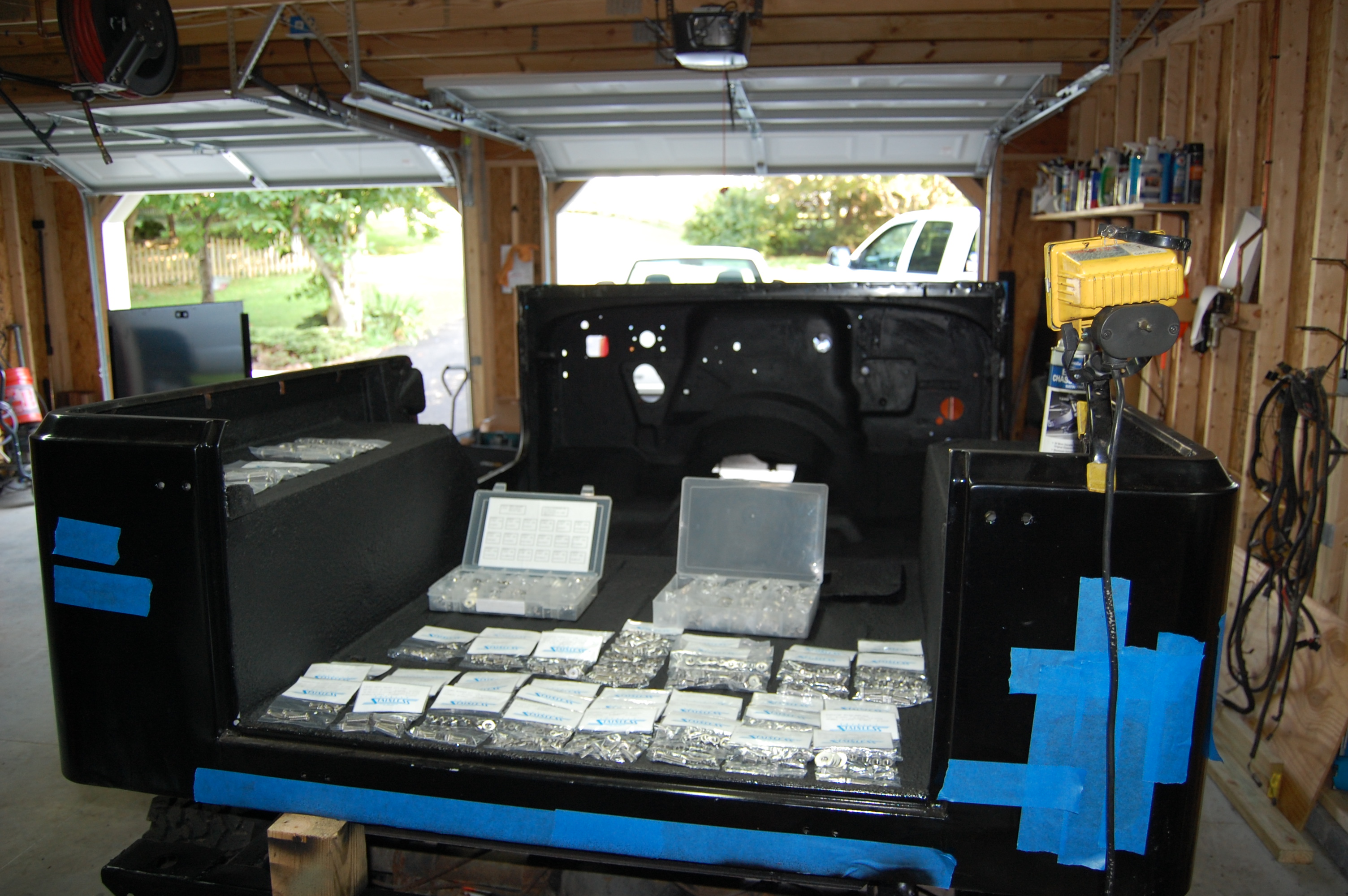

At this stage, I have removed everything from the chassis. The tub has had some repairs to it, the firewall, fender wells and area under the dash have been coated with bedliner as well. The under-carriage seams have been sealed and fully undercoated. The frame needed to have two of the body mounts replaced and two needed to be repaired, rust treated and top coated; all in all neither the frame or tub where in bad shape. There really is no original surface that has not been treated and recoated at this point (special thanks to the Eastwood Company!). In the last photo you can see that I have laid out all of my new hardware in the bed...... Re-assembly begins. I choose to invest in all stainless steel hardware (courtesy of Totally Stainless).

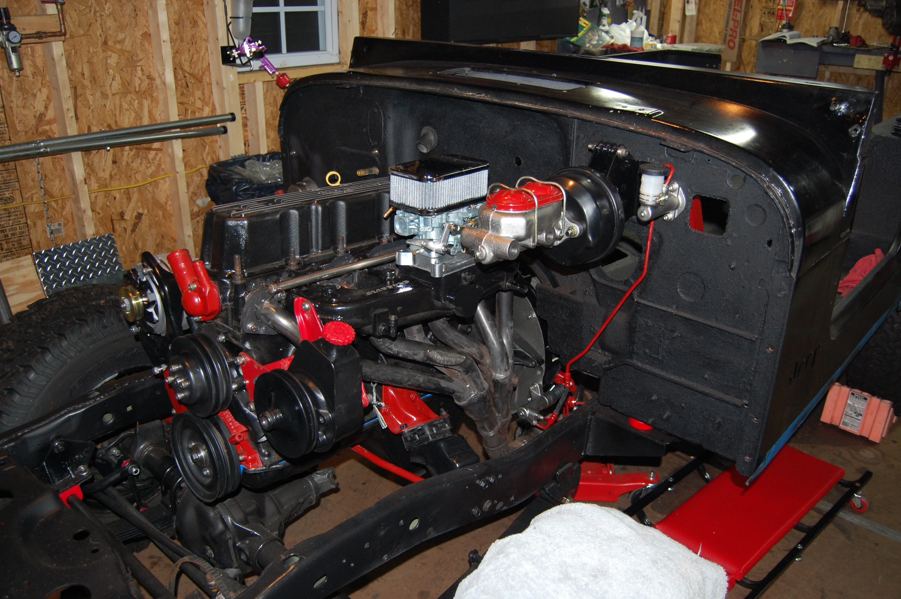

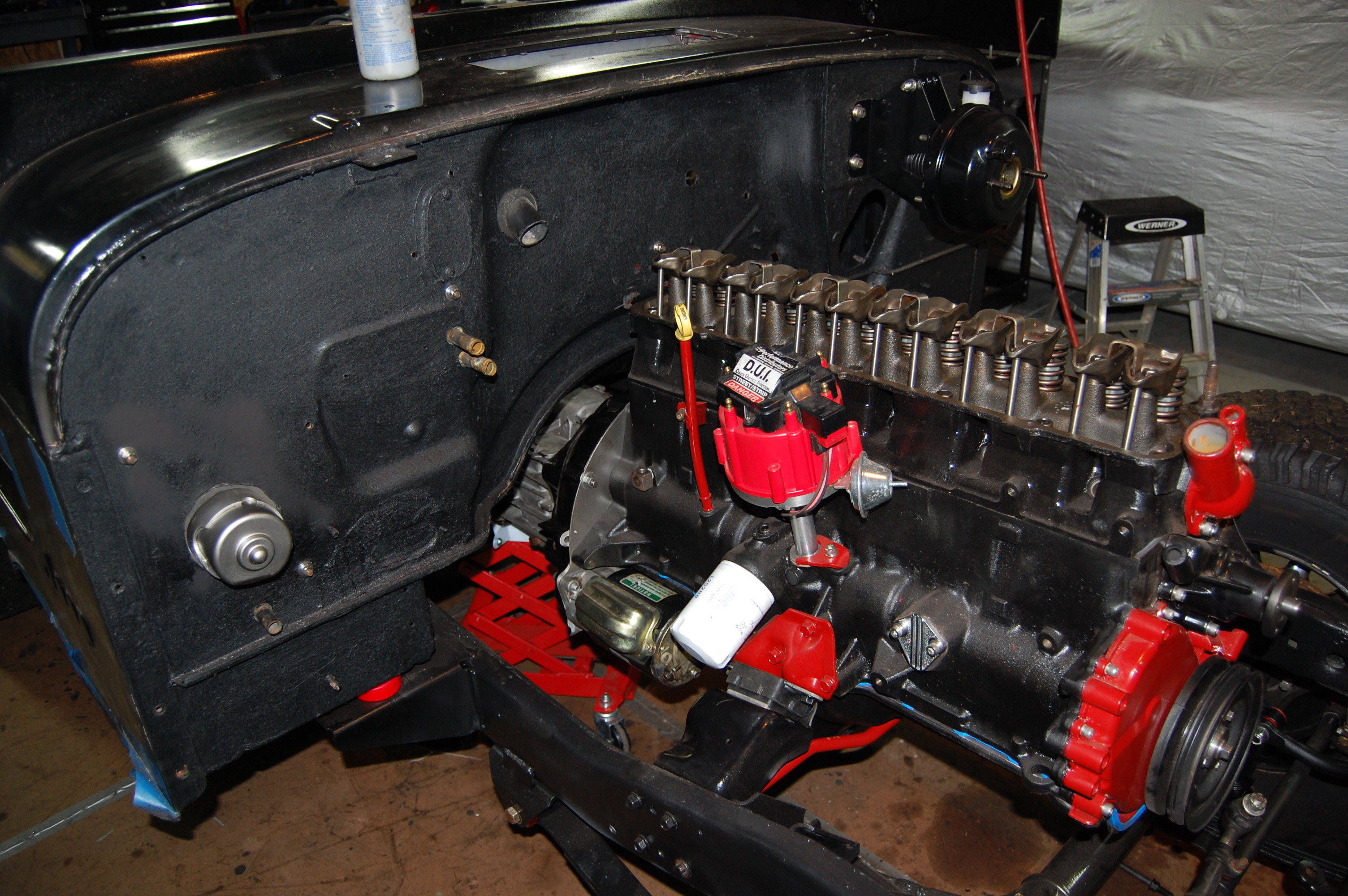

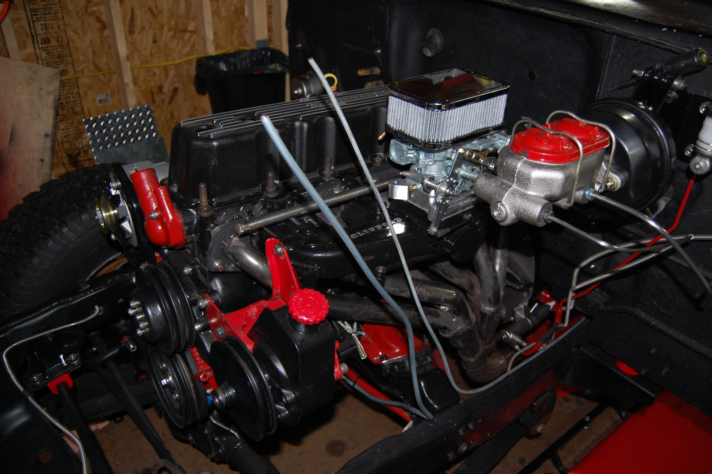

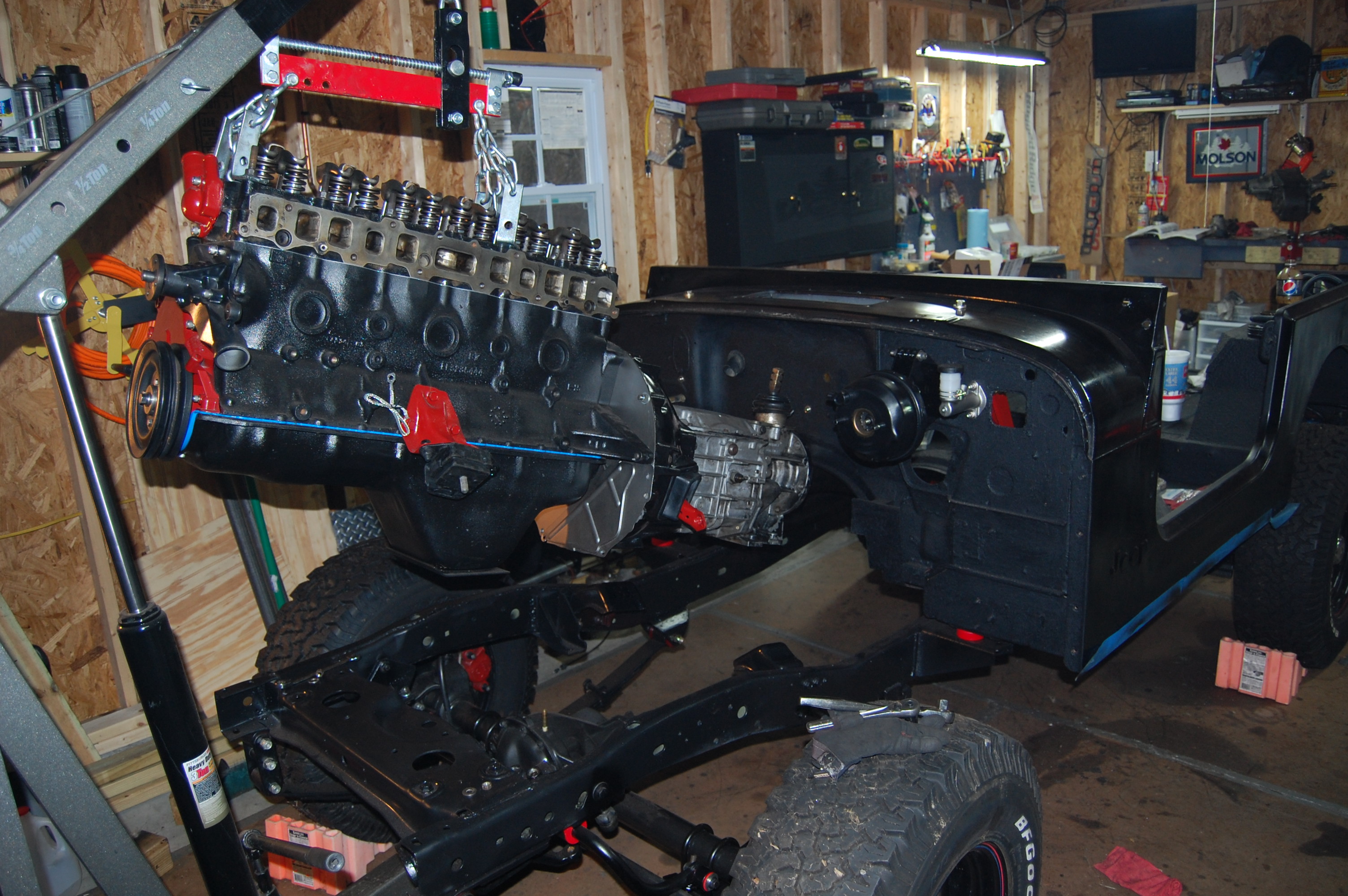

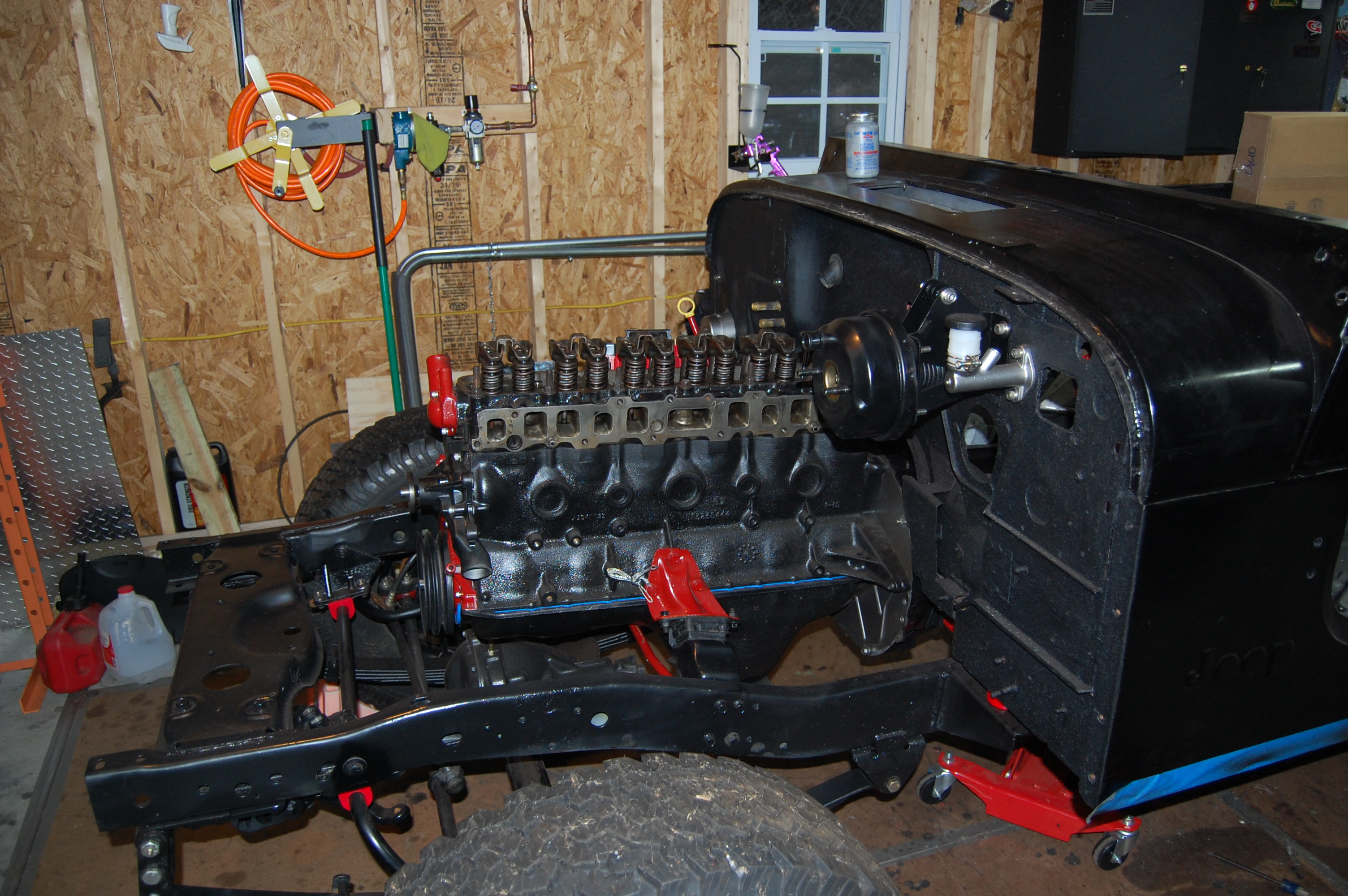

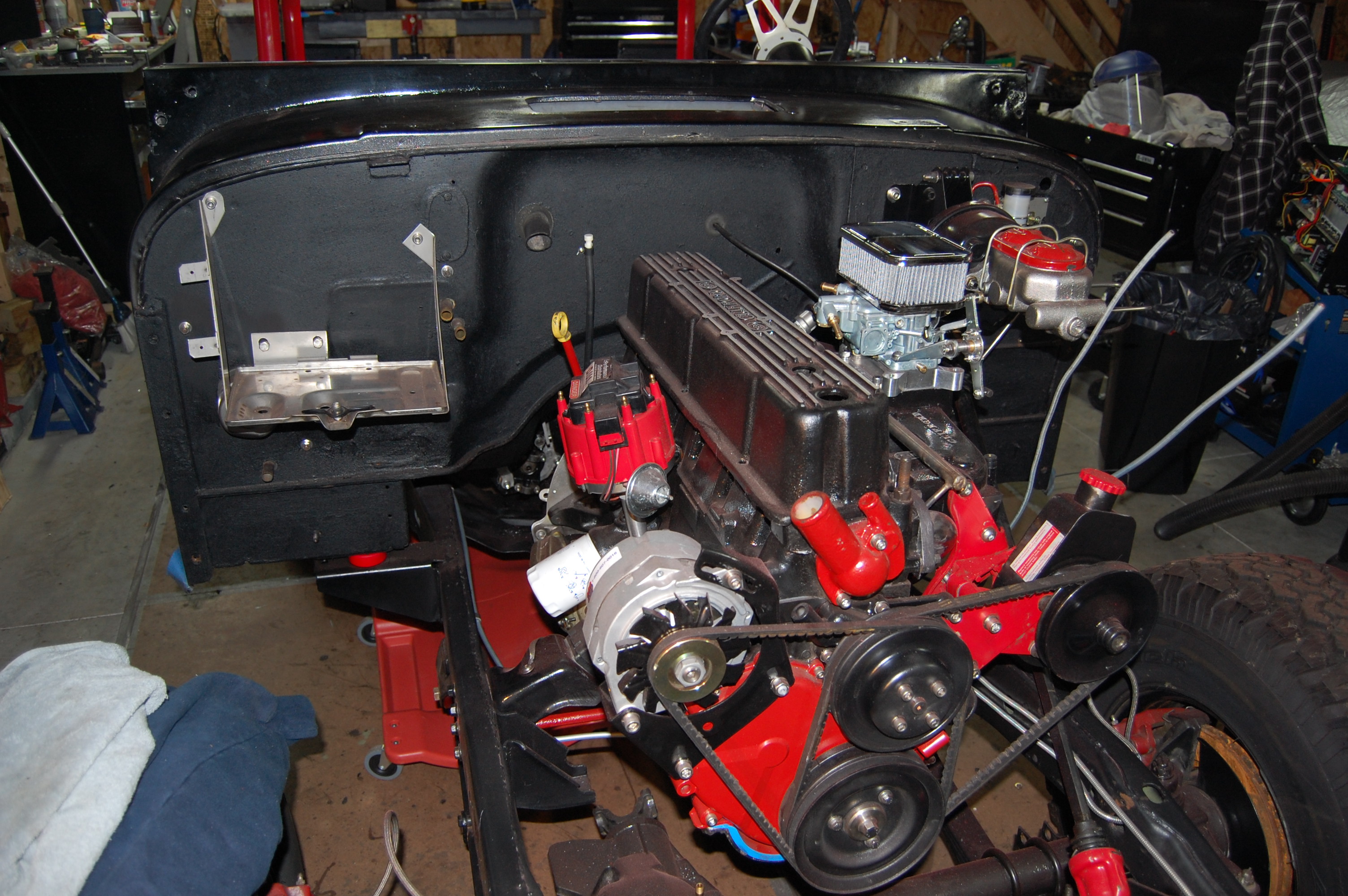

So, I had a (second one for me) rotator cuff surgery and I'm about 14 weeks post op. Starting to get some use of my right arm/shoulder back so I've been working on my build. This past weekend I got the engine/trans installed, the hyd. clutch installed, brake booster and heater pellium put back in.

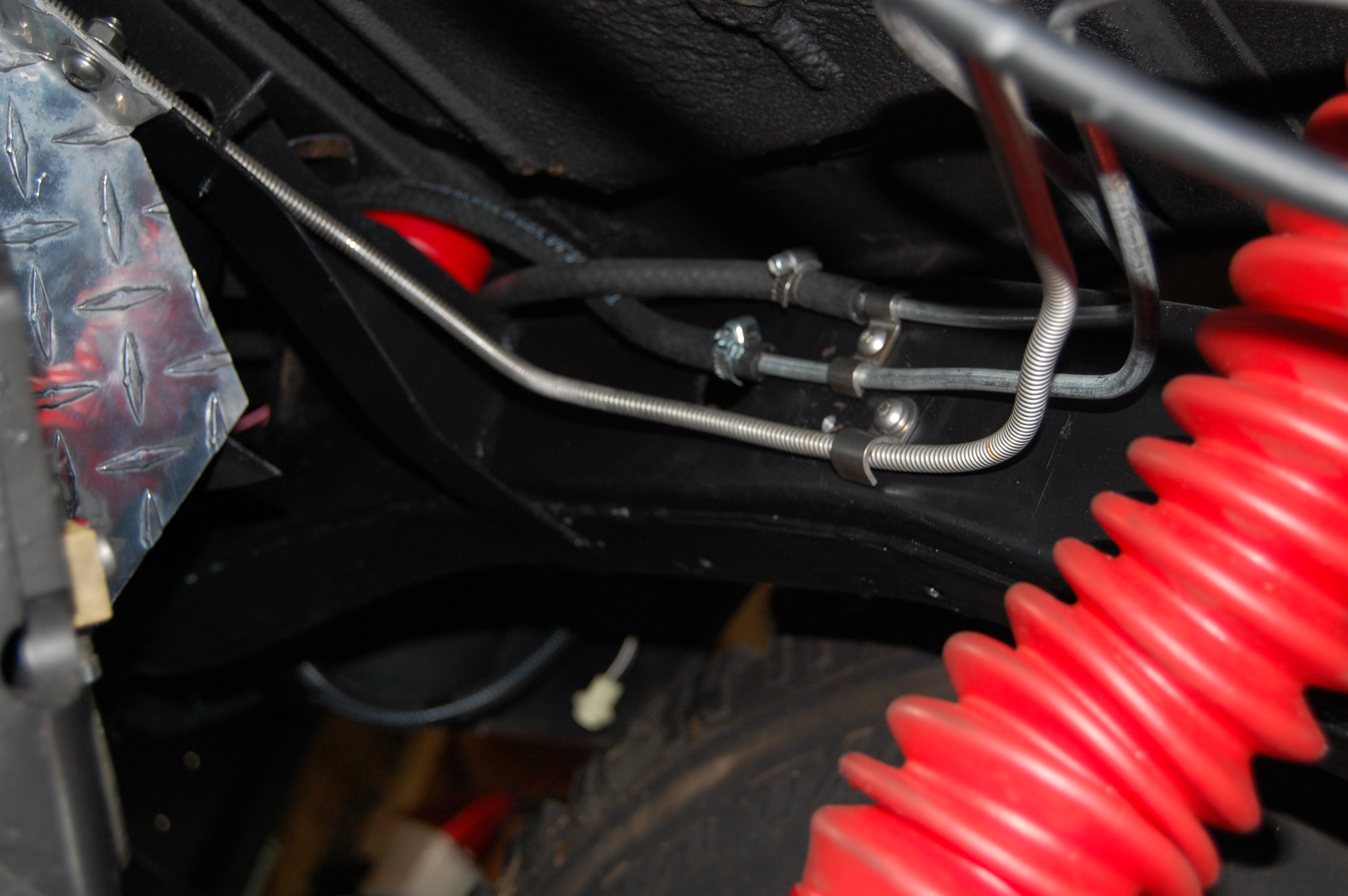

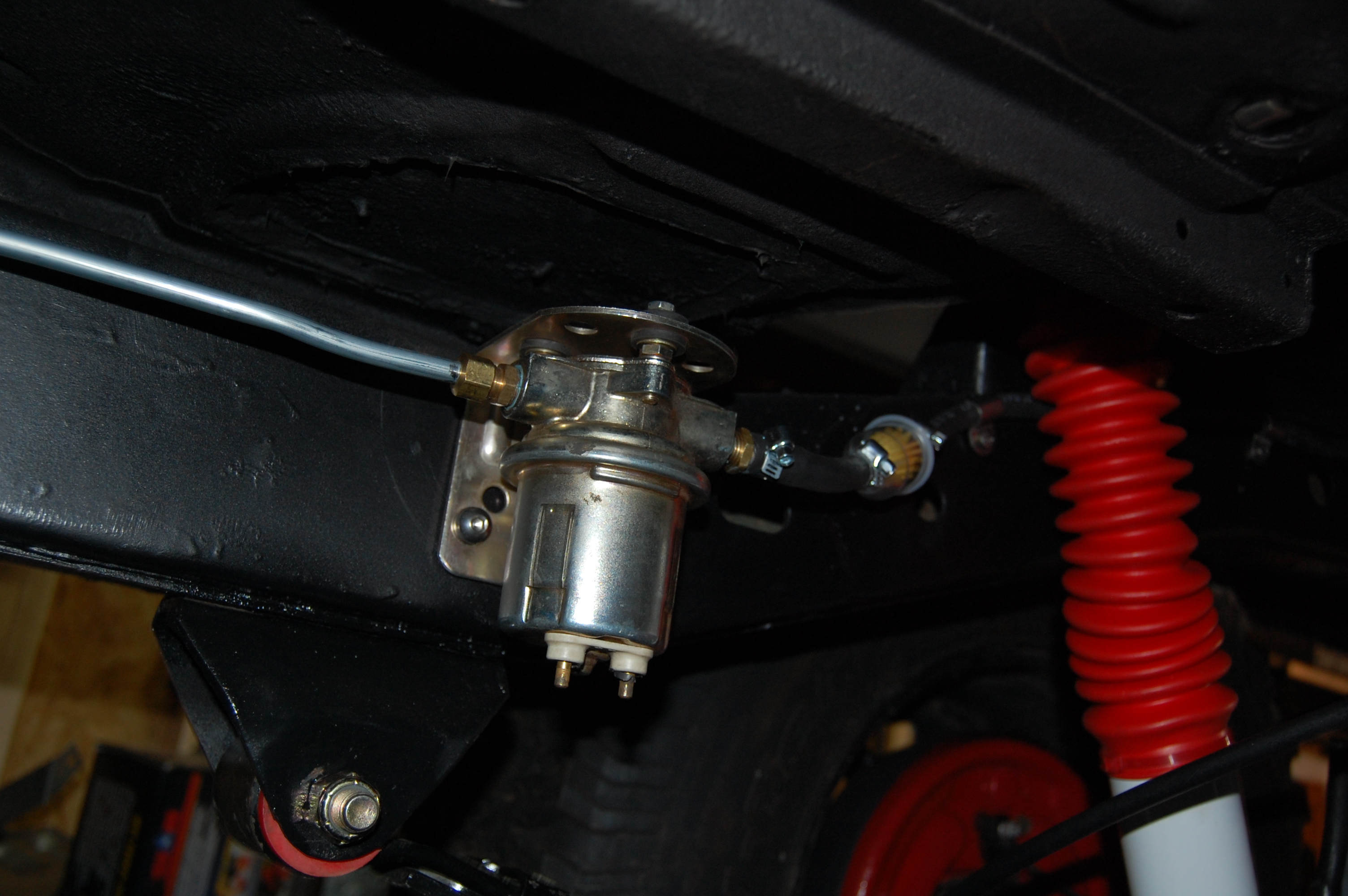

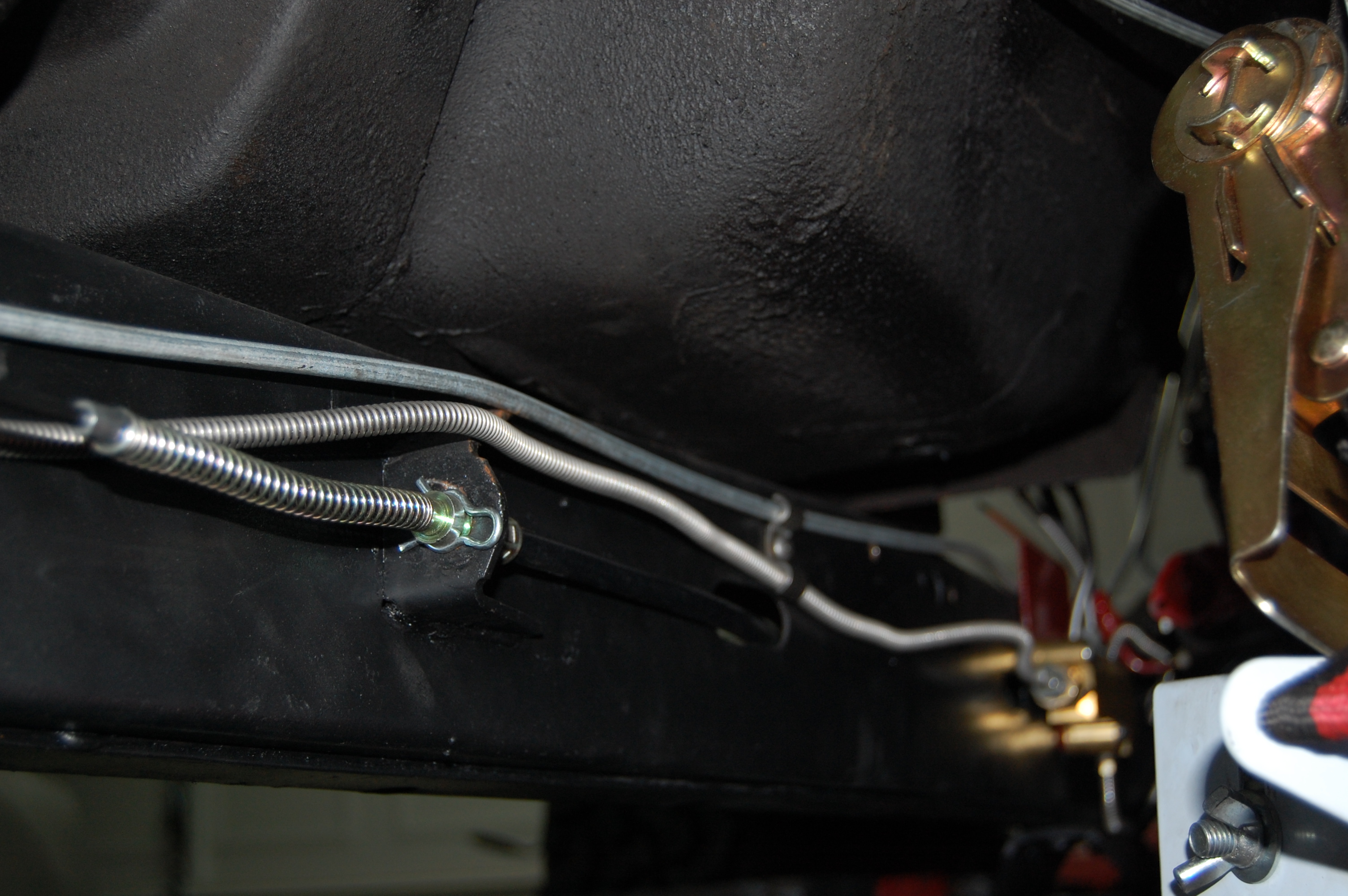

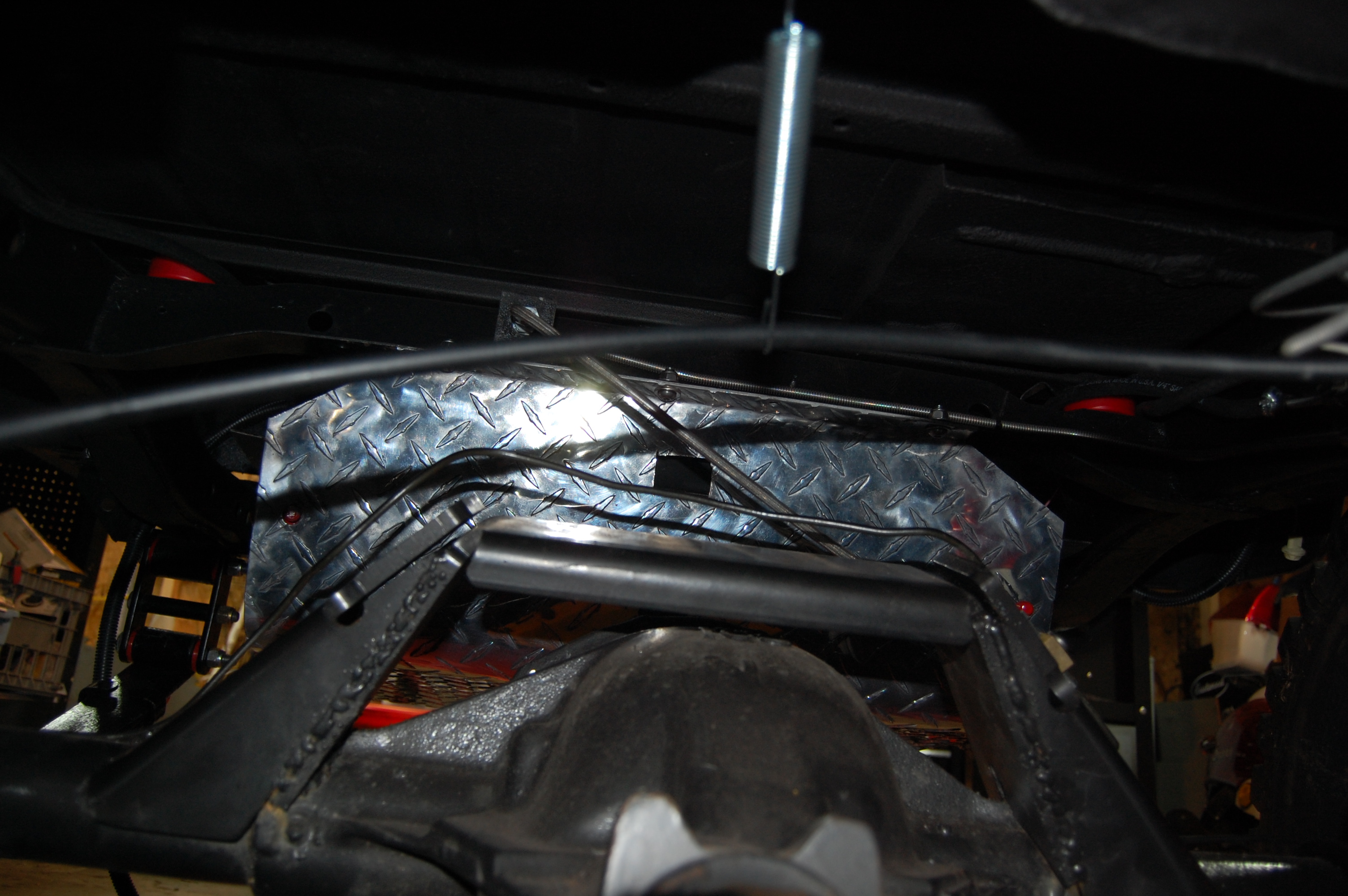

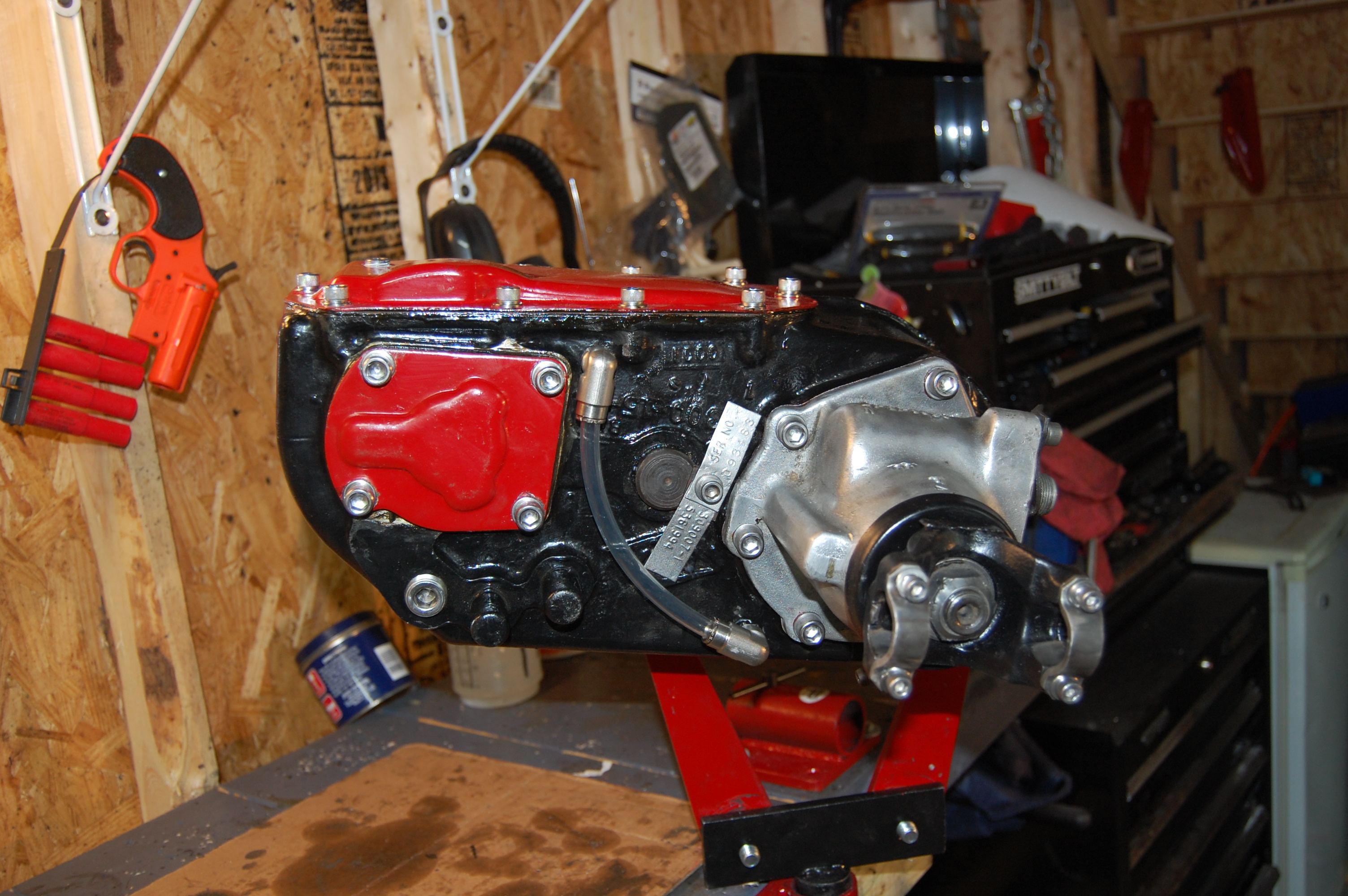

For the past couple of weeks, I've been working on the brake lines, fuel supply and return, linkage for the Weber and re-building the transfer case. I went crazy with the T-case with stainless hardware and a sight tube for the gear oil.

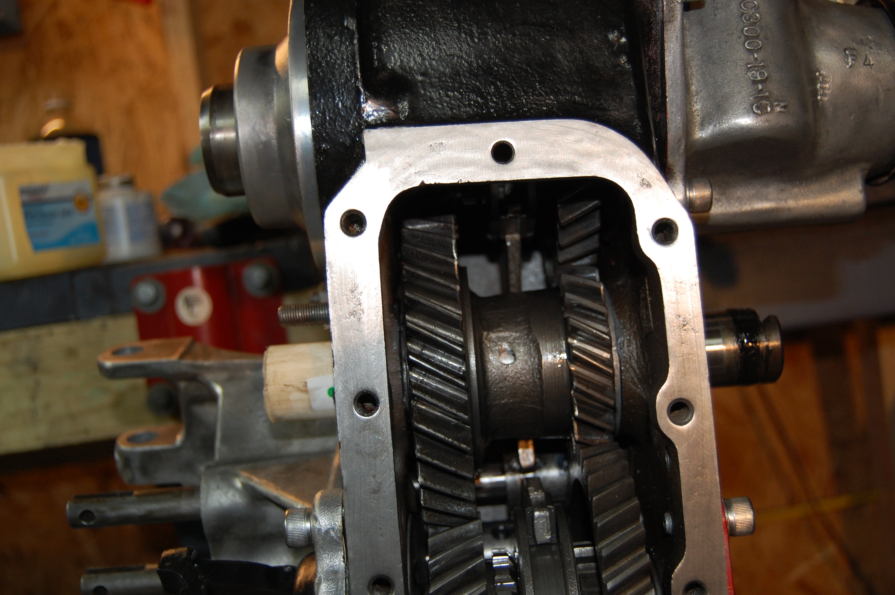

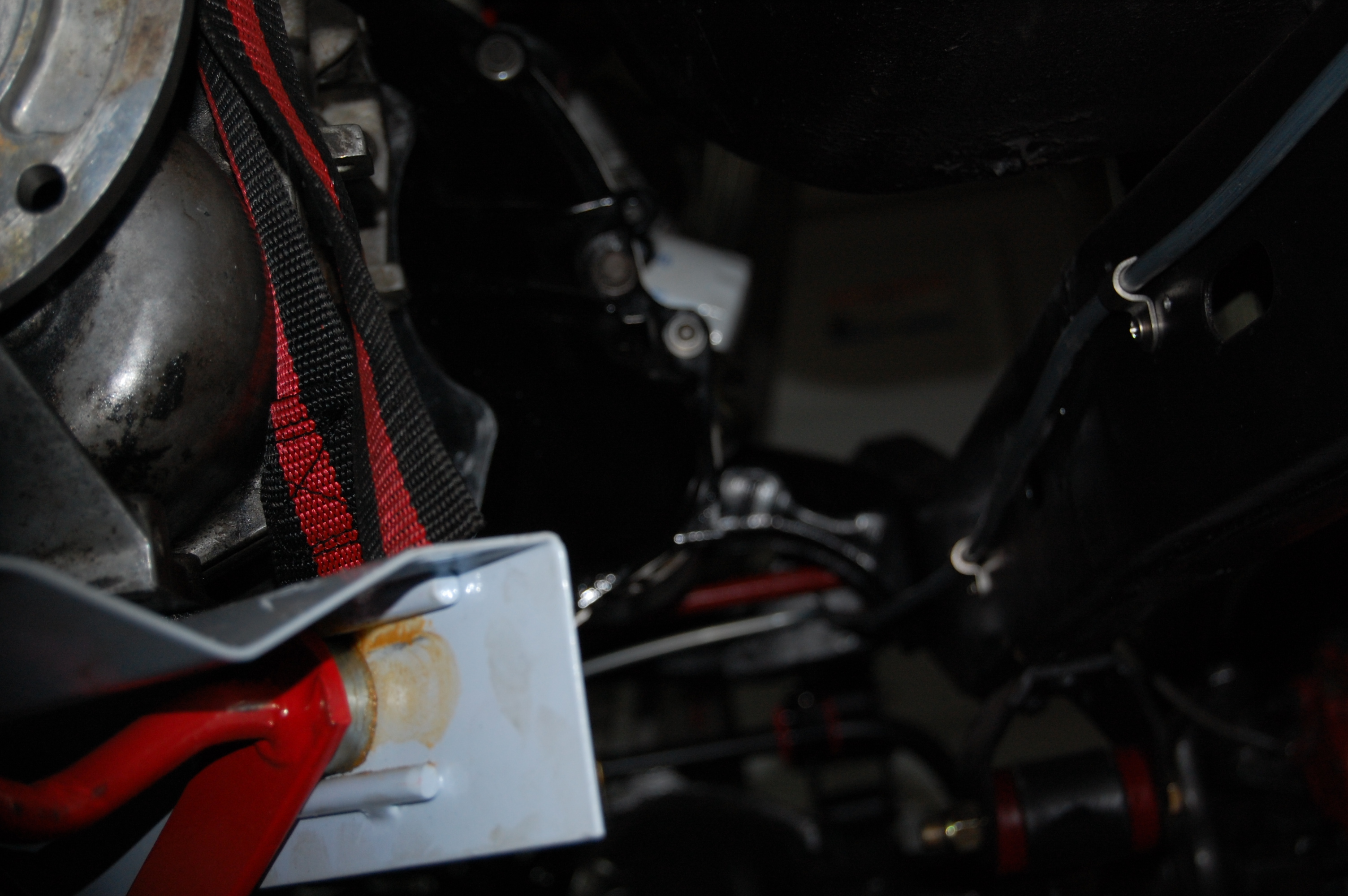

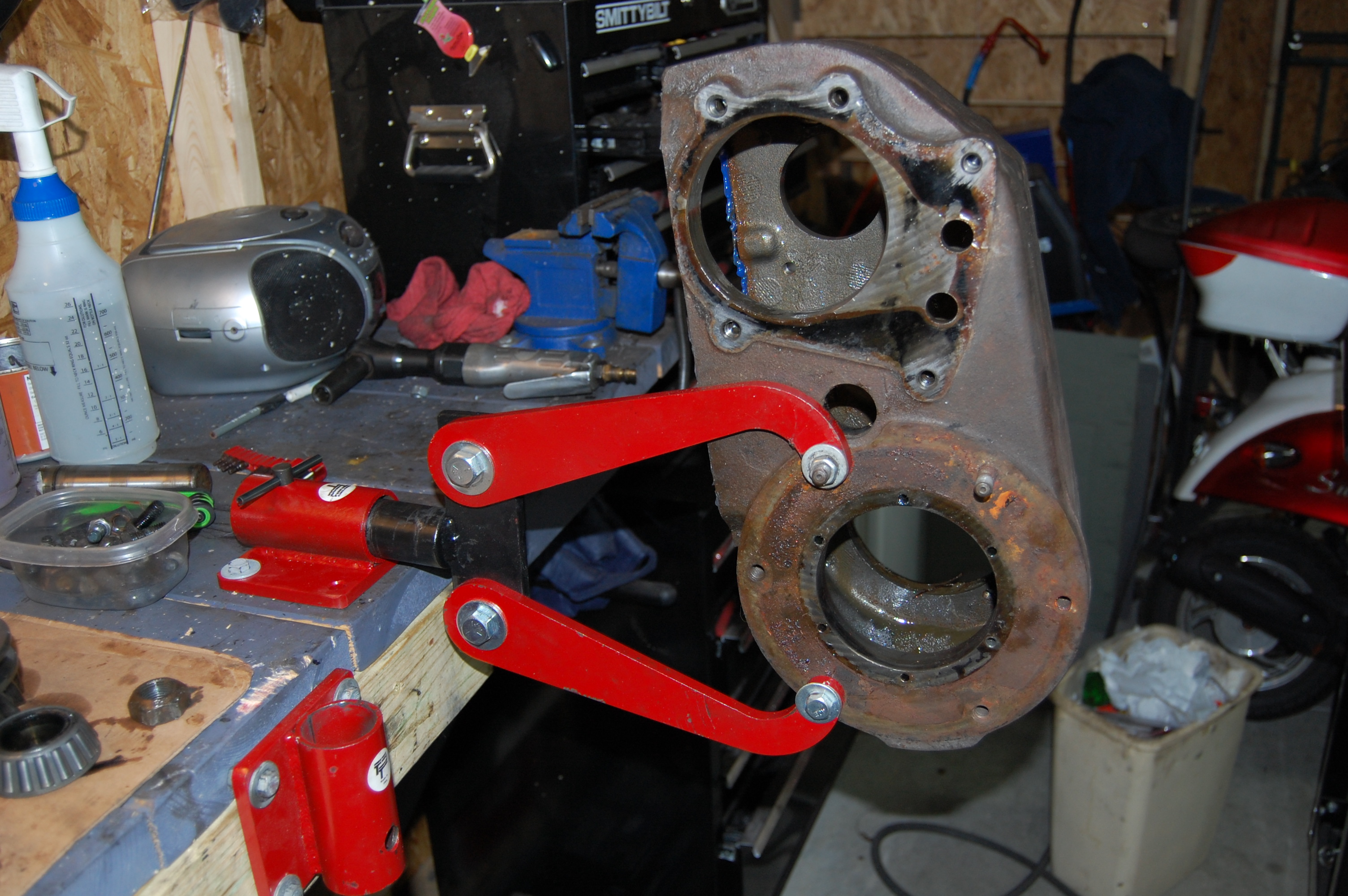

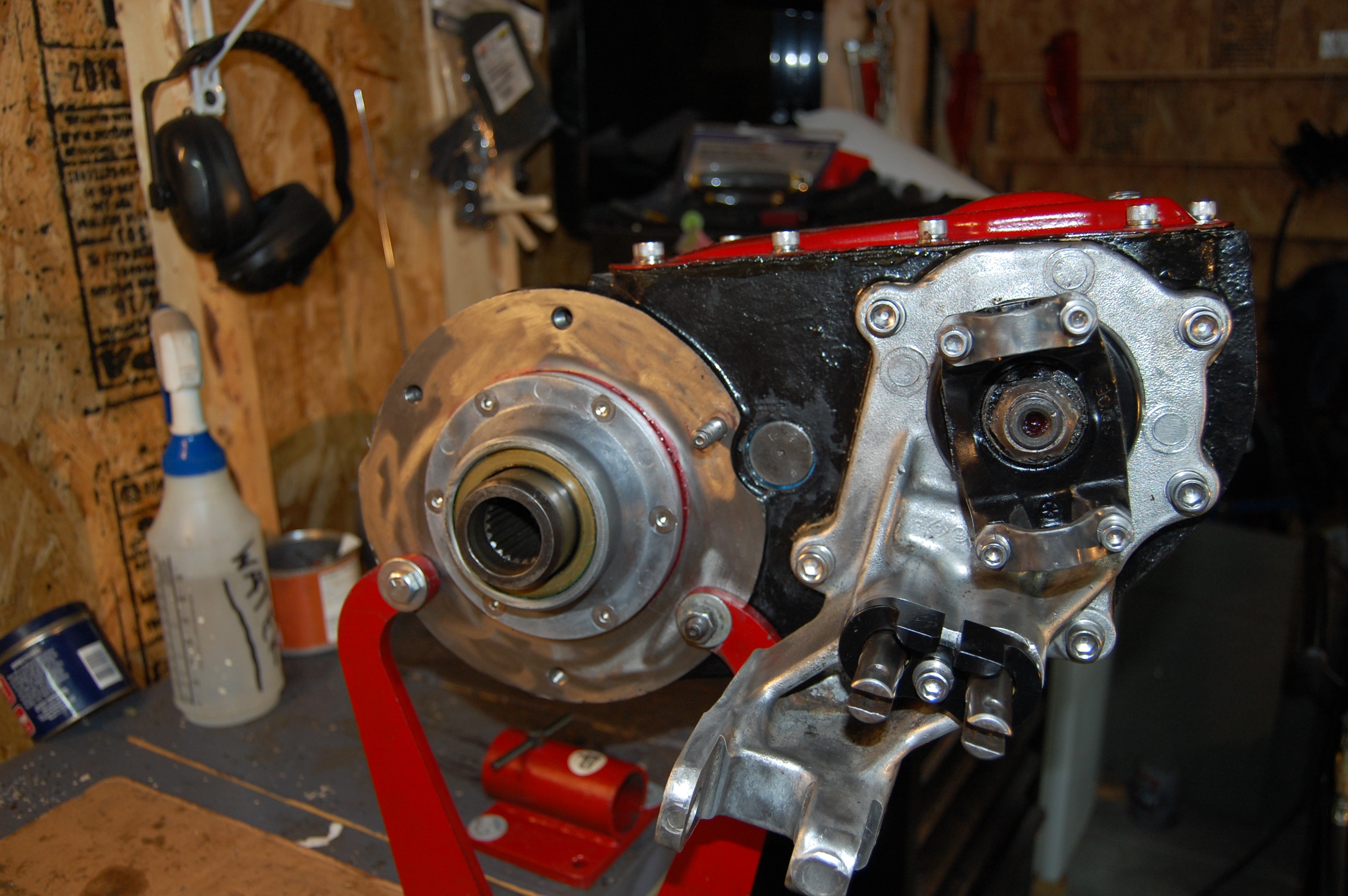

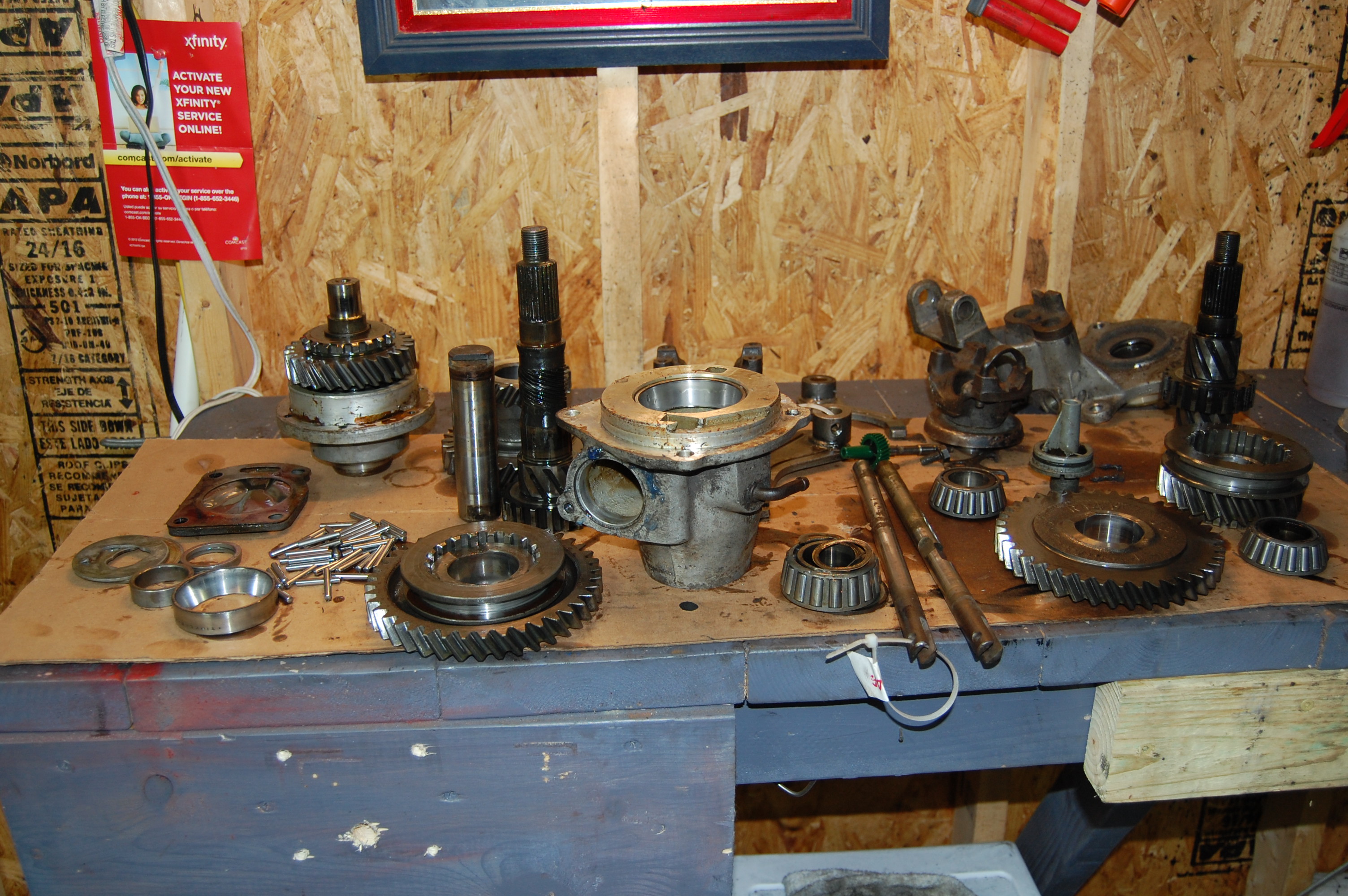

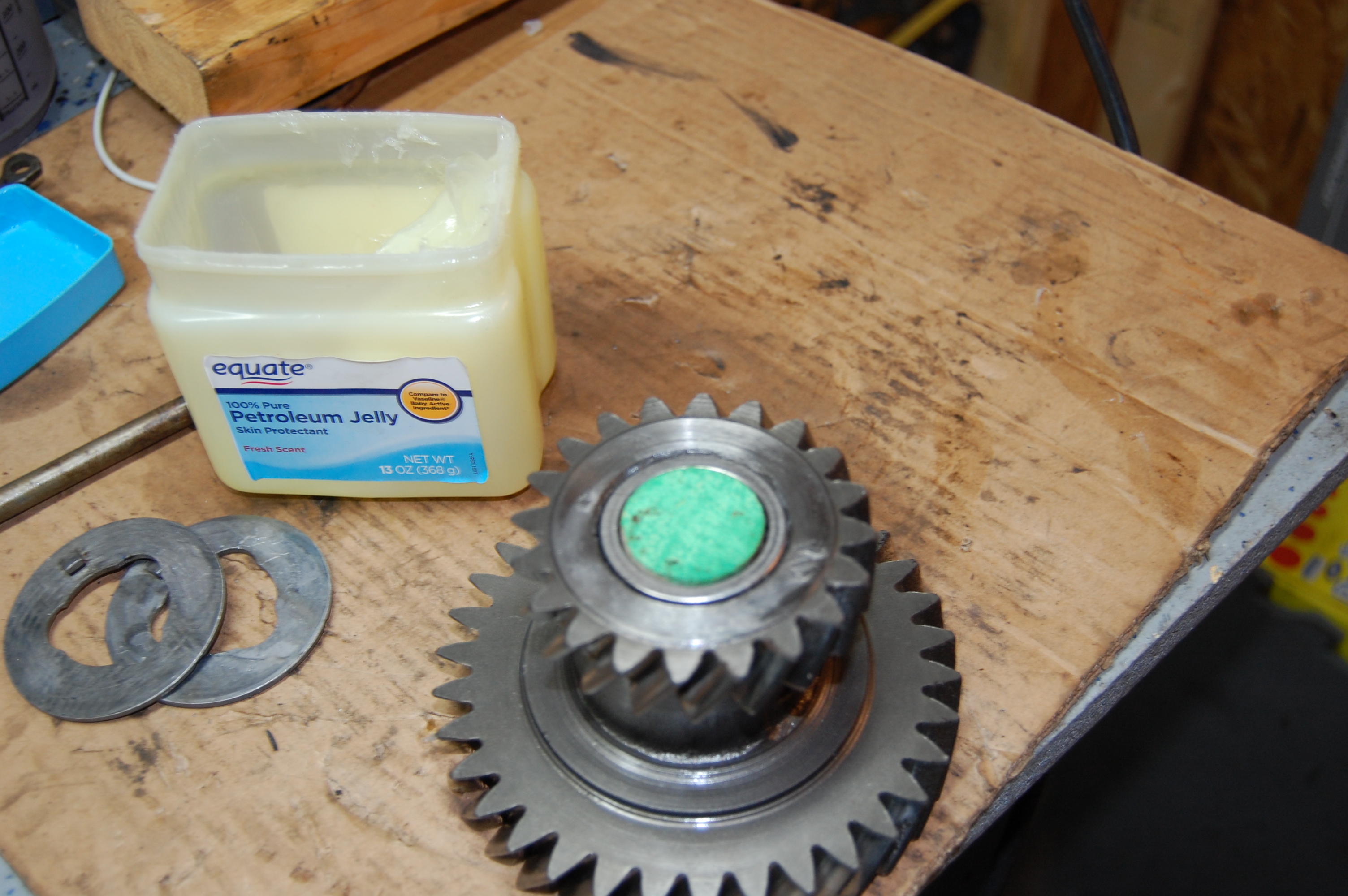

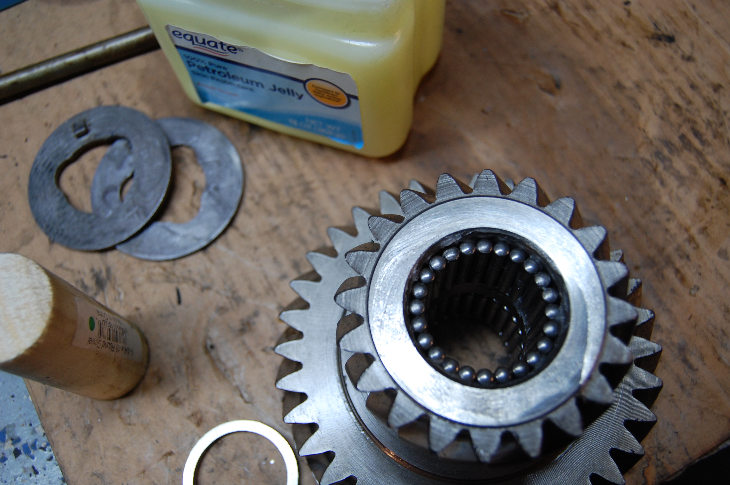

For the T-case, I disassembled the unit, cleaned and painted the case. I decieded halfway through to use stainless hardware so that delayed the completion while the parts where on order. The sight tube worked out well....
D300 parts.JPGOld case.JPGIM gear w needles.JPGIM gear w wood dowel.JPGinserrting main.JPG

Did you use the baby fresh scent petrolium jelly to hold the needle bearings in? That's what I primed my oil pump with. Lol

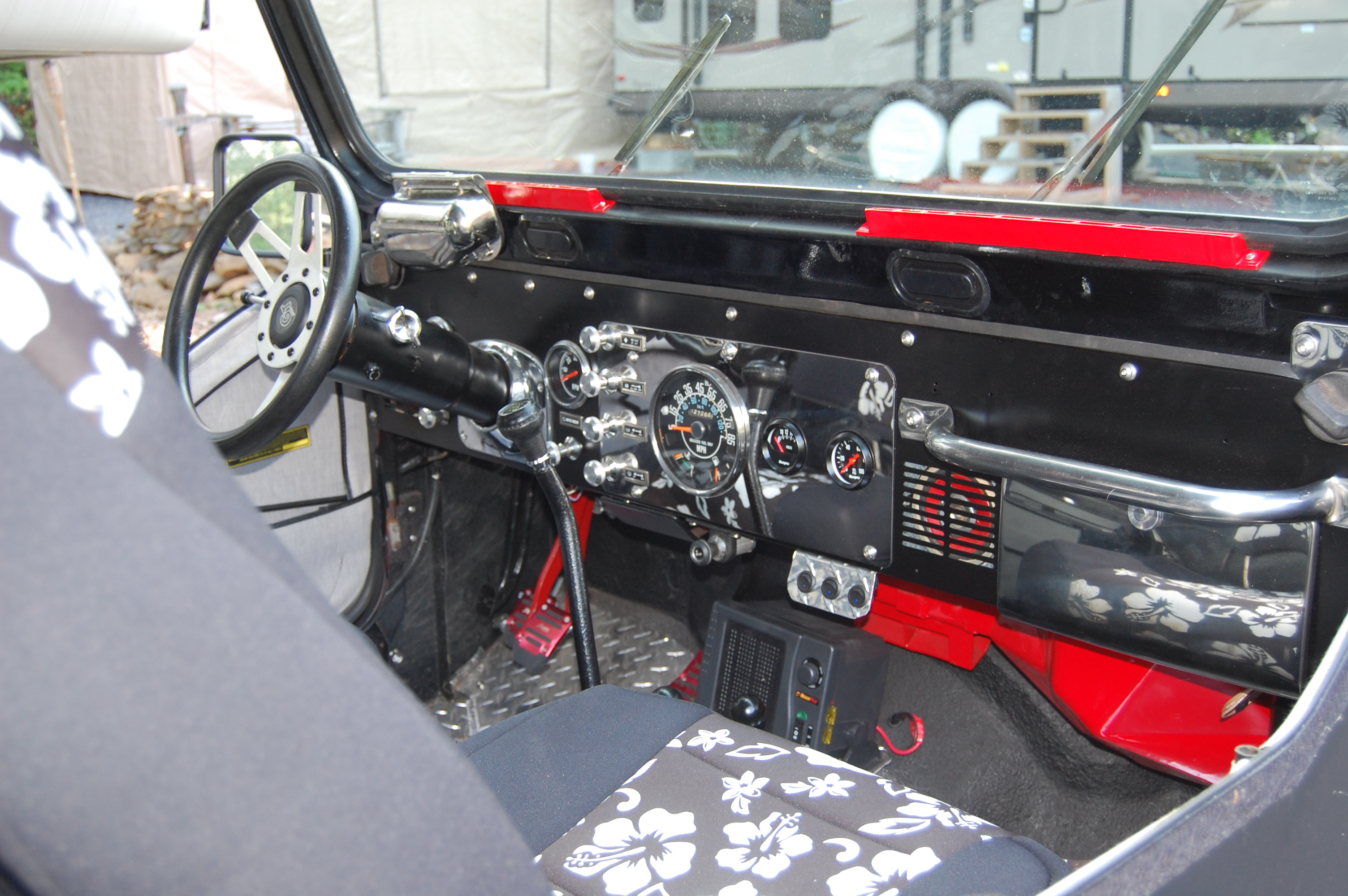

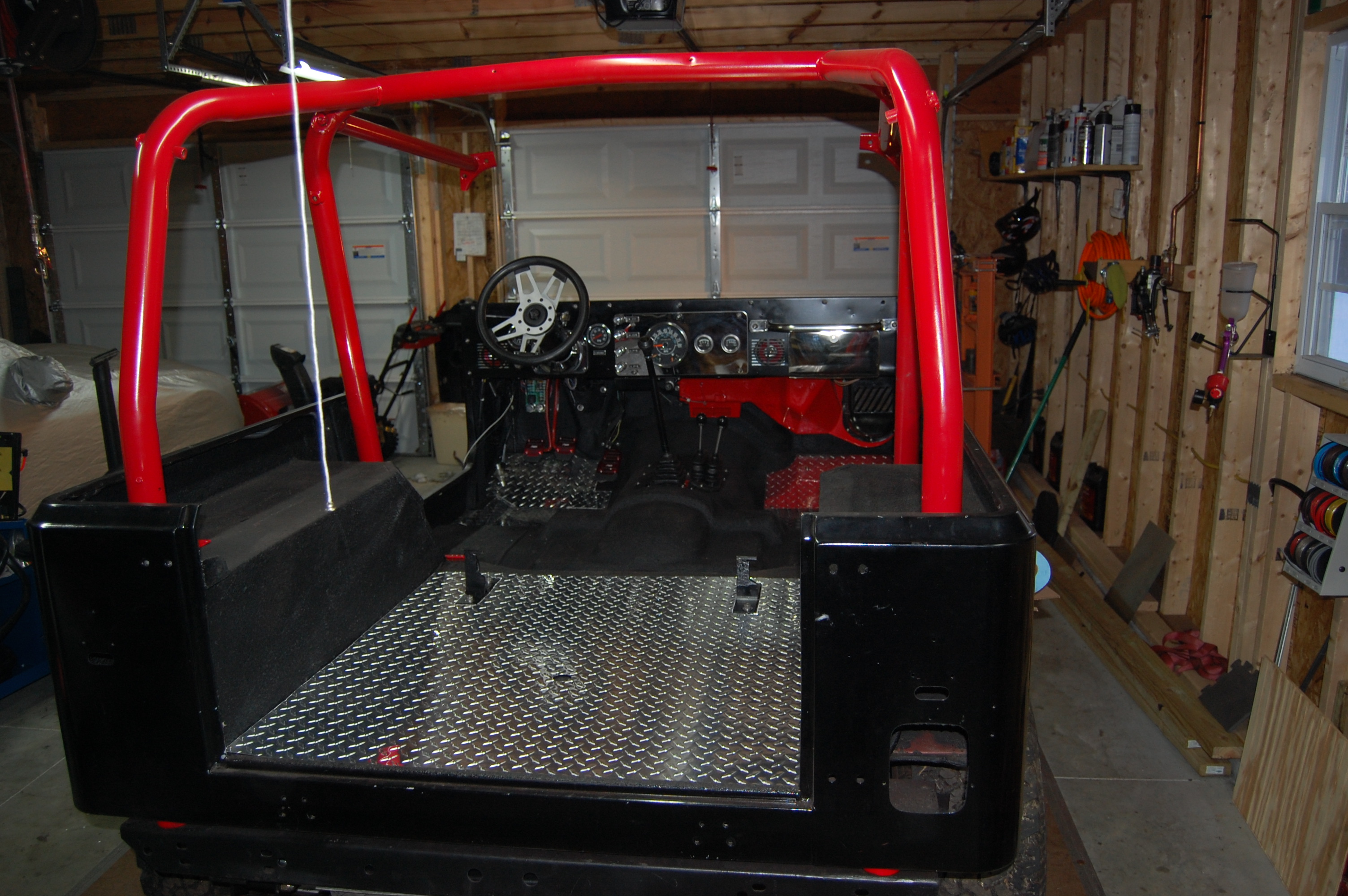

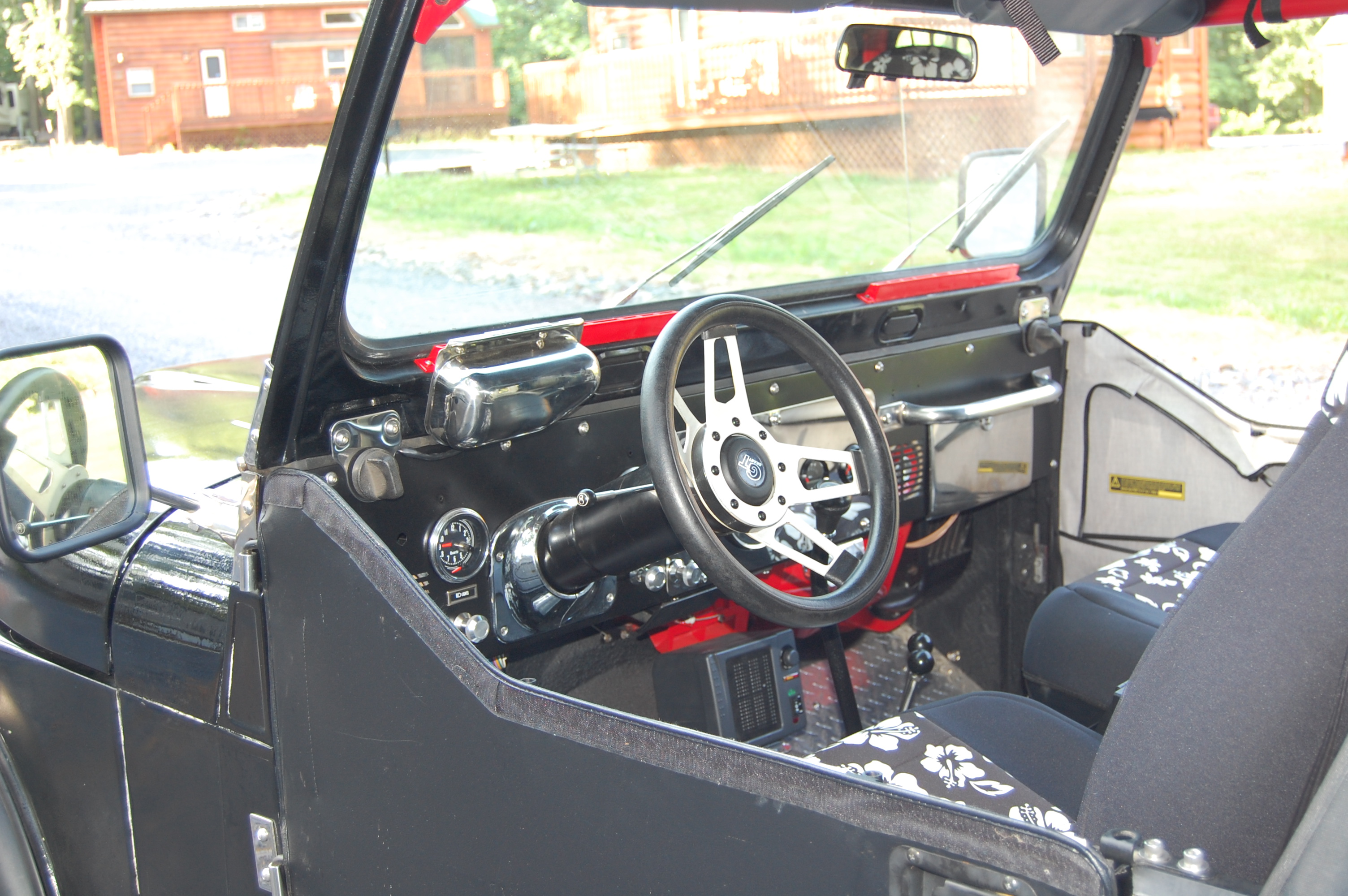

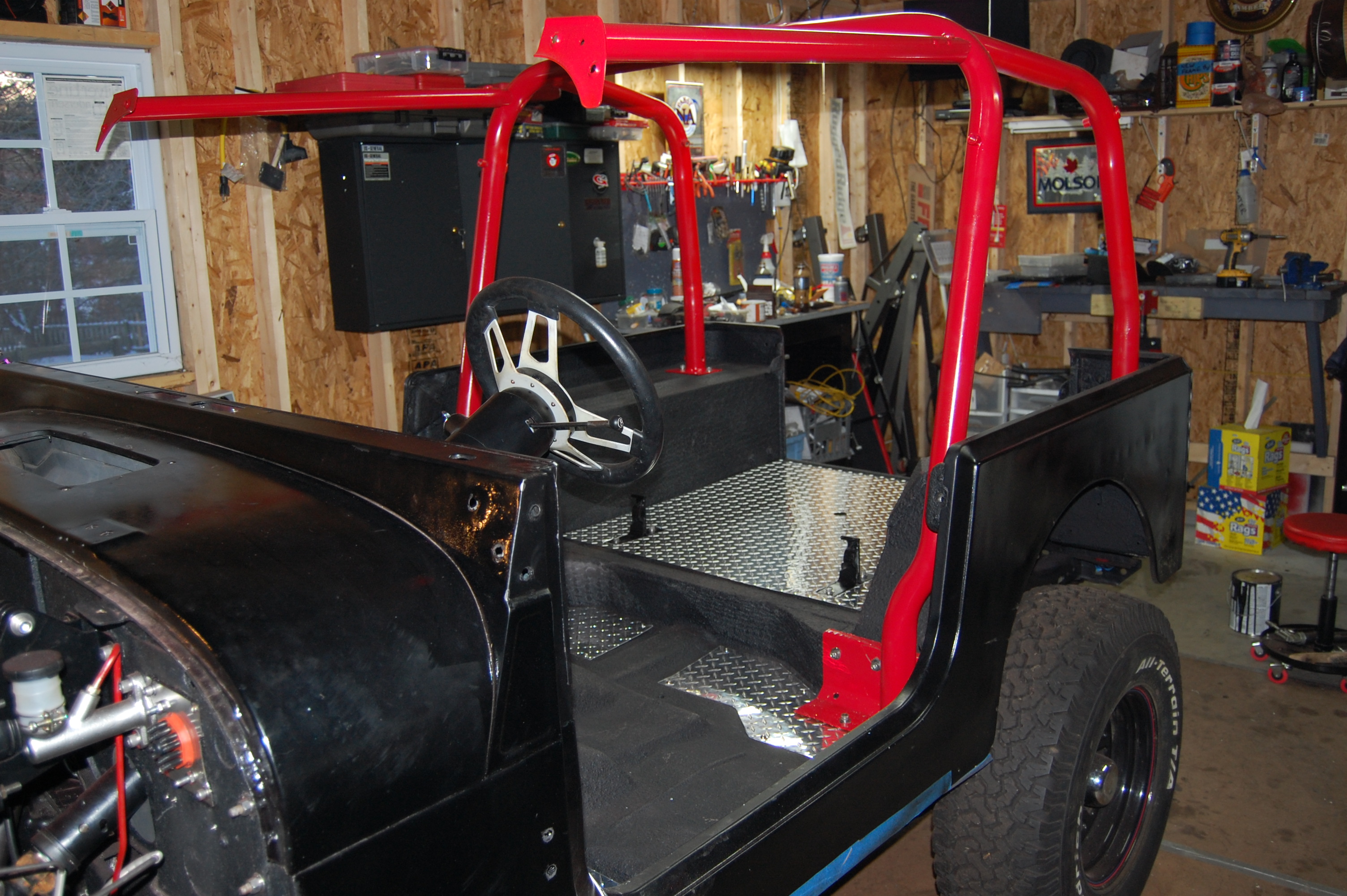

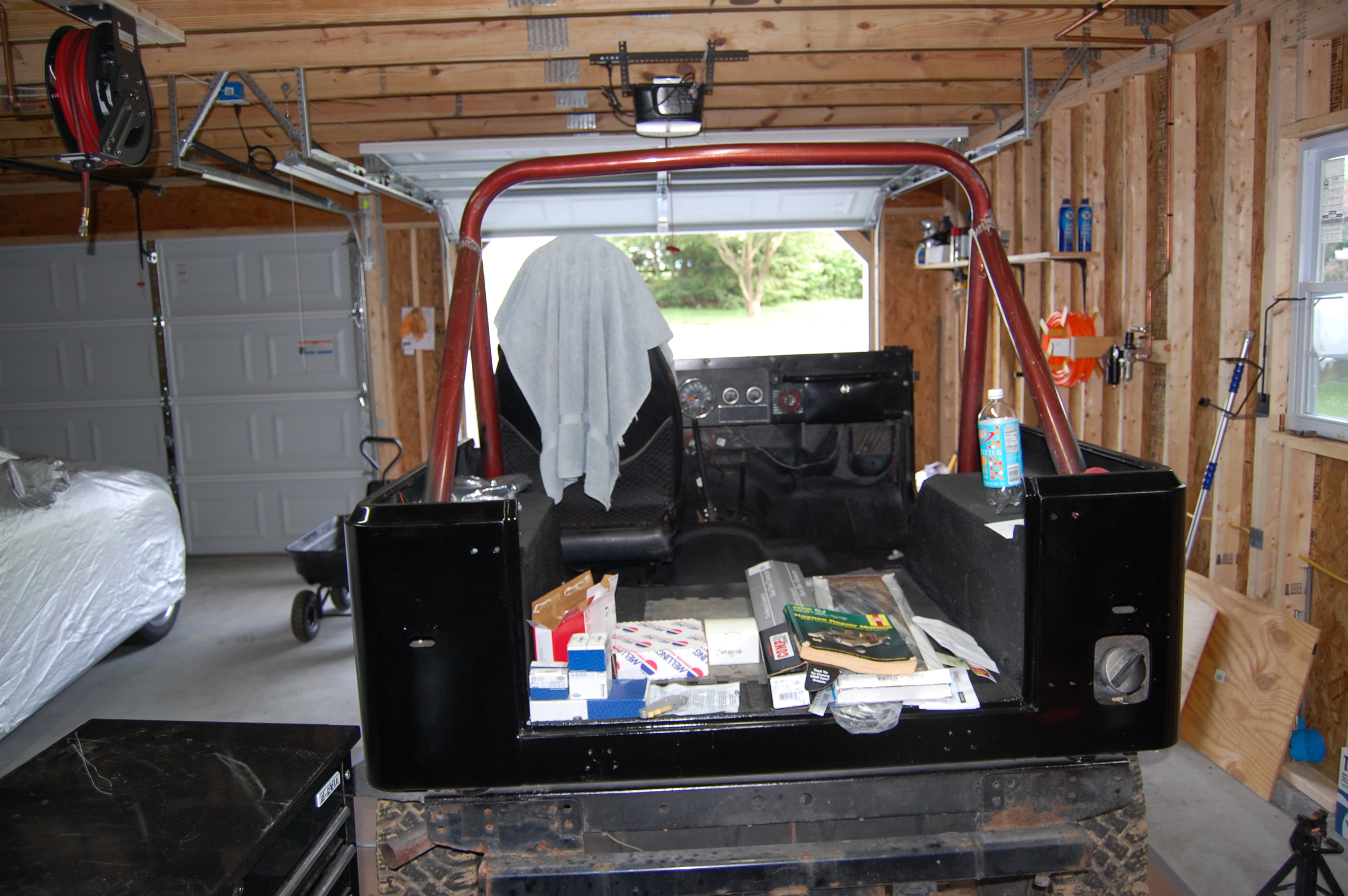

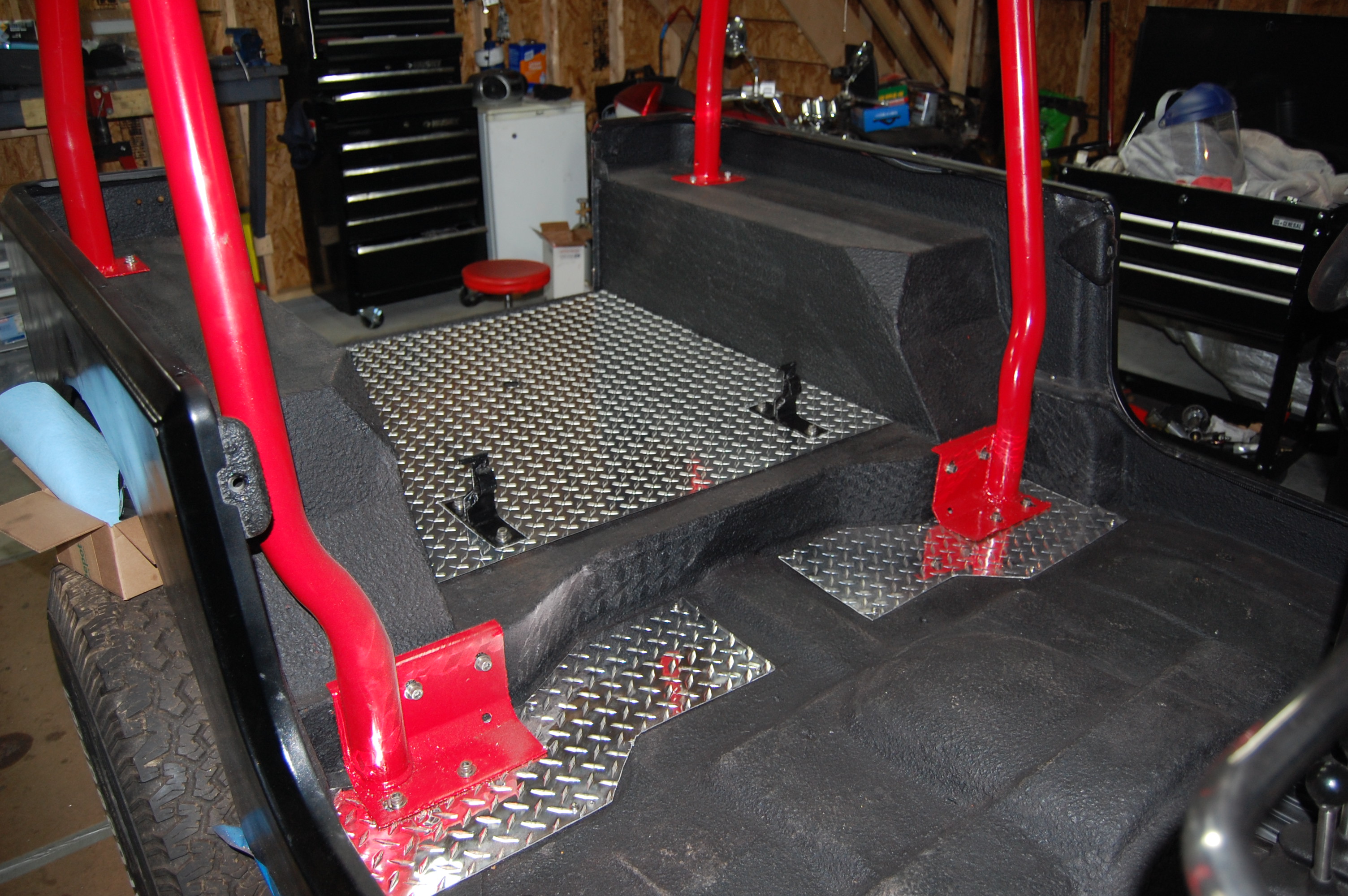

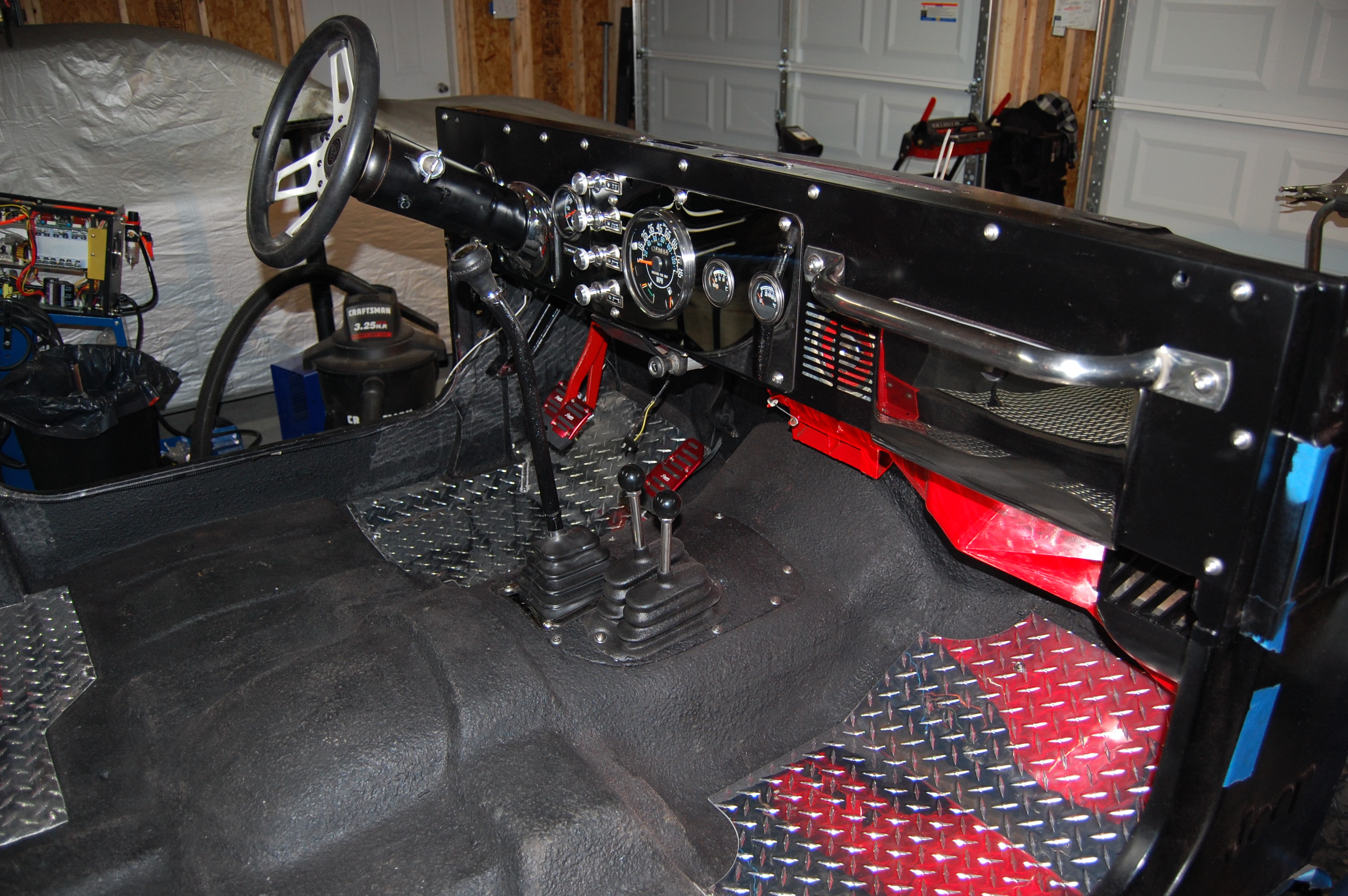

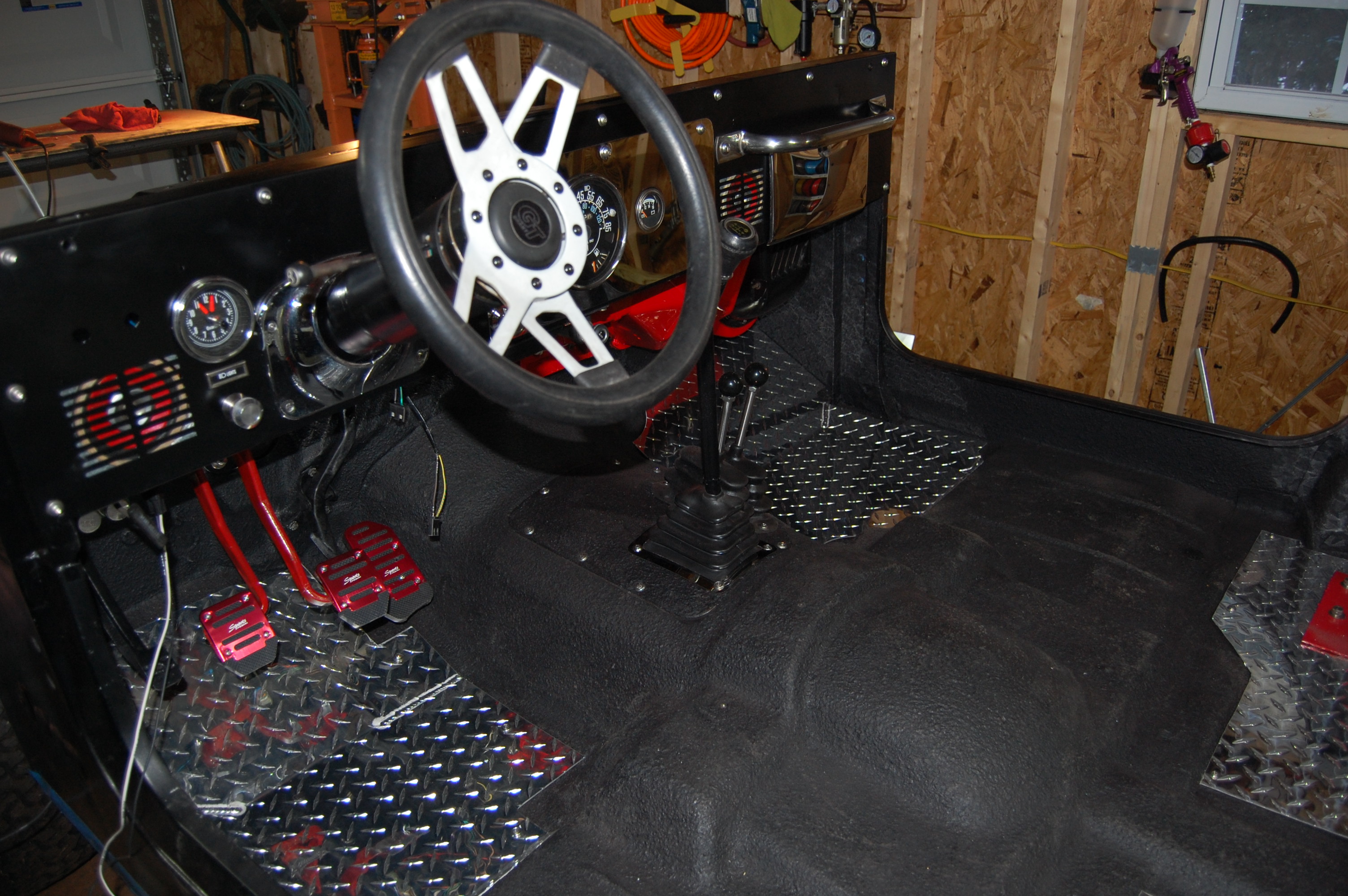

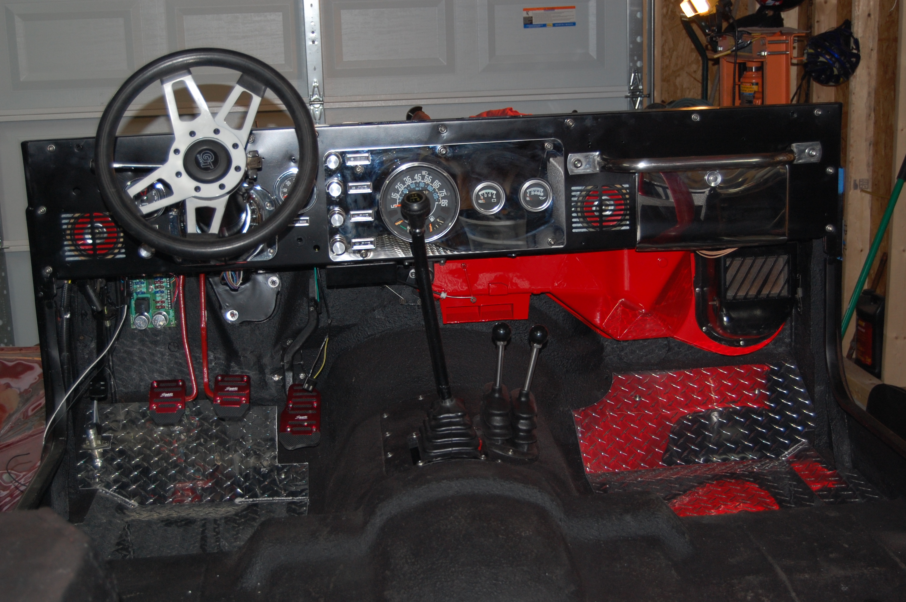

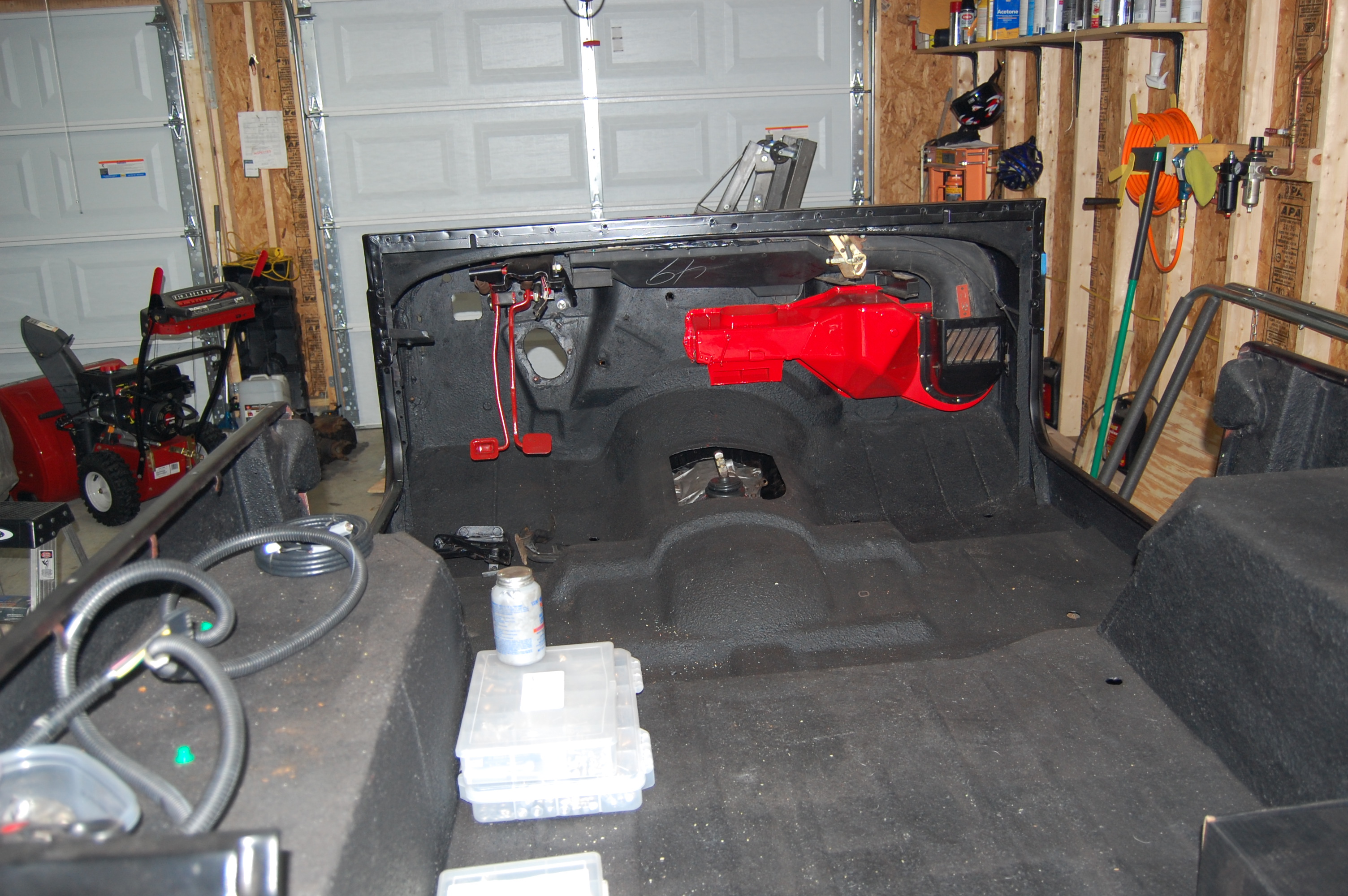

Just updating since I got most of the interior basics done. What started out as just front diamond tread floor pans turn out to be a little more once I got fabbing. So including the tread plating, I've installed the YJ rollbar, re-did the dash, re-installed the steering column and got the back half of the wiring done. The cold and snow is slowing my progress, I still need to finish the body work on the front fenders and grill. Once those are installed, I can finish the engine and harness.

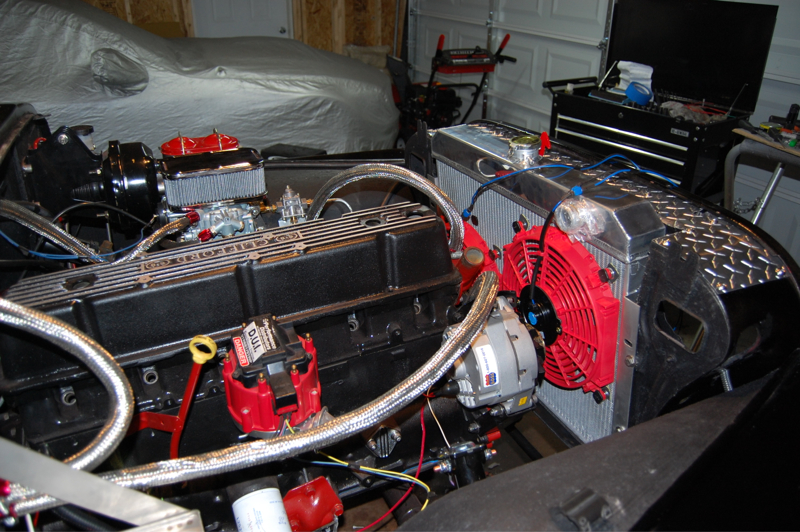

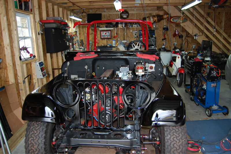

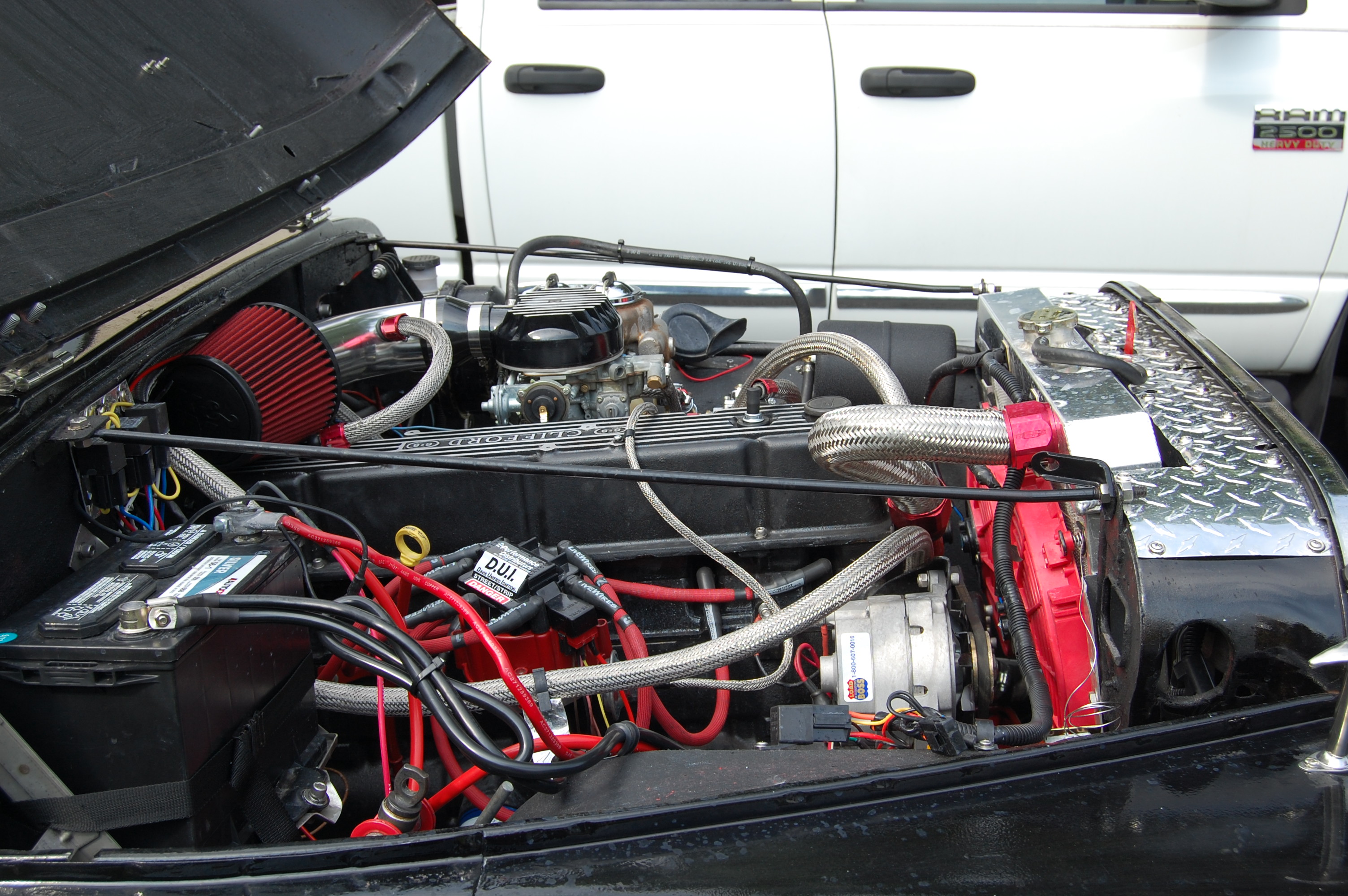

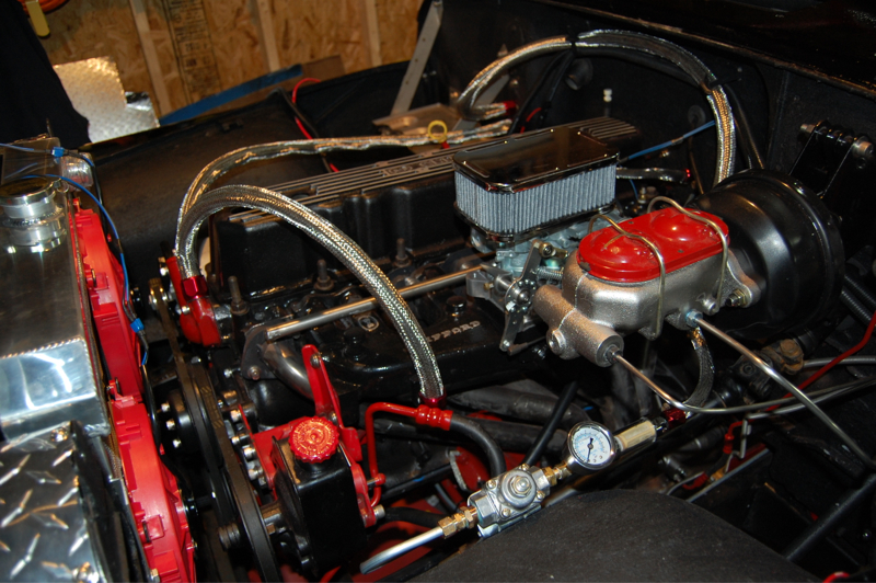

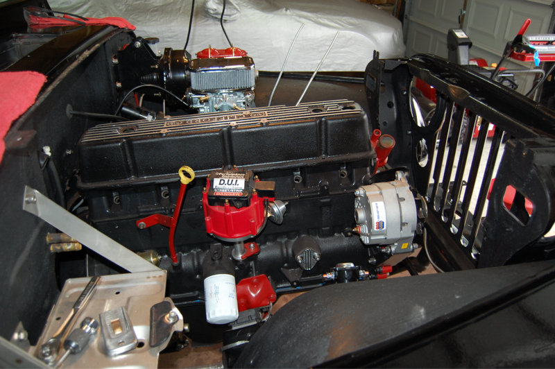

I finished the body work and painted/clear-coated the front clip. All that real estate under the hood won't last long!

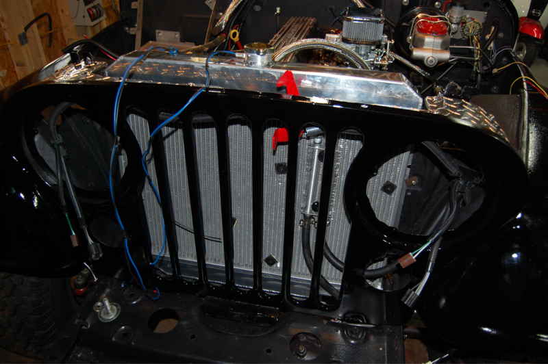

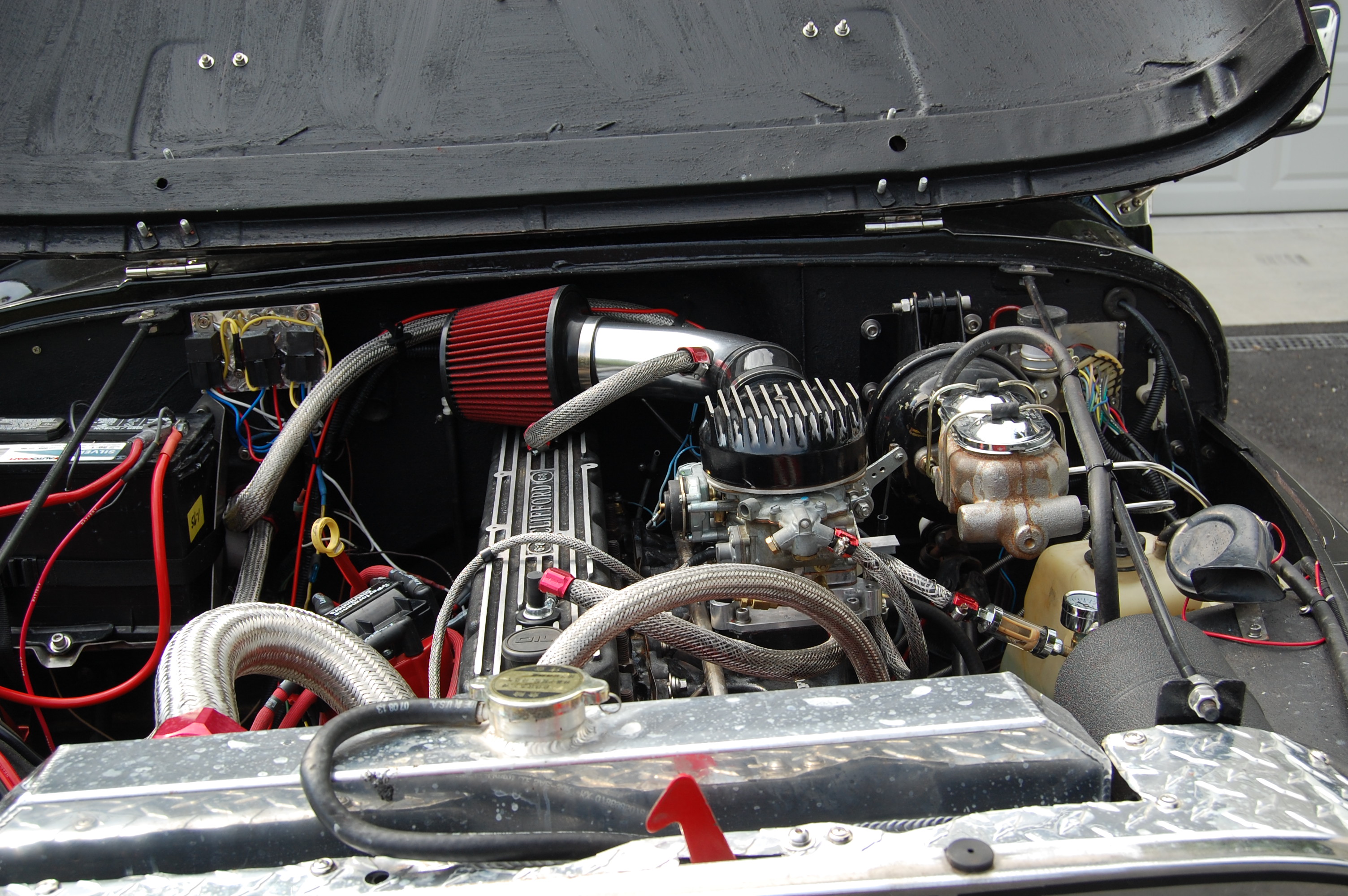

I managed to get the new radiator shoehorned in..... Regardless of what I was told, it was not a direct replacement of the OEM system.
I decided to add a P/S fluid cooler as well.

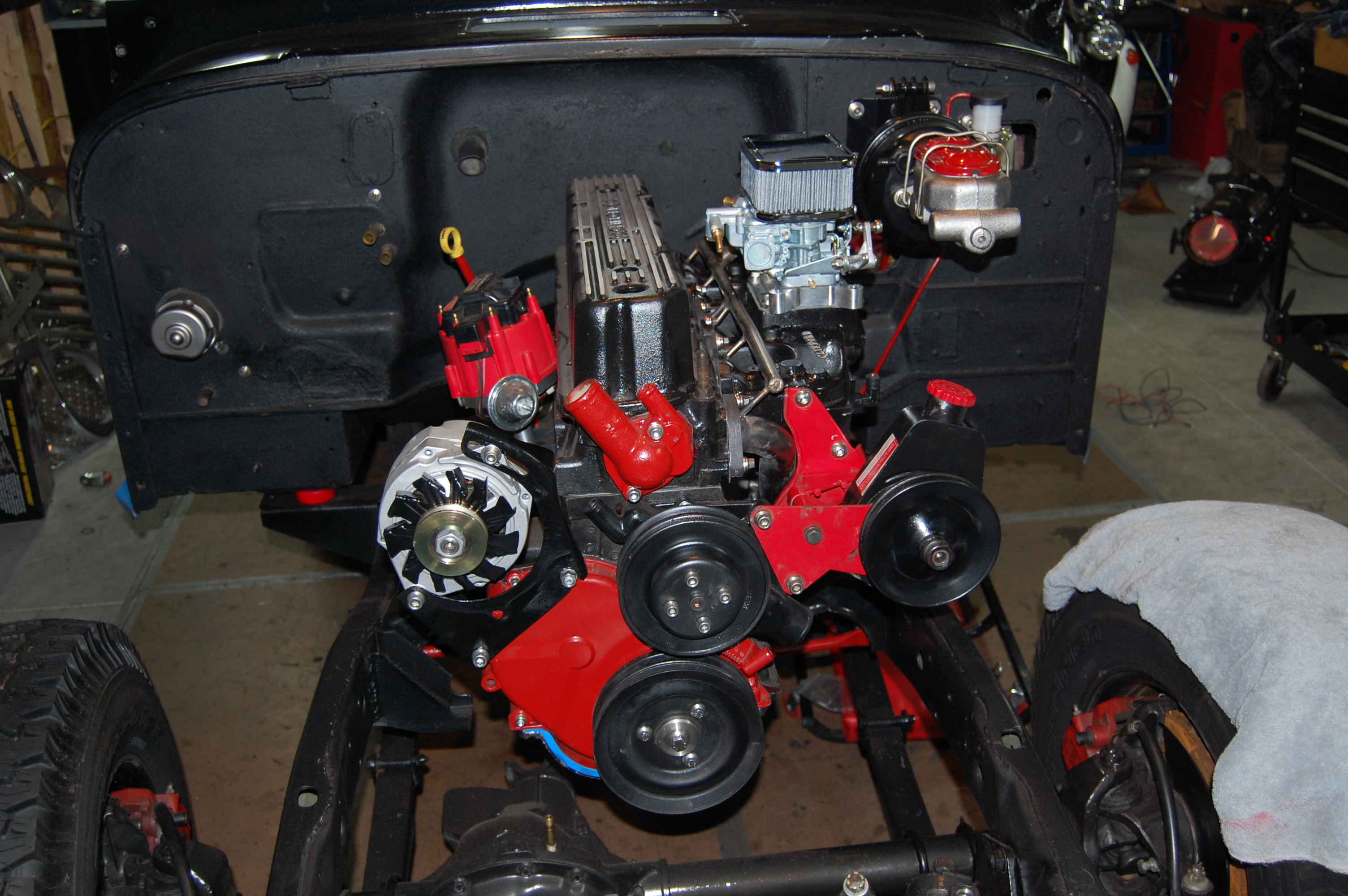

Also got most of the harness done, the fuel regulator/return line plumbed in and most of the hoses fit.

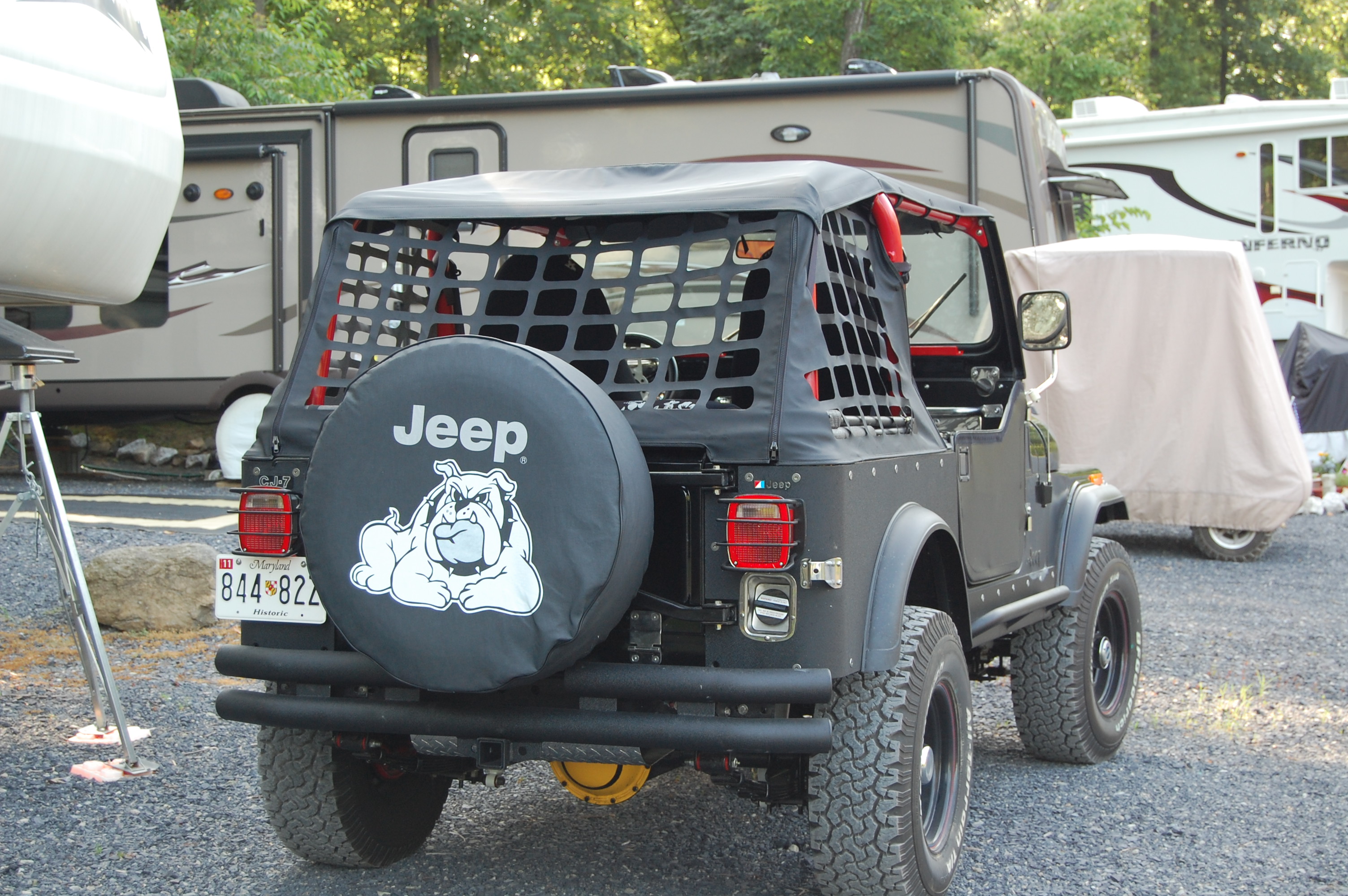

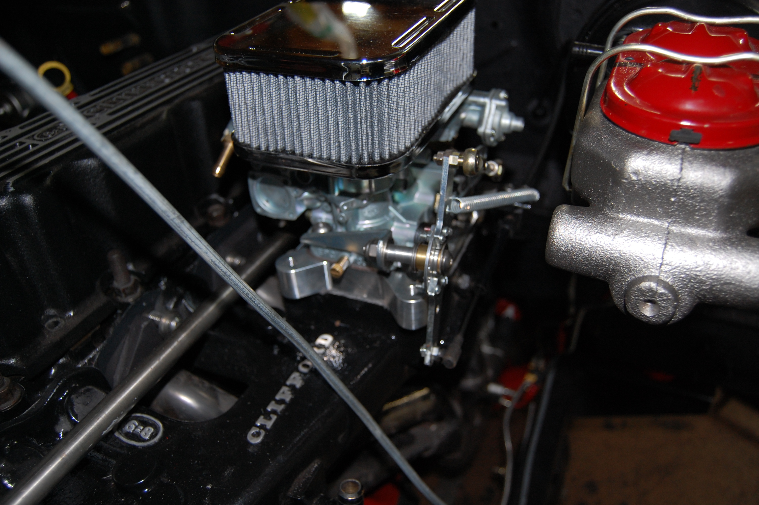

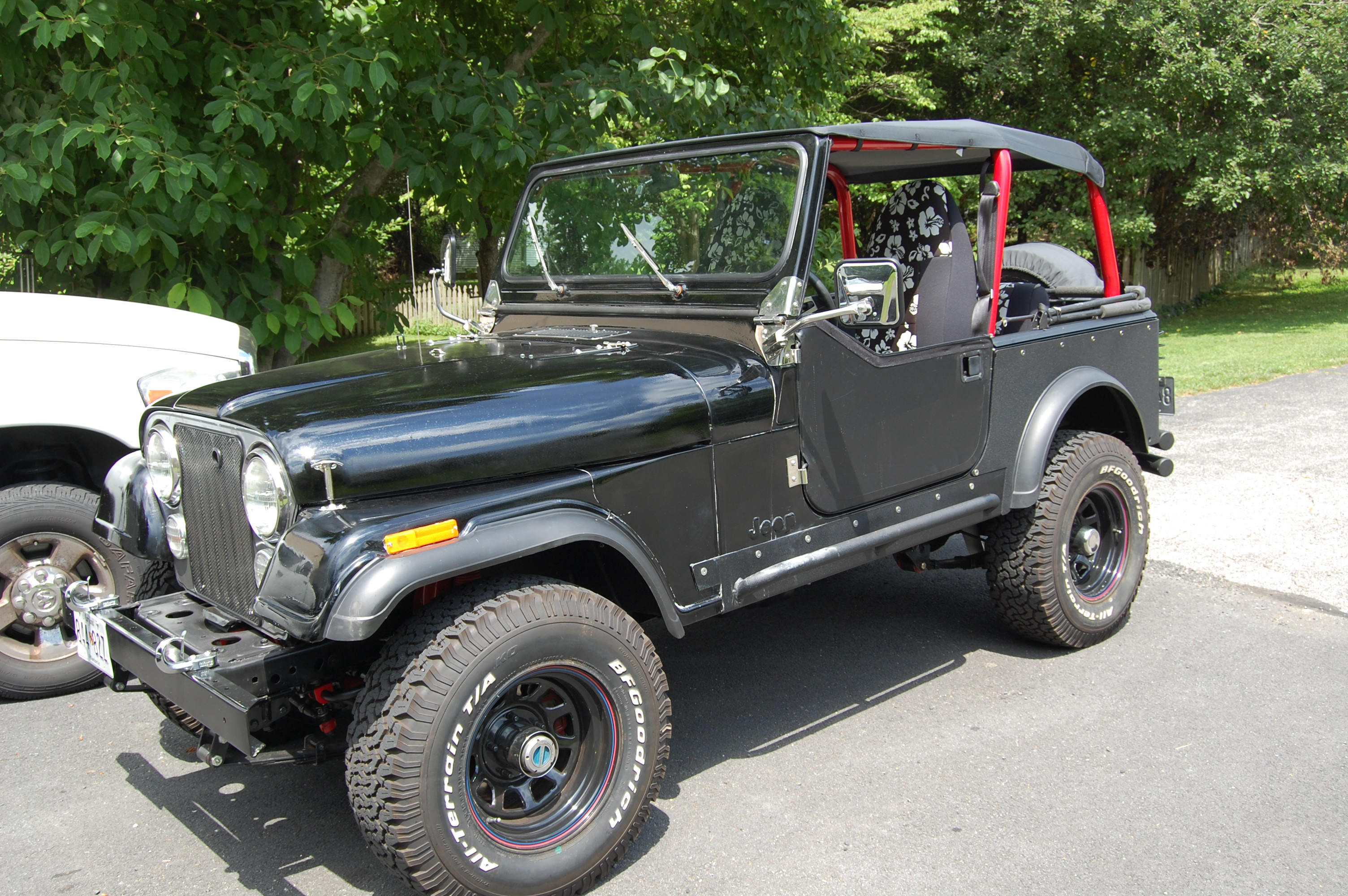

So, it's been a while since I've updated this post. The frame-off resto of the CJ7 Laredo is complete for the most part, there are some upgrades that are "above and beyond" coming in the months ahead. It's completely drivable and safe at this point. The break-in of the rebuilt motor went well with the exception of having to replace the head gasket after about two hours of running during initial start-up due to a blowout. But what can you do, it happens. I have just about 2000 miles on it, most of which is hilly back road driving between my home in Maryland and our summer place in Gettysburg PA. Barring some minor problems like a fuel regulator which decided that likes to work itself closed during mountain trips, a leaky master cylinder cover (which ate off some of my paint in the engine bay and rusted the cylinder itself) and the normal jetting trials with Weber carbs, all went good.
All in, my fuel economy is satisfying at 14-14.5mpg and idle is acceptable considering the large cam I went with. It will go from idling at 650 rpm's to the redline mark of 5000 in an instant. The engine is extremely beefy on both torque and horsepower but that came at a cost: I've lost some streetablity in exchange for the gains. Some small things like a vacuum reserve can for the P/B, a lumpy idle (both trade off's for cam) and the use of high octane fuel (due to cam and high compression ratio). When I acquired the engine block for this project from the guy who had enough of "fooling" with it, it included some new and used parts that all came as a package deal. In the deal was a brand new EMPI 38/38 carb still in the box (it's a "work alike" of the Weber) . I started out with it and ran it for the first few hundred miles and I will report that the EMPI version of Weber carbs do work, but not like a genuine Weber. The old adage of "you get what you pay for is true" (especially since it was pretty much free for me), if you research the EMPI carb, you will find that they cost about 1/3 to 1/2 less than a Weber. I had an older Weber 38/38 from a Alpha Romano in the shop which I re-jetted for the Jeep and it provided better economy and infinite adjustability that Weber's are famous for. After a few calls to DUI/Performance Distributors (Davis Unified), they could not sell me on the whole concept of manifold vacuum for the advance. I understand that they set theirs up that way and it's a proven technology, but after many failed trials with various curves at their recommendations, I returned it to the ported vacuum I'm accustom too after changing out the pre-set advance can that comes with the DUI setup with a Crane Cam's adjustable can with a limiter. Worked out great.
