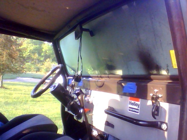

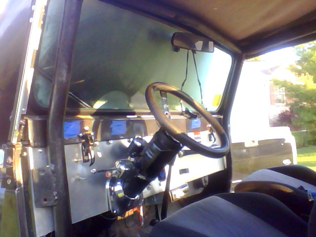

This is my dash, its aluminum I think,(not polished) cost around $70 but had no holes in it, wasn't hard at all to drill my own with a hole saw. I made 2 support bars to run from the dash to the firewall for support so it wouldn't flex.
Really nice job ! Good looking jeep sir ! Can't wait to see when Shewilly applies her personal touch in details such as this in her taste !
like the turn signals , reminiscent of the old school big rigs . Nice ! Diggin' it !

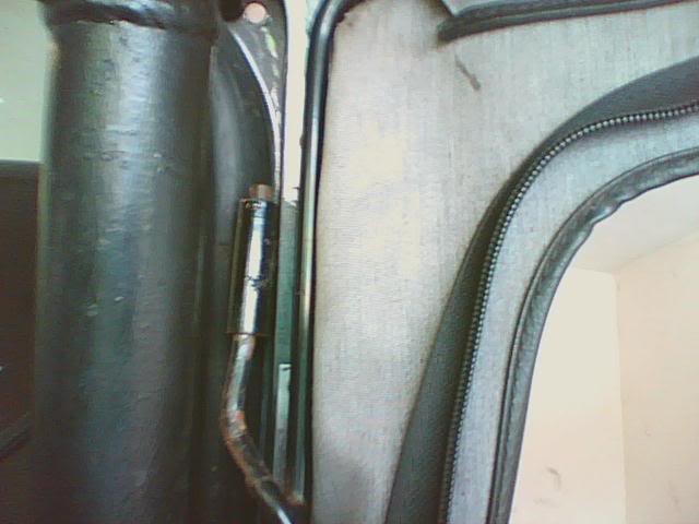

​Id like a better look at where your upper door hinge is located if possible.

This is the only pic I have of the upper hinge. It bolts to the inside of the windshield frame. Mine and your jeep should be very similar as big changes came in 76. They are diff such as the drive train, but a lot will be the same.
Nope, Ive got a good idea where it is, thanks. Yes, everything did change in 76, do I admit knowing this when I went with the 75? Ok yes, I did. Thought it would up the challenge a bit, and yes, it did! Did I need that additional challenge? Survey would prob say no!

Well heres a question. How necessary are all those indicator lights on the dash? Do I need a light to come on to tell me my wipers are on etc? Seems like just more wiring to worry about. idk. All opinions welcome.
Well, I kinda felt the same way about the dash. The only thing I have in my dash is non factory switches. I don't even have a speedometer in the dash yet because I don't want the gas/temp cluster that is built into most jeep speedo,s. I want a speedo only. I have a on/off switch for the headlights, on/off/on for wipers, on/off/on for heat, on/off fuel pump. I have aftermarket volts, temp, oil pressure gauge, and a tach, and without any illuminated light in the jeep except the gauges, its pretty dark inside at night, I carry a small flashlight so I can find things at night. I am wanting to get the factory switches now though, not because of the lighting at night, I think it will just make it look better.

* 69jeepcj / I dont trust the fuel/temp on the factory speedo either, but Im just adding the guages I think are necessary (on the 80 cj) and keeping the original. I havent decided how this one is getting wired yet. Or what to do with the dash so...

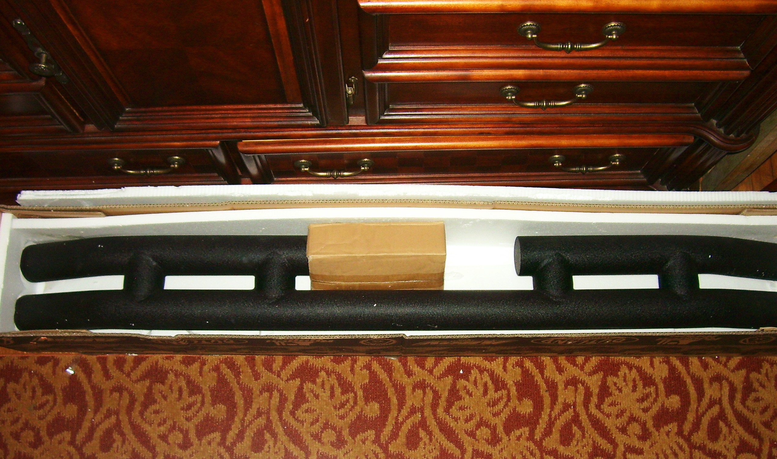

Below I tried to download a pic of rugged ridge tube bumper I got on ebay, but it didnt work =(
Some other time I guess.

Tube bumper. Wasnt my 1st choice, but not alot of choices out there for intermediate, and the price was rite. Also I like the seperate hitch kit idea that Rugged Ridge offers with this setup. Yea its a bit premature, but sometimes when you come across a deal, well you know. Finding one for the front is even more rare :( and the one thats on there now is hidious, but functional.
