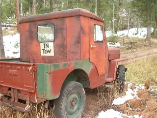

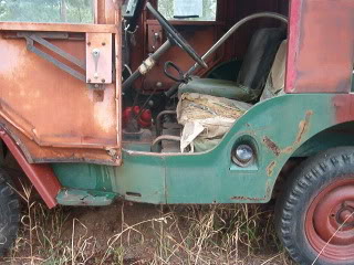

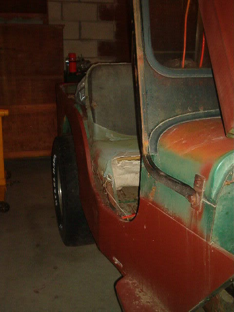

First day 3b got home in 2004

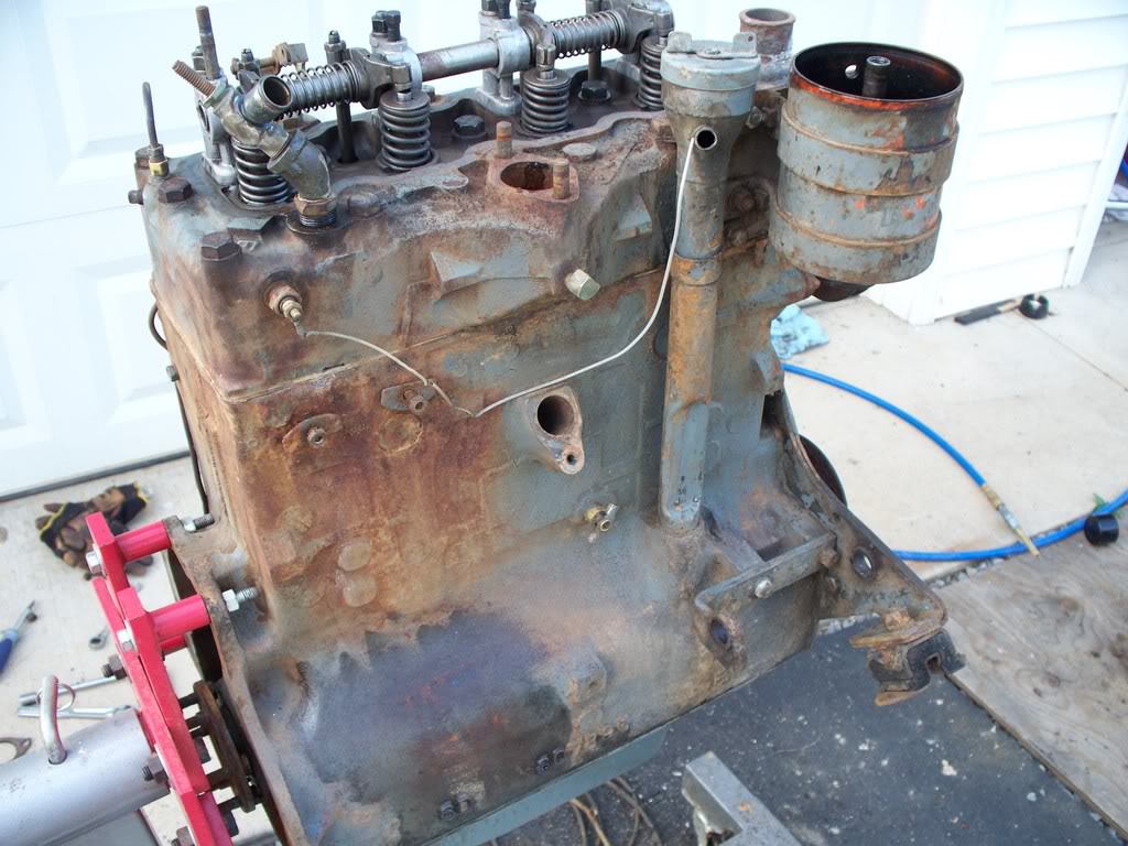

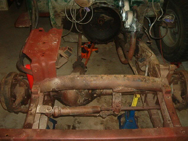

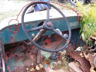

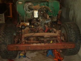

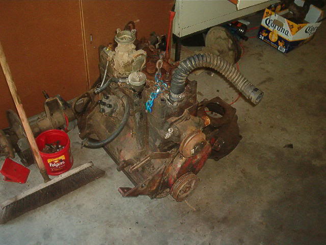

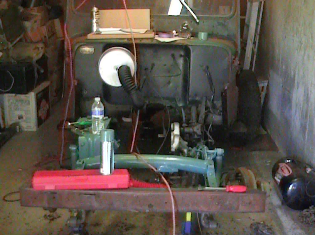

Beginning of tear down

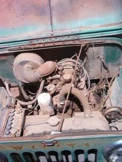

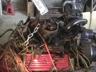

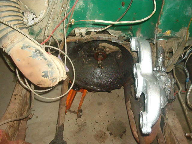

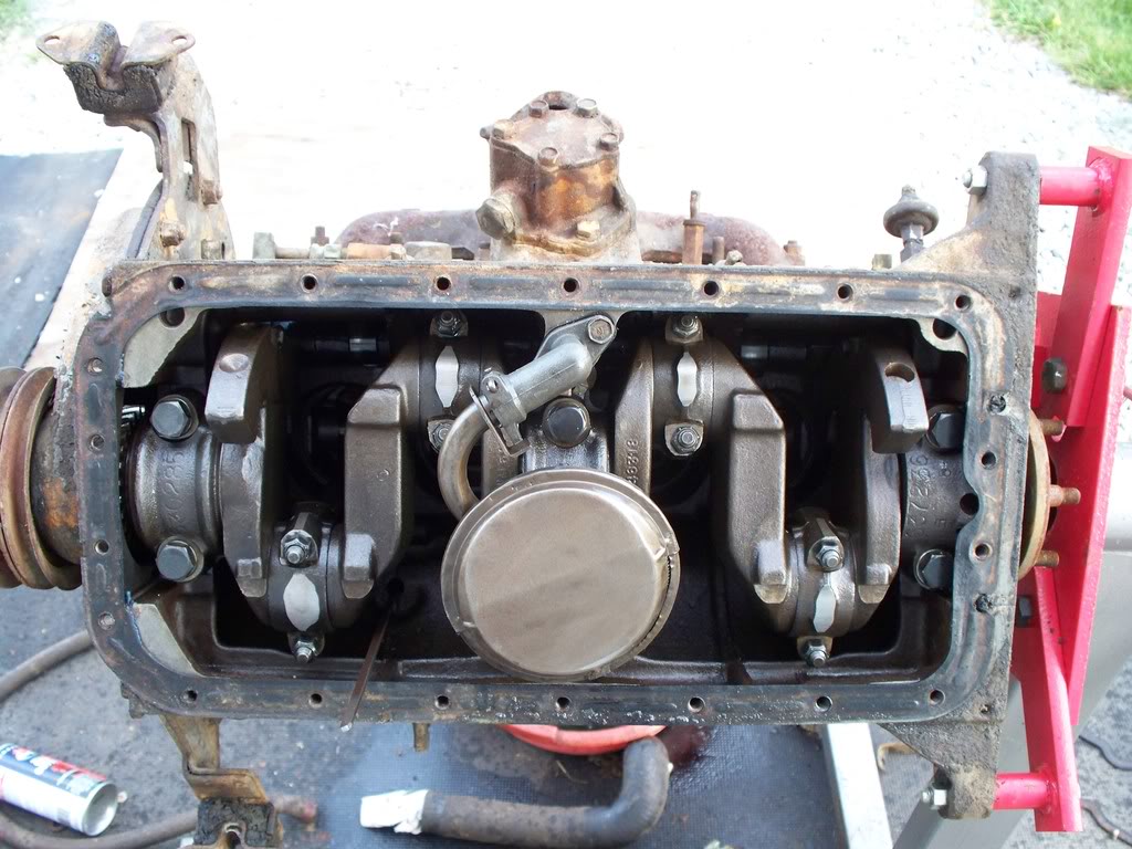

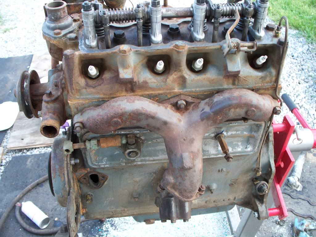

After pulling engine this is what I found

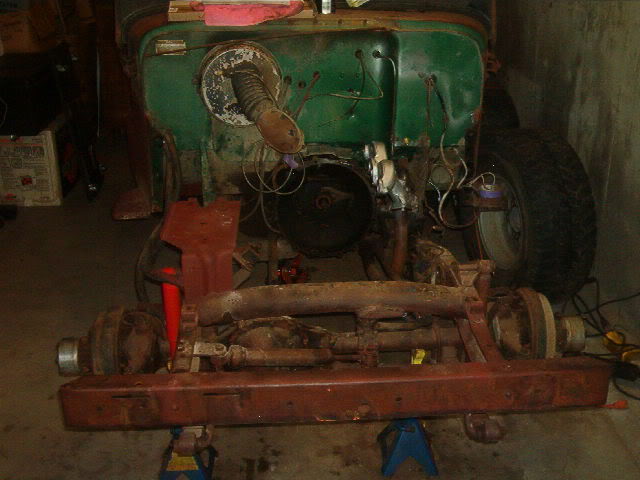

back to tear down

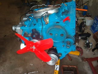

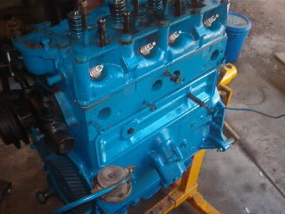

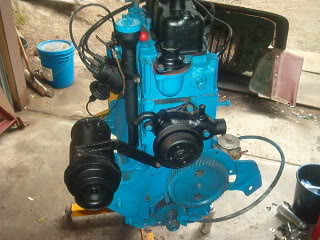

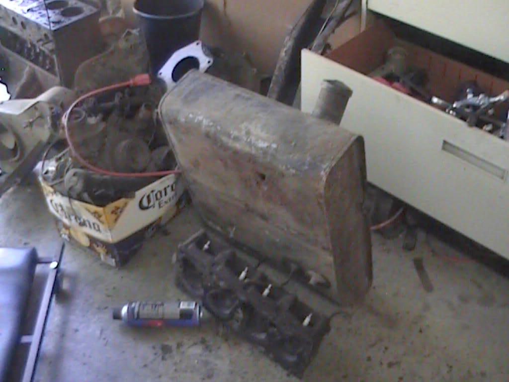

After the tear down I bought a 134 F head and rebuilt it
After building the f head I changed my mind and bought a 4.3 along with a sm465

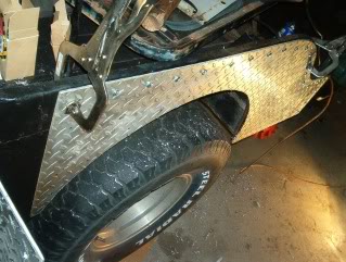

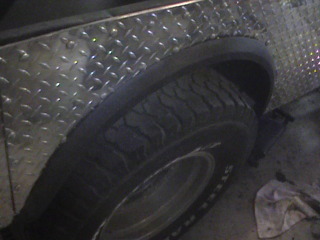

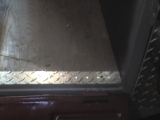

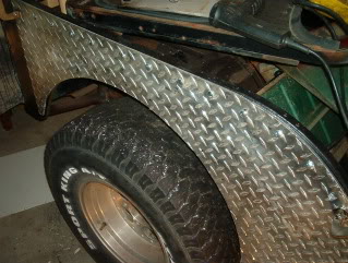

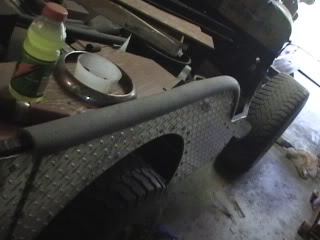

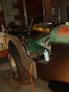

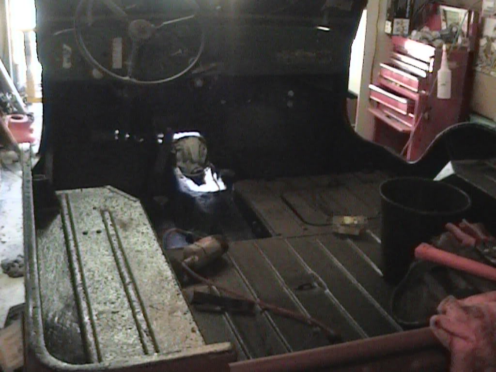

After repairing the body I put a bed liner on the tub before adding 1/4 in alum diamond plate Cutting and bending this stuff was a nightmare After going through 4 grinders 2 saws all and a jig saw I found it cuts like butter using a circular saw with a 12 tooth carbide blade used to cut plywood go figure
Added flairs from a S-10 blazer on rear wheel wells
bed lined whole inside of tub

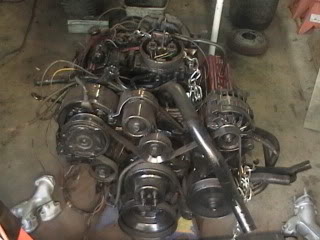

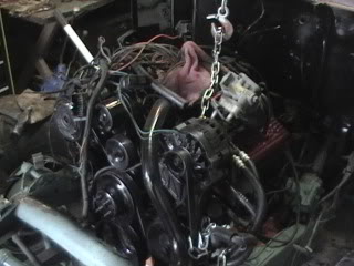

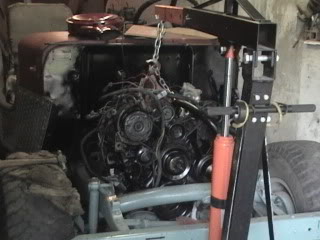

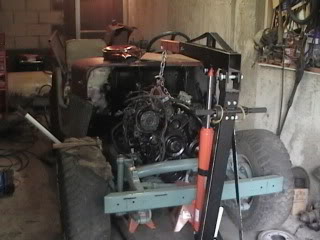

installed 4.3 along with sm465

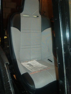

I went with gray seats

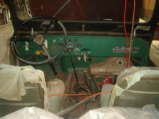

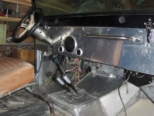

one thing I would do different next time is use the sm420 its not as bulky with the 465 be prepared to cut out the center hump on floor
trans sits about 6 inches above the floor inside jeep
now going to fab up a floor pan like this
Almost forgot with my progress added a wood floor to the rear tub floor

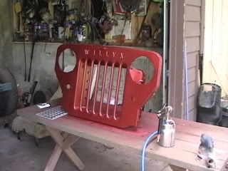

this is the color I'm going with
Burgundy pearl candy

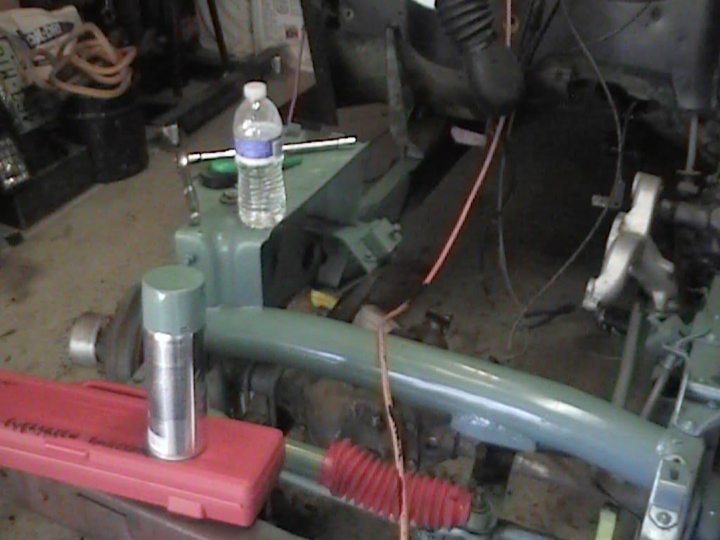

Well between last night and today I finished mounting the seats

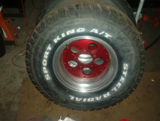

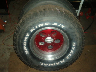

cleaned up wheels and painted them

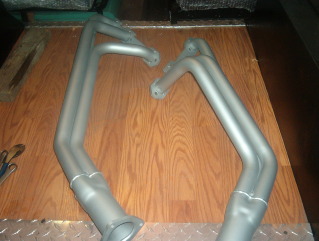

and yes the headers headers came now time to send out to be heat coated

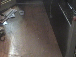

and I see I got a better shot of the floor in tub

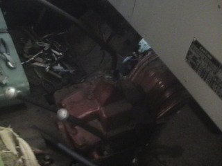

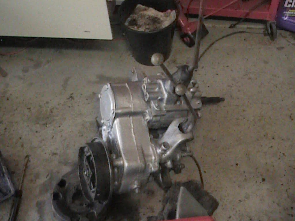

Ok....I see a what I believe is a Spicer 18 (best of my knowledge) with what appears the be a drive line either: 1) brakes or 2) parking brakes. What wuz it for? Did it work well? Is is some sort of "stock" set-up (I've never seen this on an 18)? Is it still laying around your garage?
used the spicier18 transfer case that was beefed up with 20 gears along with the parking brake it was original and sold the T-90
Love the build, but honestly you lost me with the diamond plated sides. If you like them, the do it.

The main reason for the diamond plate is because of all the rock out here and its probably going to be on its side a lot that way it gets the abuse not the tub and always can replace when it gets to the point I cant stand it

The body on that 2a was pretty beat to begin with. I was just saying the diamond plate was not my taste, I personally would have just use aluminum sheet.
For $60. a 4x8 sheet You would use it also lol found it at a recyclers Goes for almost $280. a sheet was going just polished then I got this good deal who am I to say no:D Just a FYI its no picnic cutting it

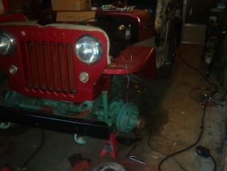

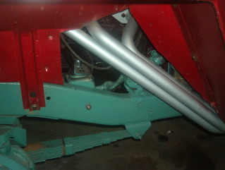

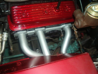

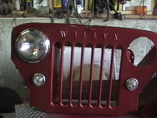

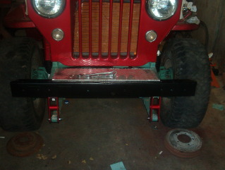

OK headers are back was going to install them when I found out The manifold gasket is the wrong one going to pick up the right ones tomorrow

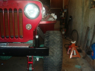

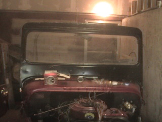

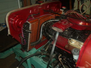

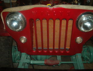

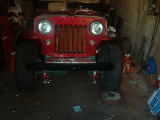

but I got the grill on and radiator installed

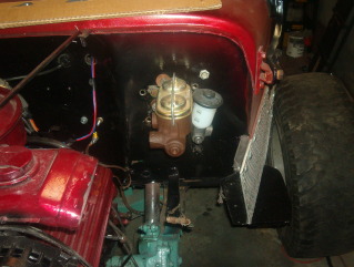

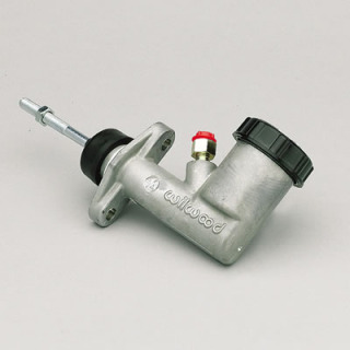

and both brake master cylinder and clutch master cylinder installed today

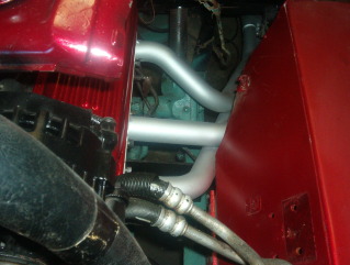

well my new gaskets came so Ill put on headers today and finish wiring

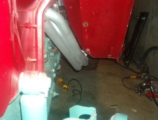

Installed headers today look good , Had to trim inner fender wells also got left fender installed

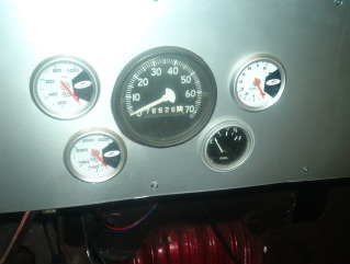

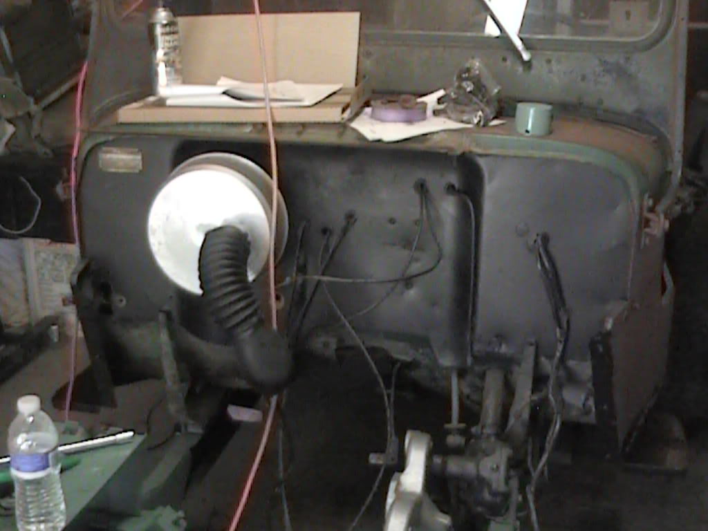

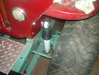

Well today I finished the gauge cluster
Also got front part of the lift in along with new shocks
Now I sit till the back part of my lift shows up next week

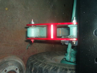

found speedometer cable to be broken today (need to order a new one)
jacked back 1/2 of jeep up placed stands under frame in front of leafs PB all rear leaf hardware getting it ready to tear down and install rear lift busted loose all u bolts via impact gun boy I love this thing placed 2 more stands under axle to support it now a long day to come tomorrow ,
