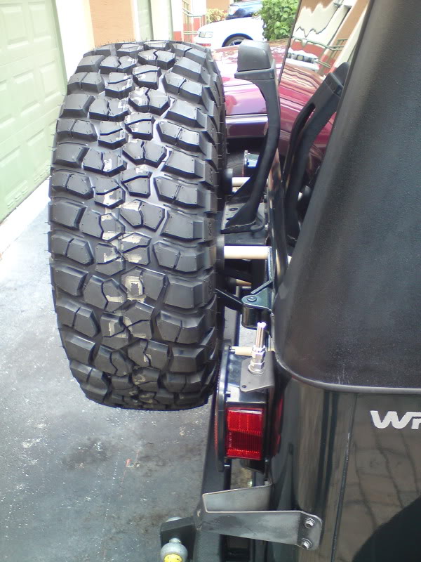

It's not recommended if you like your rear gate. I've seen them start to pull in the course of a couple weeks. Be careful when buying a tire rack make sure that it is rated for that big of a tire. A lot of the racks out there are only rated for a 31" tire. I know it doesn't make a lot of sense, but it's for the pavement pounders out there. [addsig]
