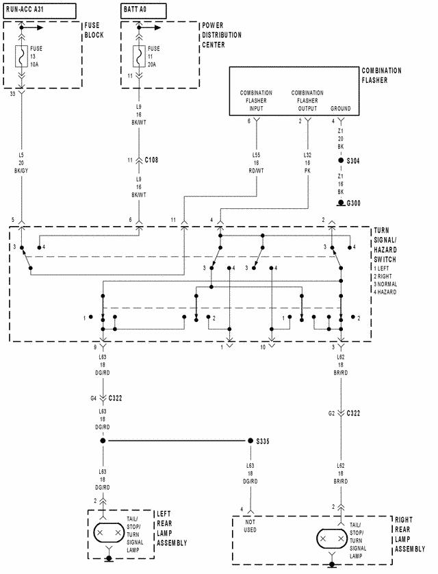

Try to wiggle the hazard switch in the off position, ignition on run position , with right blinker on.IF the symptom changes then the problem is the multifunction switch. typical on jeeps that gets a lot of moisture in the column when the top is off. Replacement of the Multifunction switch is recommended. as far as warranty is concerned, Chrysler Has a 3 Yr/ 36,000 mile warranty. outside of that , if you have an aftermarket or Chrysler extended warranty you would have to check with them if thats covered.
Heres the wiring Diagram. hope this helps.

HhHmmmm! i don't know what i did but i didn't mean for that wiring Diagram to show like that. sorry. let me know if i need to redo it.

MIne did this, because I got water inside the lens and fried my turn signal. Check that.
