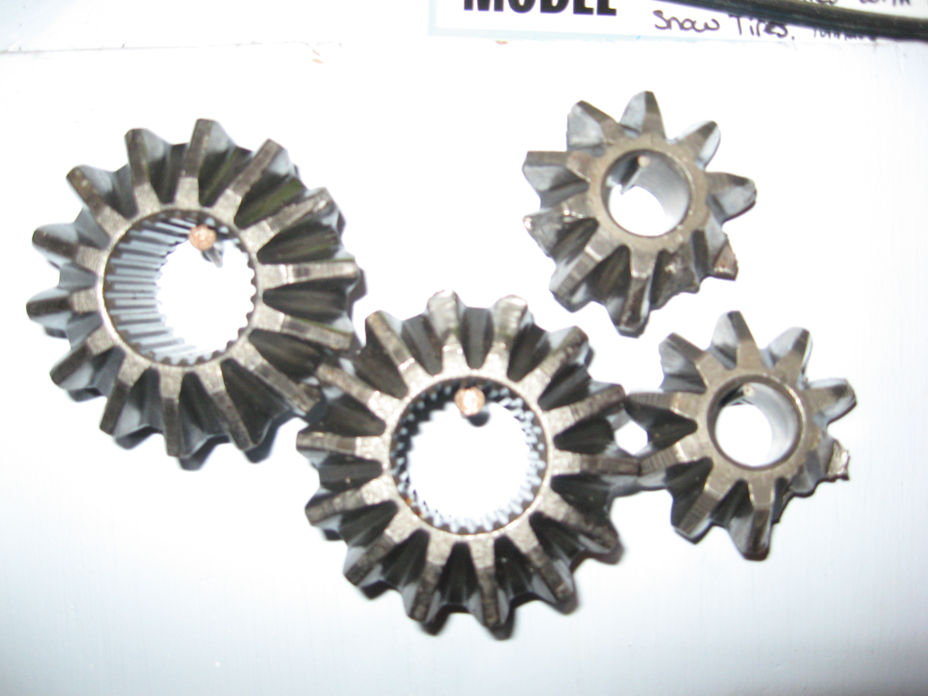

Here are the spider gears out of my dana 30 front end after carnage at Rausch Creek Pennsylvania. Dont go through the "smoothie" mud hold................There are big Rocks in there! Not Cool
with broken parts swim'in in your diff, you'd better INSPECT Everything (ie:Ring/Pinion for knicks and bearings for smooooooth operation!) in there before you shell out ANY money....or the Explorer 8.8 is a good swap I hear.
