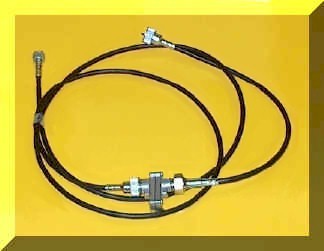

I believe that you have an all steel speedo gear, and they don't make additional sizes with more / less teeth. From what I've read you'll need a ratio adapter. This sits inline with your speedo and changes the ratio - they seem to run $80-$100
