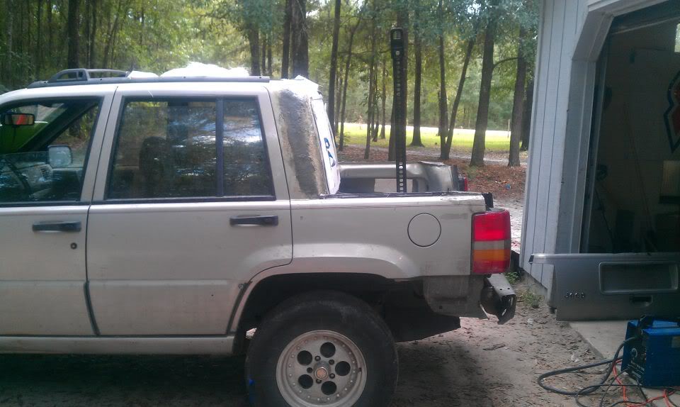

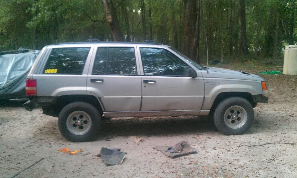

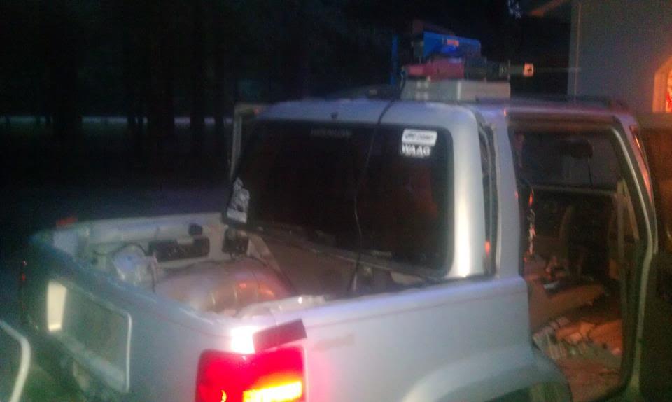

building me a zj pickup. started a week ago and here are the pics of the progress.

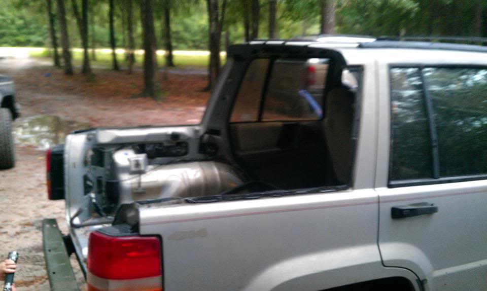

what i started with.. in this pic the interior is removed;;;

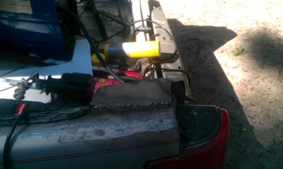

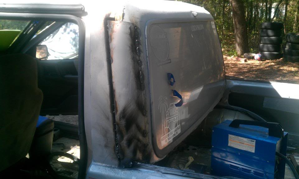

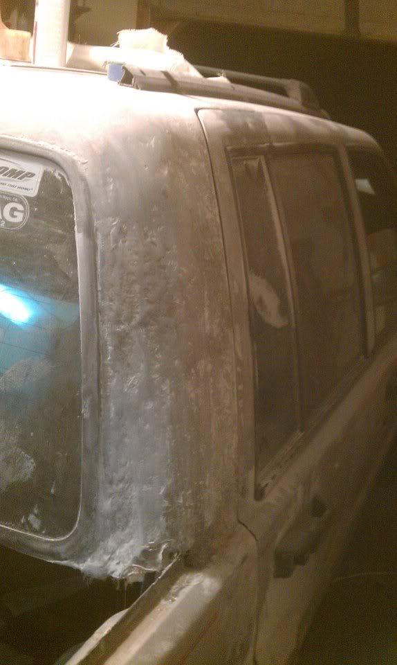

and the chop begins....
the metal work...

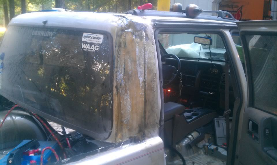

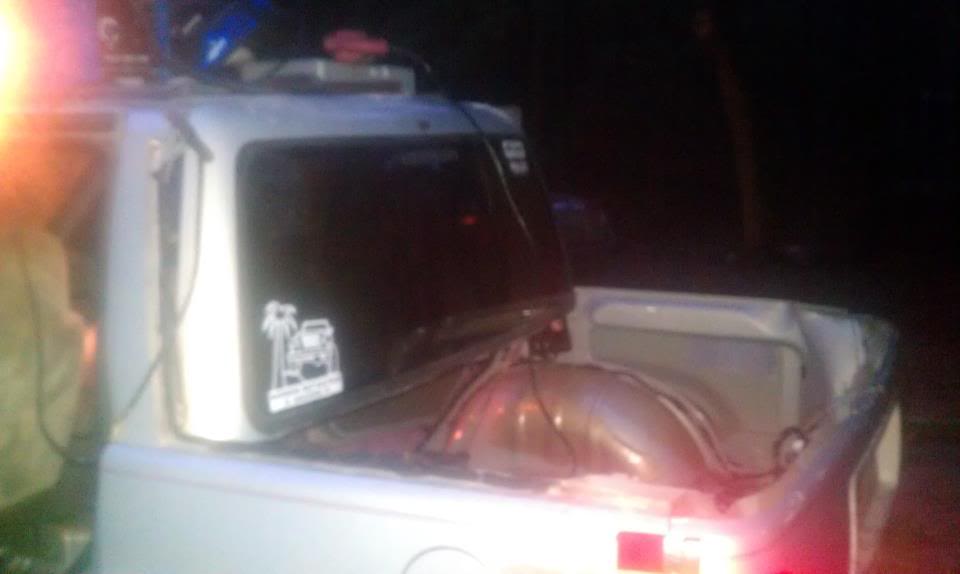

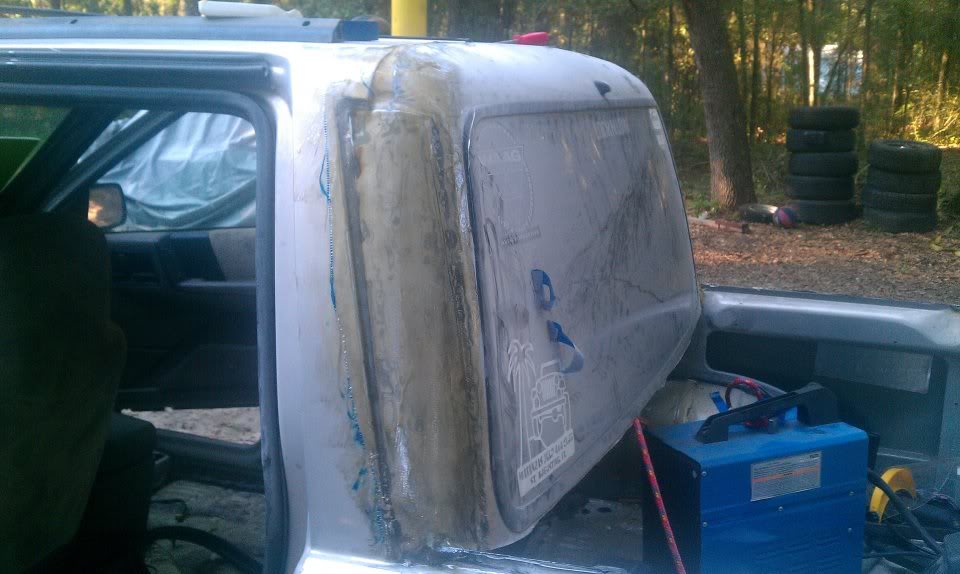

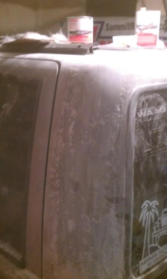

the glass work....

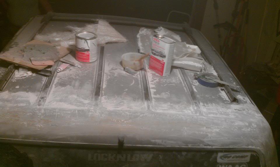

now i need to finish a few more layers of glass then some lite bondo work and it will be prep and paint time .

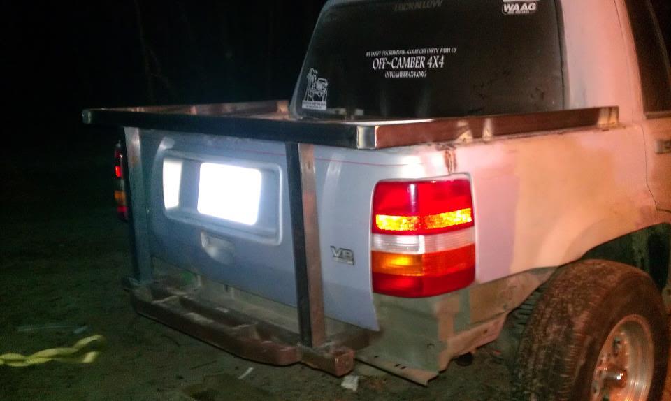

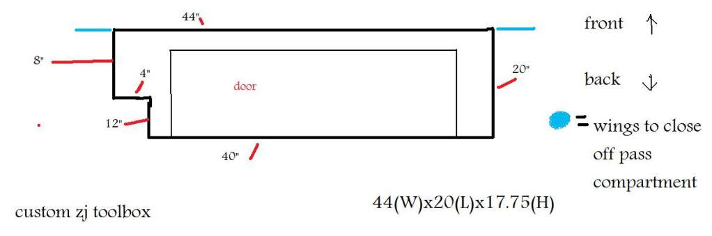

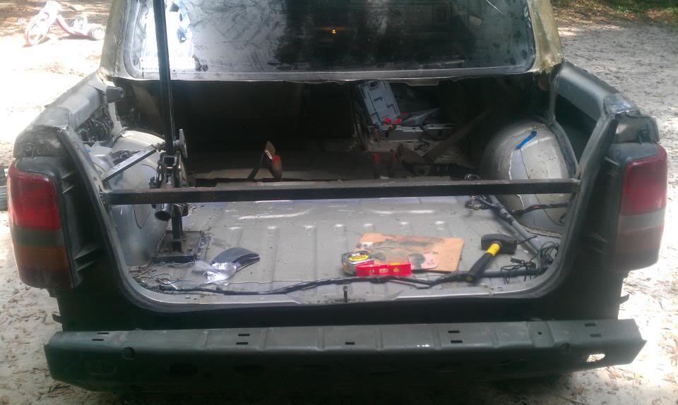

heres the metal and fiberglass work done. the bondo stage is going on now. going to build a toolbox to block off the passenger compartment.
the rear side to side brace
and the toolbox design...this looking down at it...

Looks like it's shaping up nicely. Are you going to put some sort of cage in the back, or reinforce it in some way?
i have a 2x2 solid steel bar to support side to side. but yes oneday it will get a full exocage and partial interior cage.and everything i am doing to it reinforces it, the hatch(backwindow) is welded in,it has the steel bar in back , the toolbox will be part of the structure.

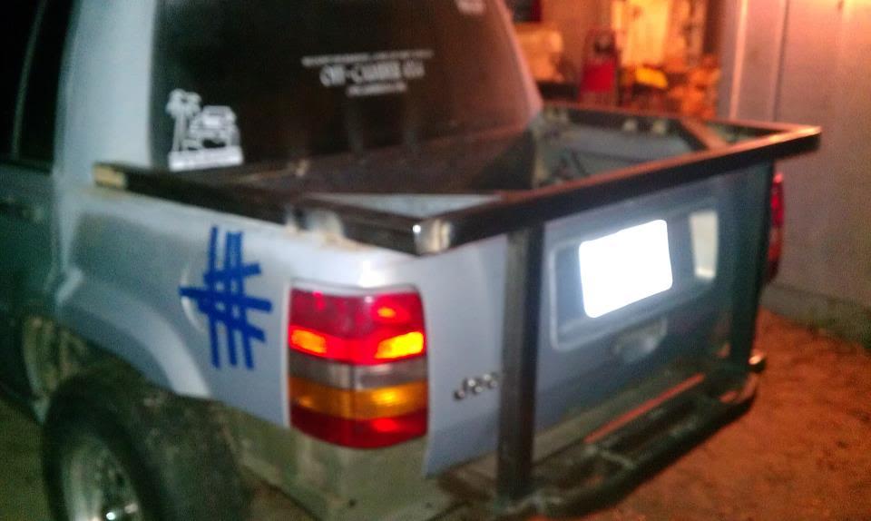

ok i have not had time to do pics. but i have had a bumper started on,i have relocated the fuel tank, and the panels had been reshaped for the future mods that are coming
little update...cage started on...
and what it should look like when done....this is it..all red is not done yet.....
