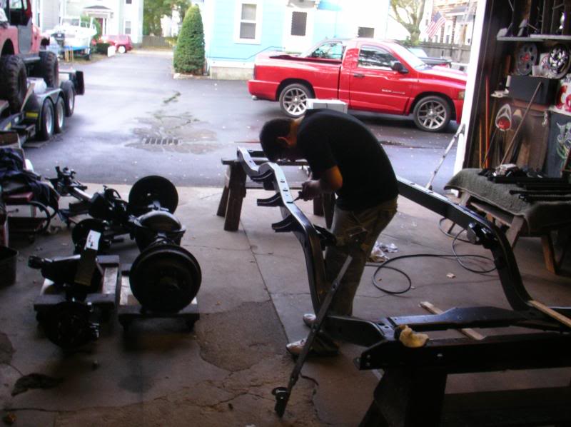

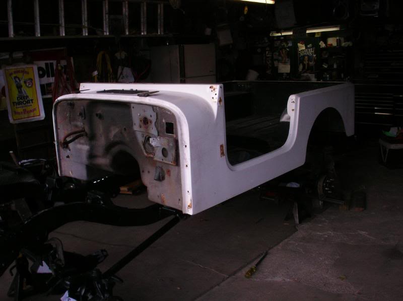

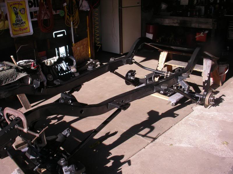

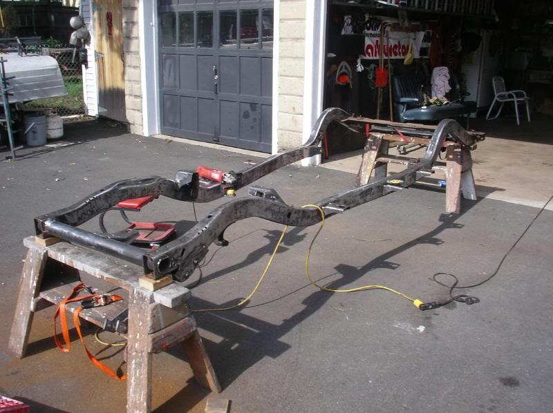

Well, since I am currently doing this...
If you know what your doing, it's not all that hard, we are currently putting a CJ tub on a tj frame. if you think it through, it is just as simple as swapping a yj tub for a cj tub, just need to move a couple body mounts and be done.
Plus, this will get the TJ grill and hood mated to the cj tub.
Here is the photo link HeyzipupyourflyYJ/Project Badass - Photobucket - Video and Image Hosting
couple of shots too
