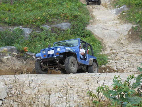

This is a YJ I put a Scout Dana 44 in with 4:10 gears it has a CJ bolt pattern but you can run spacer adapters.We swapped out the Dana 30 front with 3:07s for a Dana 30 with 4:10's.
