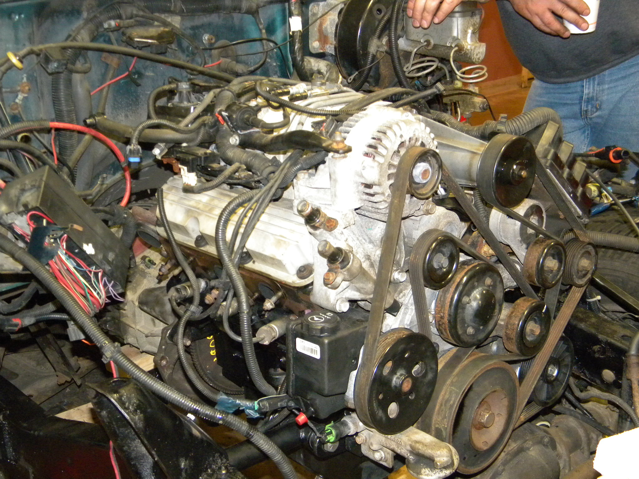

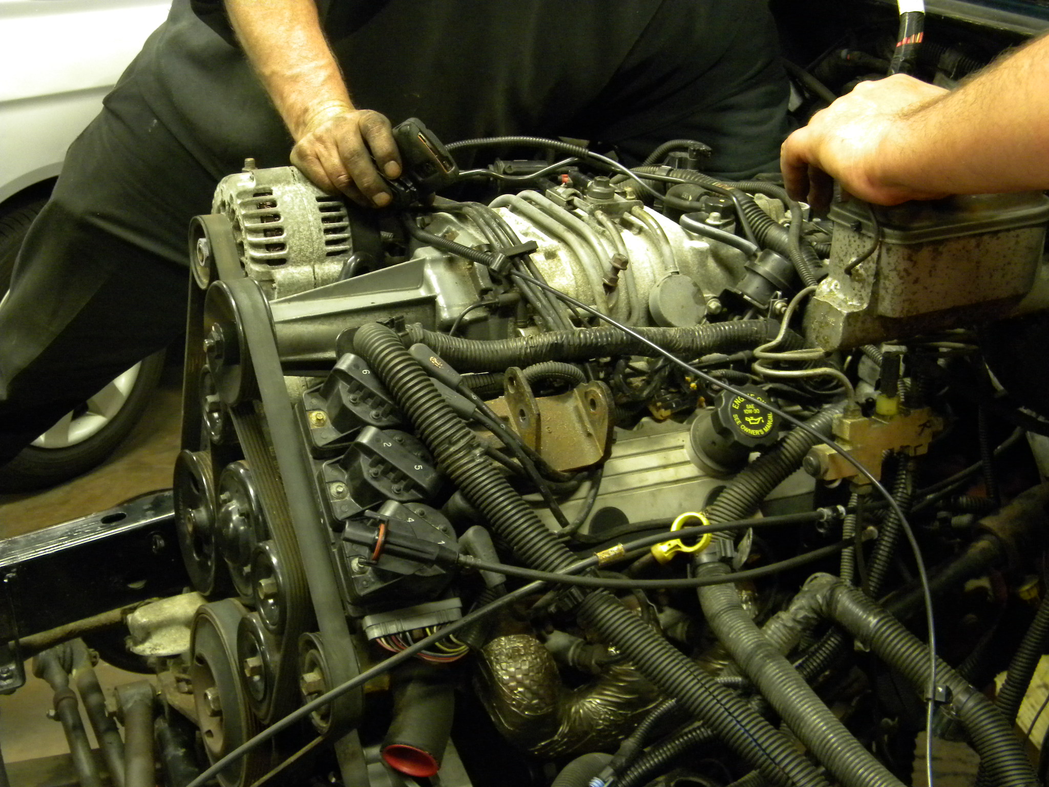

A while back I asked the forums if it was possible to install a supercharged v6 in a wrangler. I got mixed reviews mostly saying it wasn't possible. Even the good people at Novack and Painless Wiring said not recommended.
Well check this out, I bought a 02 Buick Regal 3.8 supercharged engine. With all accesories,wiring harness, and pcm. Although it is not the hardest thing I have ever done, it is challenging. Al Gore would be proud of the emissions upgrade. About a month into the build. I only have a couple hours a few days a week to work on it.
The coolest thing about the whole thing is that I am an automotive instuctor and I am getting paid to do this. There is a lot of fabrication work and time spent planning. Keeping the stock 5 speed for now. It bolted right up. 4:10 in both diffs and 31" tires.
I will post more pics as we progress. Heres another thought... has anyone ever installed a Northstar in a Jeep before.

The L67 SC3800 is a great motor, the gen II blocks (which you have) is an awesome motor, and is a fairly commmon swap into jeeps. In one of my local club we have a SC3800 equip XJ and a RCROCS buggy with a rear mounted SC3800.
If your looking for some contacts for setting up the motor and tuning it, let me know, I got some.
What are those guys running for transmissions. Is there any pictures of shifter set ups I can Look at and get some ideas. Also how did they configure exhaust, I tried 3 different ways and ended up buying camaro headers and modifing them to fit in. I could use some people to talk too as far as tuning so I would appreciate your input. Where are you out of I am in the great tax state of CT. Thanks
