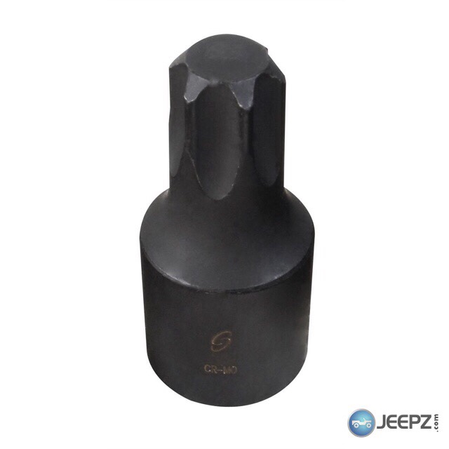

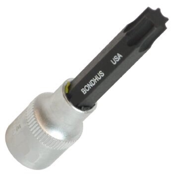

Well the trick i used is be sure to use a sharp bit. Clean the corners of the bolt for full bit insertion. Put the bit in and heat the bolt thru the bit, so not to burn the paint. And use a impact driver. Soak with PB blaster.
This
NOT This
