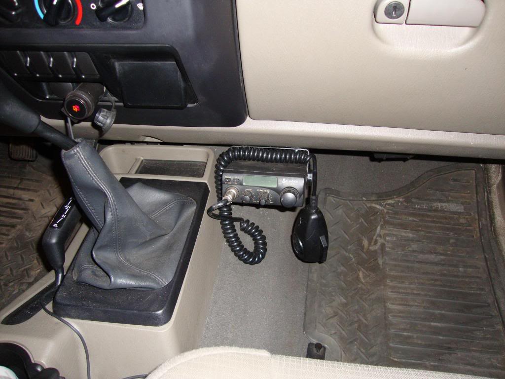

I placed mine below the glove box tucked back in the corner by the trans hump on the passenger side. There is a metal lip under the plastic molding that gives you a great place to tap some screws into, and no one whos ridden there has had an issue with clearance..

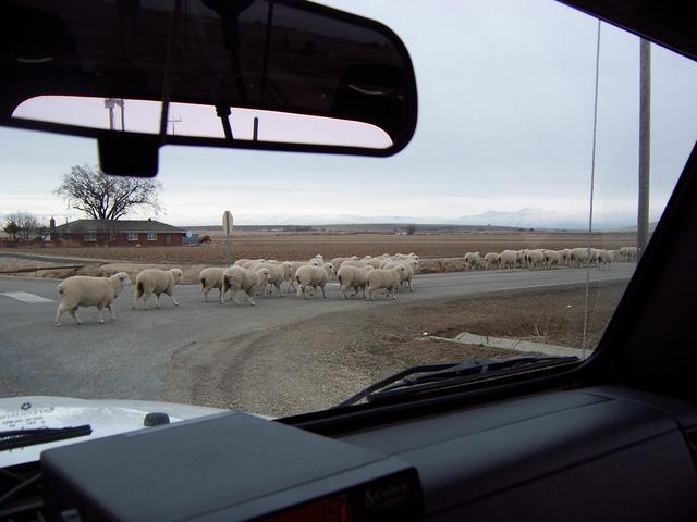

I'll try to find some pics but I had mine mounted right on top of the dash in the coin tray. It may sound tacky but it worked perfect for my little Cobra 19 (The uniden would fit perfect also).
I removed the rubber mat and used some washers to mount the bracket then ran the wires between the dash and windshield.
If you look close in these pictures you can see it right in the middle of windshield.
i put mine in the same place..
