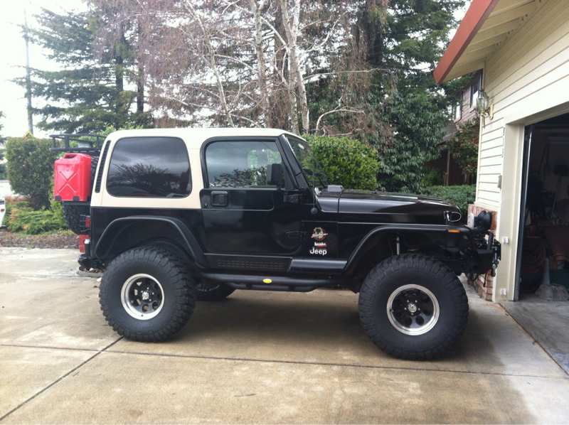

My mechanic who's built 150+ Hemi jeeps installed 4.88's in my 2000 TJ. 35" B.F. Goodrich M/T KM2. Check out the gallery at www.jeepspeedshop.com
