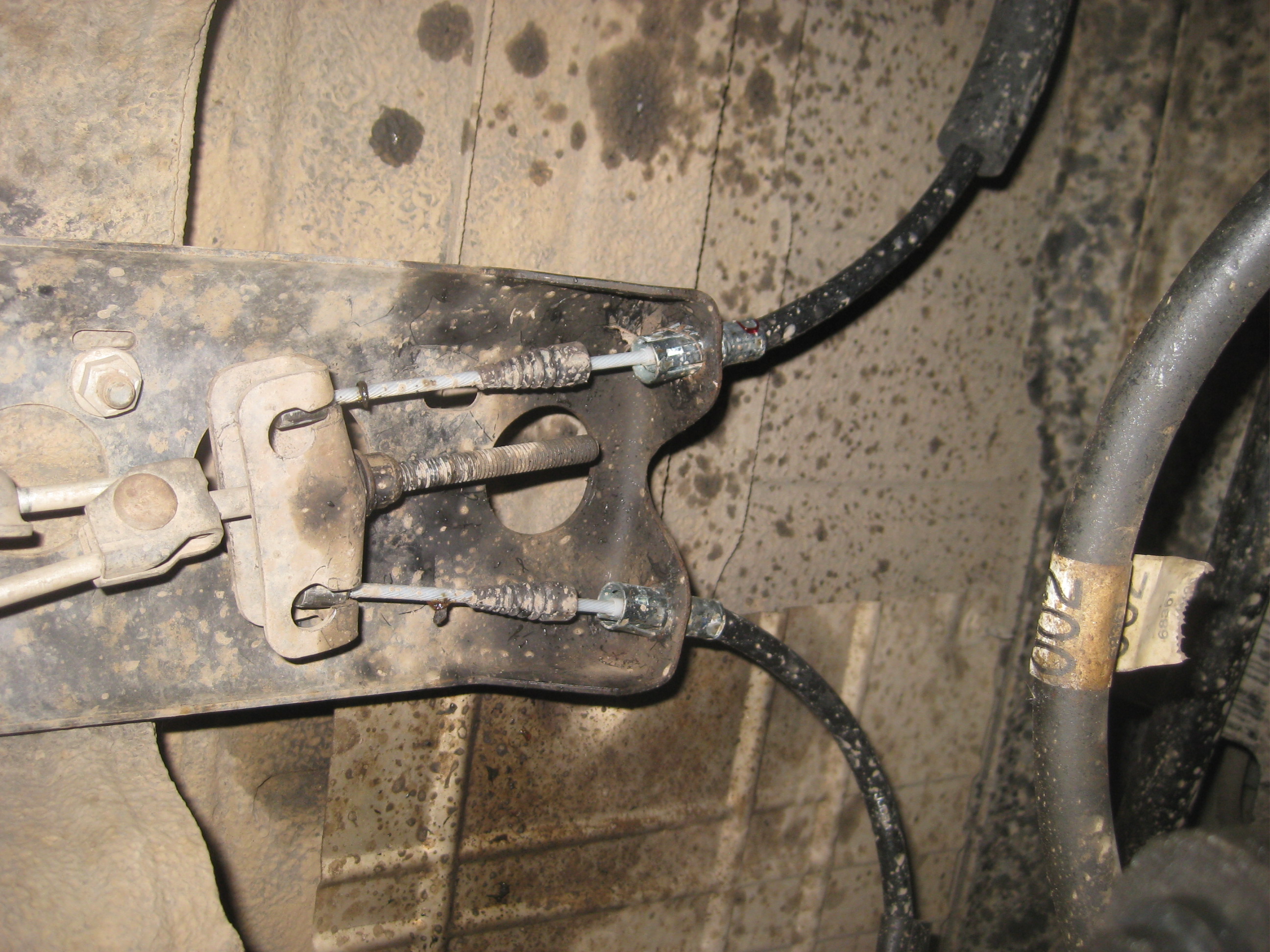

jps4jeep said:why no parking brake?
if you have the stock rear 8.8 explorer calipers, you will need a new jeep adjuster, and some 95-98 ZJ rear Park Brake cable.
I got new parking brake cables with the axle. And what do you mean jeep adjuster?
xjmarc said:I have line locks for front and rear. Work great.
yes the line adjuster drivers side frame rail, right about under the drivers seat, maybe a little farther back, you can only get it from Jeep.
I typed jeep because your axle is from a ford, I didn't want you to think it was a ford part.
