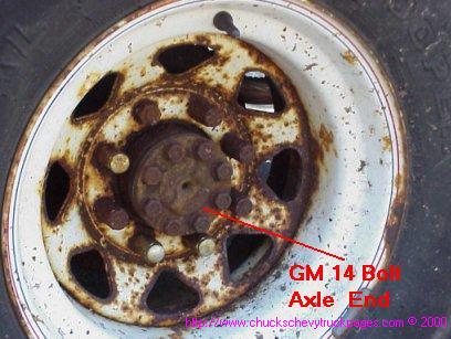

A full float axle has a wheel hub and spindle (like a front axle that doesn't steer)at the end of the axle tube, whereas a semi-float has a bearing pressed on the axle shaft itself. The full float supports the weight of the vehicle on inner and outer hub bearings riding on the spindle. The semi supports all the weight on a single bearing on the axle shaft. Full float takes a lot of stress off the axle shaft.
Easily identified by the axle bolts at the hub:

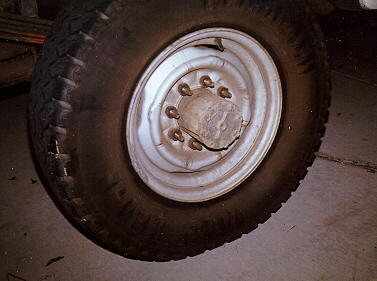

A full floater has the axle mounted to the brake drum or rotor and you can take the axle out with the wheel off because the axle rides on the diff and drum/rotor hence the name full floater. Where as a semi floater is just like normal.
Here is a full floater.
Here is a semi floater.
Hope you have a better idea now.;)

Full float 60s will have an axel flange with 8 bolts holding it to the axel. It will stick out from the rotor (or drum) about 3 in.
A full floater has the axle mounted to the HUB and you can take the axle out with the wheel ON because the axle rides on the diff and HUB hence the name full floater. Where as a semi floater is just like normal.
Fixed the terminology for you.
Note: you can also completely remove an axleshaft from a full floater, stuff a rag in the hole and continue on in 3WD.
