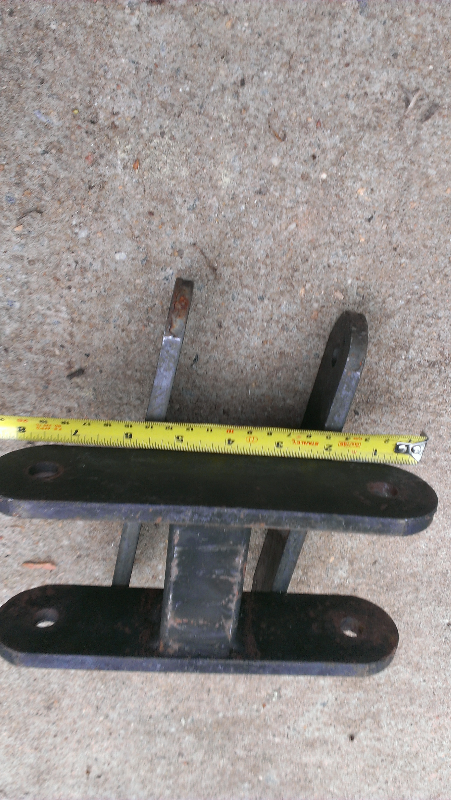

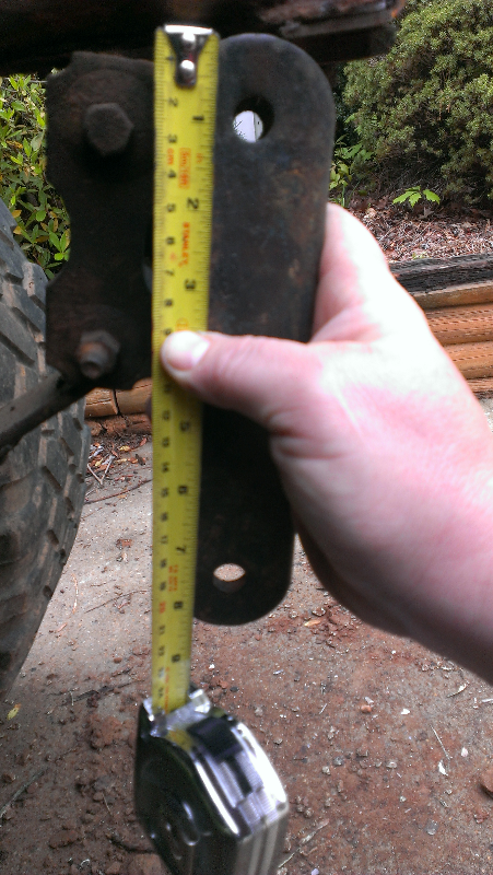

I almost jumped in way to far. After measuring the new shackles it will give me around 3" alone so if In did a SOA it would be way more lift than In wanted. If I'm not mistaken early in the thread it said you get around 4" from soa.
Shackles lift half the difference in height from the original shackles, as they only lift one end of the spring. A small shackle lift isn't bad but those are in the booty-fab range. Ridiculously long shackles decrease approach angle (they hit everything), alter the pinion angle, and decrease caster (increasing wander).
With SOA you gain 4 to 4.5" The measurement pics show hole to hole to be about 6.5" Your factory shackles will be 4" hole to hole, so you will get around 1.25" of lift from those shackles.
