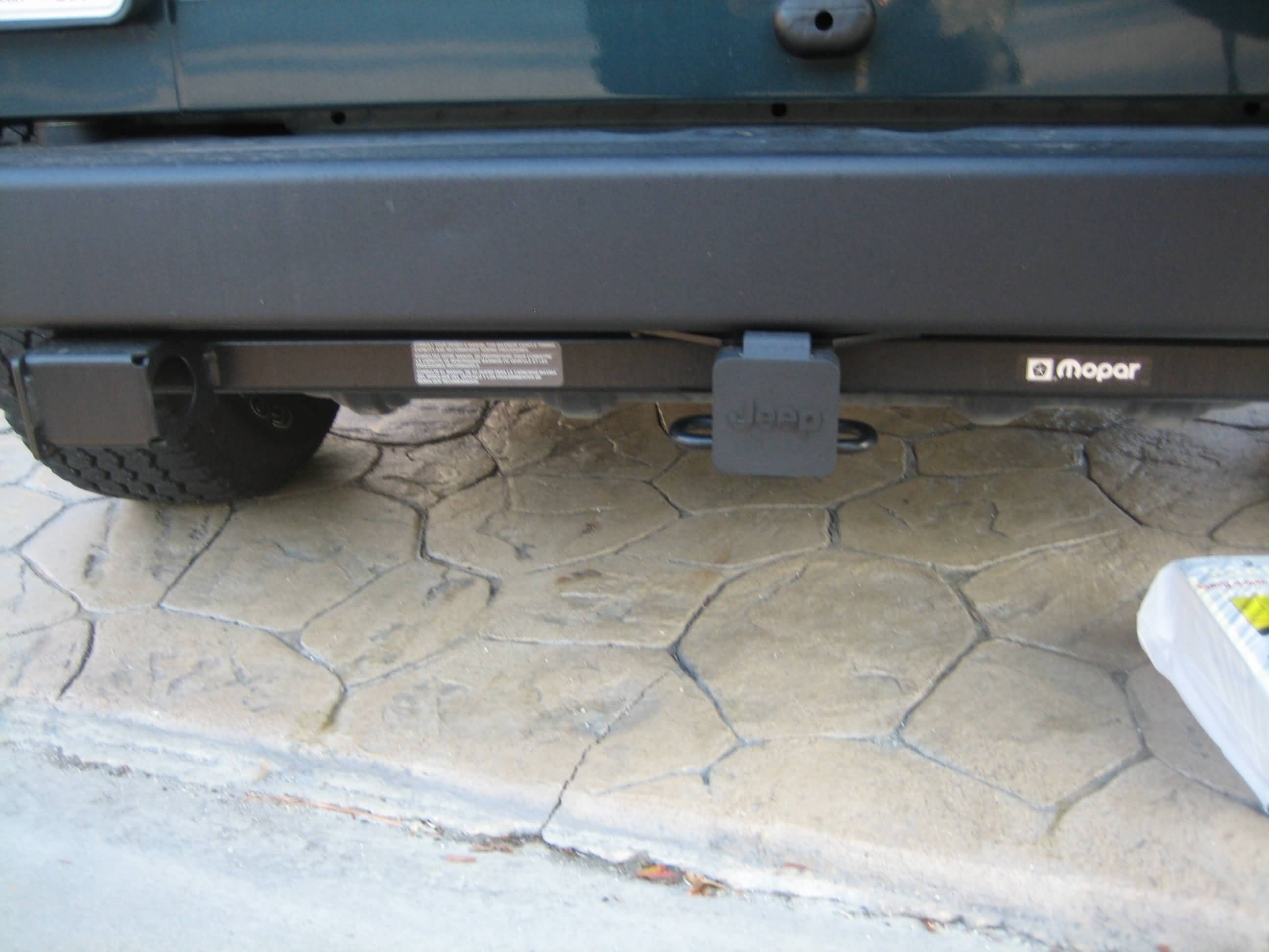

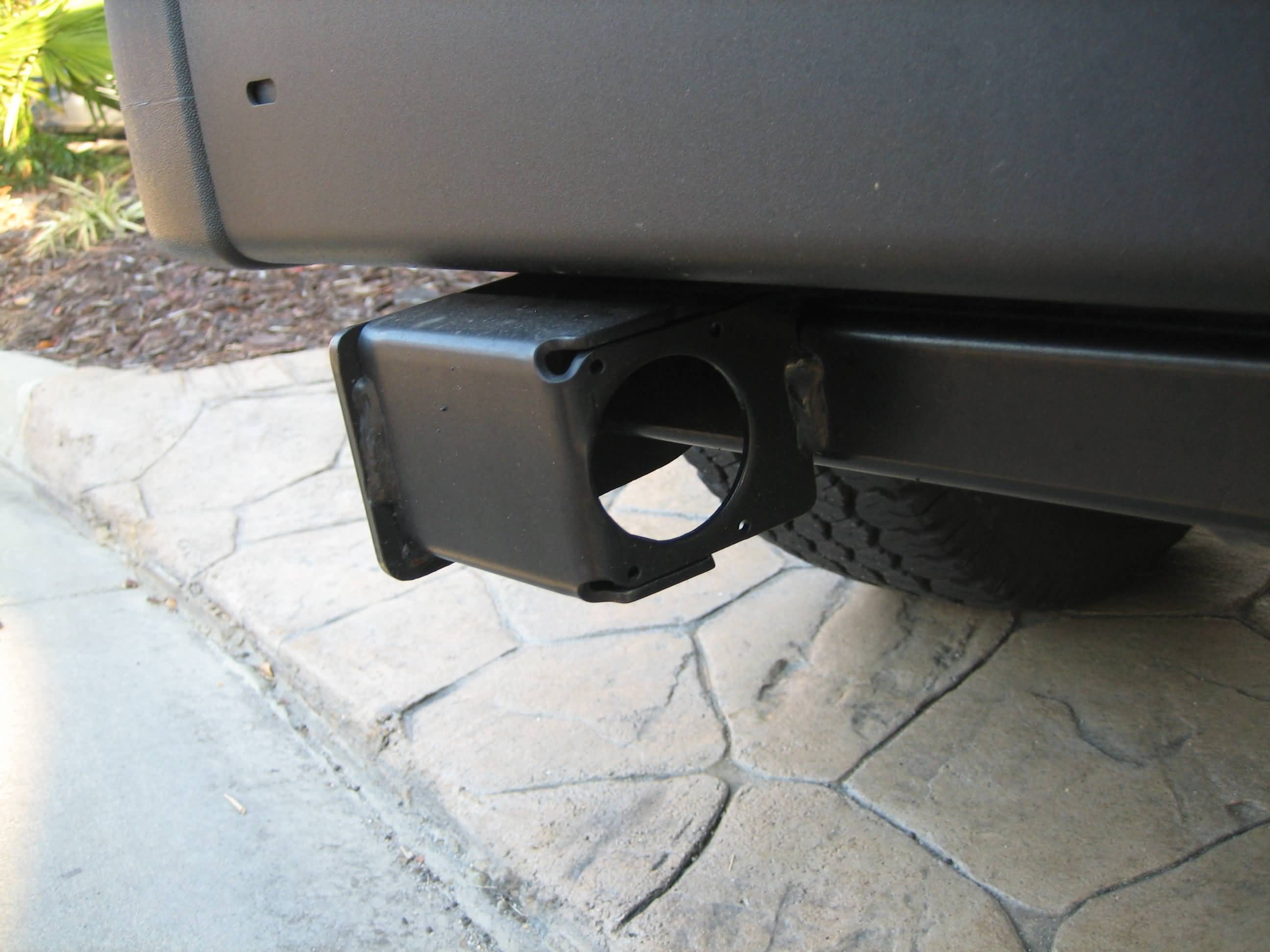

I've got what appears to be a stock mopar tow hitch, and would like to wire it up. I'm looking for input on what wiring harness to buy. The tow bar looks as if the wiring plug should be mountd in the circle (see the photo).

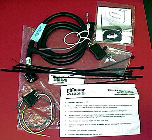

After some research, it appears that I can get a round 7 pin switch, or a flat 4 pin one.
I'm not really sure what the difference is, but I'm tempted to get this 4 pin one
That looks about right. I'd like to be able to mount the recepticle in that rount hole on my tow hitch. I'll hit auto zone on the way home tonight.

You will want 7pin round if it is to fit that box, then you'll need an adapter for 4flat (the most common trailer harness for light duty).
If you get the 4-flat plug in connector from Jeep make sure you get the one for 04 - 06 TJs. I innocently went to the parts counter and got a plug in harness for my 06 and the spent the better part of a day trying to figure out why my LR tail light and brake light wouldn't work. After doing some searching on several forums it turns out that I had a harness made for 03 and earlier, which is different...
